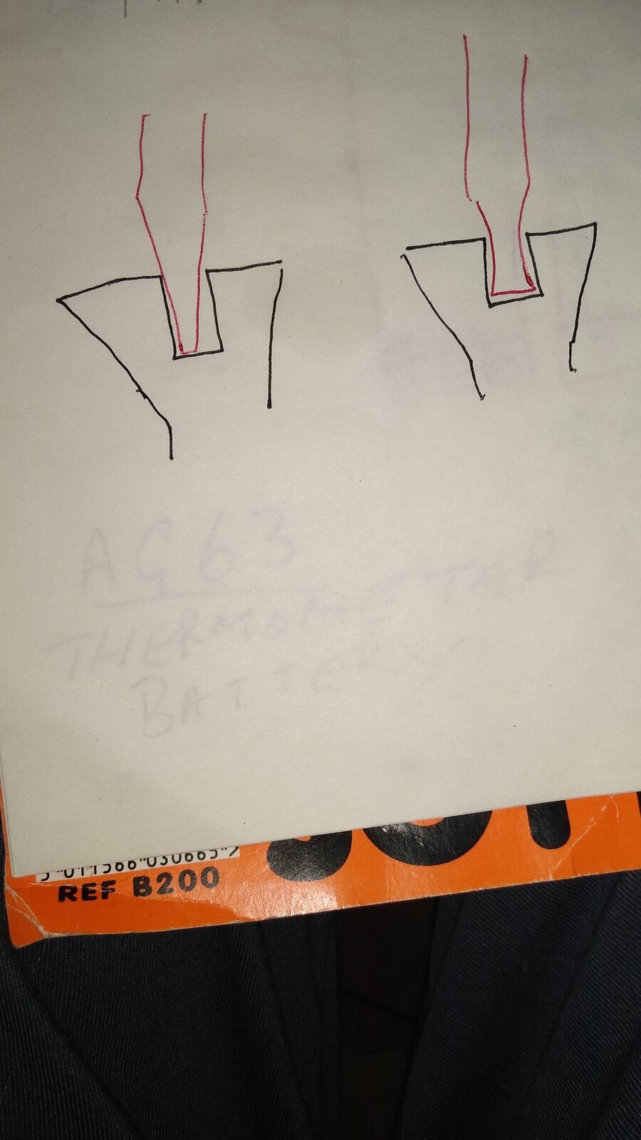

It also helps if the end is ground parrall or slightly hollow ground so it bites lower in the slot instead of like a chisel which cams out.
I regrind various size bits hollow for brass screws and carb jets which are more prone to damage
