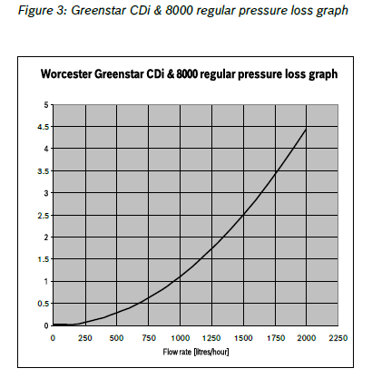

WB sent me this a few months ago.
What output boiler is this based on?, most boiler rated flowrates are based on a dT (flow/return) of 20C so a 40kw boiler above will flow 1720LPH (28.7LPM) at pressure loss of ~ 3.3M, not too bad as it leaves around 3M to circulate through the system,, problems will arise if you require to run the rads at a lower dT, in this case a LLH probably required if the rad output is is 40kw.

I have read an old article stating the purpose of the low loss header is to allow large volumes of flow through the radiators when the boiler heat exchanger is too small to handle that flow and would present a bottleneck.
Mostly. The heat exchangers on modern boilers are a lot more restrictive than on earlier generations. So, it can take an awful lot of pump power to force a high flow rate through them. See graph above. This means that with a very large system, the central heating pump has used much of its power just pushing the water through the heat exchanger and there is sometimes not enough power left to circulate the water effectively through all the radiators. One way around this is to use a LLH in conjunction with an additional pump. On one side of the LLH one of the pumps is used just to send the water through the boiler. Then on the other side of the LLH, the other pump is used to send the water around the radiators etc. Or you can use one very powerful pump instead.

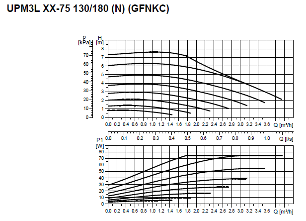

A heat only boiler is more forgiving as you can install a more powerfull pump than in the system boiler and reduce the LLH requirement.
I think this might be the pump used on the combi and system versions of this boiler. Quite a beast?
