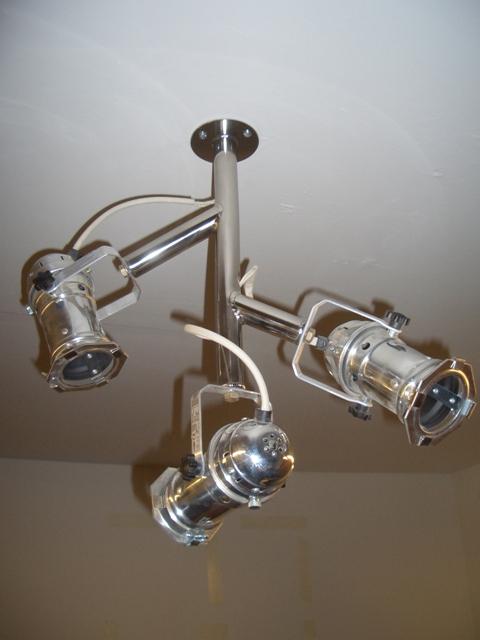

HELP! I'm trying to run 3 x 35w 12v from a transformer (250va) which I've metered and is telling me it's 12v on the output. I've also metered the individual light housings which are all 12v. Cuh........ so can anyone tell why every time I connect a halogen, it blows immediately. I know I've obivoulsy done something wrong but can't see what! :confused:

picture?
Picture info is in forum information

what exactly happens when you try to connect any light?
from what you have said so far there is a short, have you a multi meter?
Thanks. I've made up 2 of them for a piano showroom. Thought they would light up the inside of the grands nicely. That is ....... if they worked.
Glows bright and pops all within a nanosecond. I have tested all 3 units with a meter and it reads 12v on each.

Are the birdies second hand?
Does this happen with every single fitting, or just certain ones?

since you made it, take one light fitting out and try it.

The birdies as brand new. Tried halogens on 2 of the birdies, haven't tried the 3rd. The stem which I made carries no electrical current. Only the wires travel up through the main stem all soldered and covered with heat shrink. Ok, nanosecond is maybe a bit quick but certainly no more than half a second. I have a friend (a sparky) who is on holiday for 2 weeks, but really wanted to sort this meself. So I will get it checked out by a qualified electrician when he gets back. But.... it is or should be as simple as wiring a plug.. I would have thought. Thanks for all the replies.
AFAIK the only way (apart from physical abuse) to make a lamp rated at X volts burn out almost instantaneously is to connect it to a supply which is significantly more than X volts...
