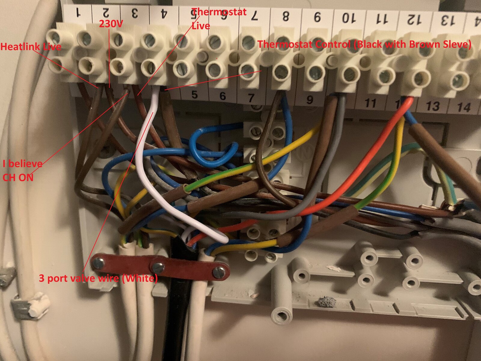

I know there are plenty of threads about this but I still can’t seem to hit this one on the head. I had an LP522 in place in my new house and am trying to hook up a new Nest to it
I have a swapped out the cables as per all instructions
LP522 L - Heatlink L
LP522 N - Heatlink N
LP522 1 - Heatlink 4 (hot water off)
LP522 2 no cable
LP522 3 - Heatlink 6 (hot water on)
LP522 4 - Heatlink 3 (Heating on)
The thermostat downstairs I have disconnected, added the nest (no neutral) and connected the T1 and T2 to the wiring nest on 3 and 4 (3 contains the link to the thermostat and what looks like a link back to the heatlink - possibly CH On - 4 contains both the links to the thermostat link and to the 3 way motorised valve)
I’ve also tried the stat not wired in and just wireless with the old one wired up and set to full.
what I can’t get to work is the hot water. No matter what I try the relay doesn’t seem to click over. It has in the past.

Forgot to mention that 2 and 5 on the heatlink are looped into L on the heatlink too

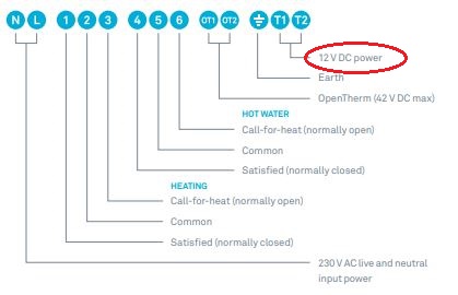

your post is so confusing , T1 and T2 are 12V connections to the nest thermostat to save you using a USB cable to power it, they dont control anything on the heat link they are simply a power supply ?
Sorry for the confusion.. I think I’ve got myself confused in the process!!
So am I right in thinking that T1 and T2 can just run to the thermostat just powering it from the heatlink?
yes that is what those terminals are for
If I take it out of the wiring nest there will be a white wire from the 3 port motorised valve that isn’t connected to anything.
That is the CH on wire and must be connected to 3 on the heatlink

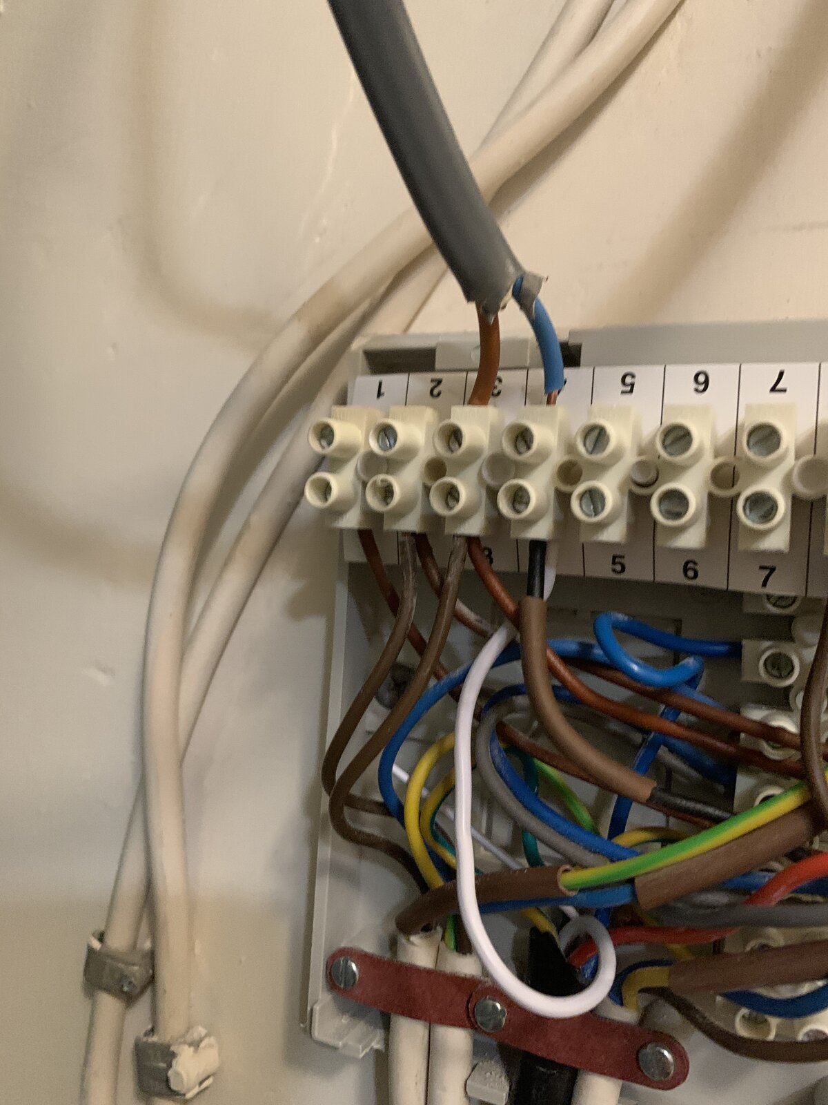

The other end is into the heatlink (the image of the old Drayton programmer)
the 2nd image of the wiring nest shows port 3 which I THINK is the CH on (which is connected to the heatlink which is what I’m confused about) and the link to the current stat.

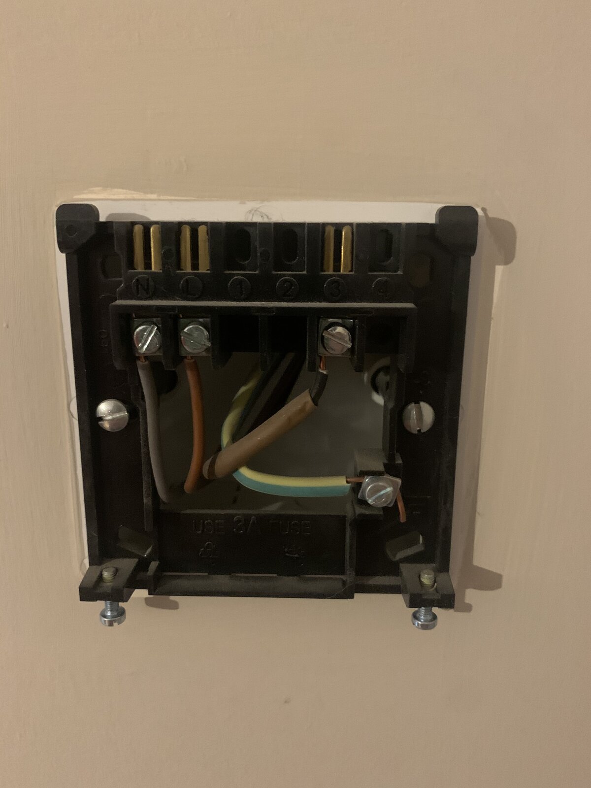

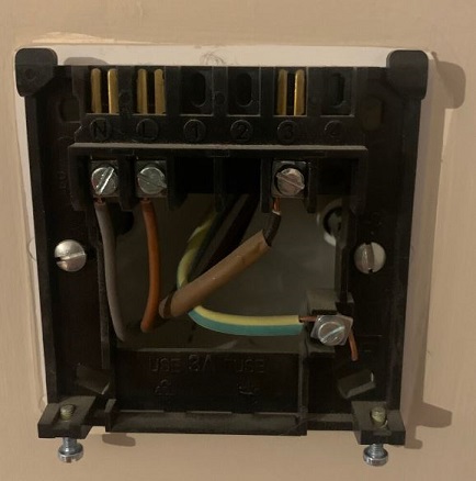

If you mean this:
It can't just be disconnected, the grey neutral should be isolated, but the two live wires [brown and black/brown sleeve] should be connected together to complete the circuit, it can be done at this end of the cable, or at their origin in which case the cable can be completely disconnected. Having said that, this wouldn't effect the operation of the hot water, only the central heating.
This worries me more. If I understand correctly what you are saying here, you have connected the T1 & T2 12v terminals to terminals connected to 230V. If so, the Heat link could well be toast
T1 & T2 as per @ianmcd is provided to power the thermostat.

The other thing that im not too sure on is this.. In the diagram
If I remove the Thermostat Live and Thermostat Control (3 and 4 which go downstairs to the stat) and connect them into the T1 and T2 of the heatlink, that leaves the CH on and 3 port valve wire (white) not connected to anything?

From your photo, you have identified the two thermostat live wires as going to wiring centre terminals 3 and 4. So these two thermostat wires are removed from terminals 3 & 4 and a link inserted to join terminal 3 and 4 together to complete the circuit. [or instead simply put the remaining two wires 'CH On' and the Motorised valve white wire into the same terminal either 3 or 4] You are bridging the thermostat at the origin of the cable.
Which is what I was said earler...
The end result will be that the wire from Heat link terminal 3 (Heating call for heat) will be connected to the white wire of the motorised valve.
The neutral wire contained in the same cable can just be disconnected. You will now have a cable that is completely disconnected from any of the mains wiring and can be used to connect T1 at the Heat link to T1 of the thermostat, and T2 at the Heat link to T2 of the thermostat.
