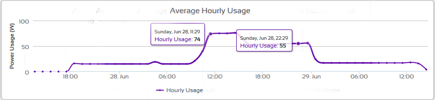

This was charge for a caravan leisure battery 75 Ah
To start with it had a 7 Ah in parallel as it was too flat to charge, see bump before 06:00 where it was removed, it was like flicking a switch when it did start charging, and by 29 Jun it was nearly fully charged and just after 12:00 it dropped to 0.1 amp, it continued at 0.1 amp and today voltage has risen to 13.4 volt and charger on motor cycle mode, I will guess it would in fullness of time hit 14.4 volts when it will switch off, but over a week and still not fully charged.

The computer display goes from 0 - 100 watt to 0 - 20 watt as the output of the charger drops, and the graph would be a very long straight line if continued, so I did not bother with screen shots once down to 0.1 amp or 2 watt input, it only shows in 1 watt increments so the 2 watt becomes 3 watt as the voltage rises, it seems looking at the graph that it is switching between 2 and 3 watt, but that is not really happening it is just the energy monitor can't show 2.5 watt.
What I found with a sulphated battery the voltage will exceed 15 so it switches off, so the 7 Ah in parallel not only raises voltage to over 7.3 volts to charge as 12 volt battery but stops it going over 15 volt which happens when you remove the battery lead and should turn charger off. The larger battery once it starts taking a little charge the parallel battery can be removed, but with smaller batteries it goes over the 15 volt threshold.
