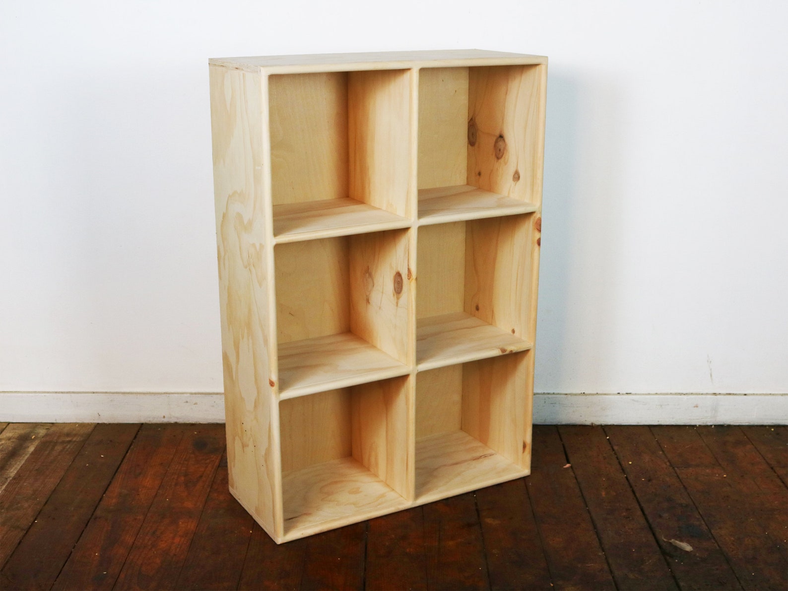

Guys, I'm quite keen to make my own vinyl storage unit, something along the lines of the Ikea Kallax idea, so essentially three 'cubes' wide by two height.
Essentially build a rectangular frame being about 700mm in height, 900/1000mm wide, split in half horizontally, then vertically a few times.
What I'm struggling with:
1. How to join bits of wood which are less than say 35cm wide for the frame.
...Dowels seems like something I'd perhaps mess up - I have a decent amount of space to work, but all hand held tools, and I believe accuracy would be paramount for dowels (perhaps I'm wrong!)
...support battens in each corner being say 20mm wide - a lot easier, but way uglier
2. The best way to do the divisions for maximum strength - for those who don't know vinyl is bloody heavy - with the Kallax you'd be looking to put around 18kg in each cube - so this unit I'm building would need to support about 50kg on each level
I think critical to all of this is the sort of wood I use really - using solid wood that's over 30cm wide seems tricky to find - most places seem to go by thinner bits you'd need to join - I was looking at say pine or spruce.
Attached is the end result I'd want - not precious about it looking exactly like that pic, just to give you an idea (oh and that;s about £400!)

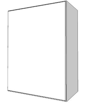

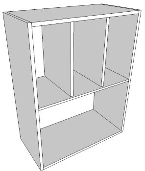

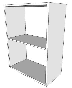

I'll give you a very basic structure in MDF which can be painted. Construction is by screws alone, which are countersunk and filled before painting, or dowels or biscuits.
Basic structure is something like:
Sides 18mm MDF cut to size 900mm x 350mm 2 no
Shelf, top, bottom 18mm MDF cut to size 664mm x 350mm 3 no

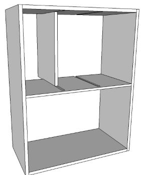

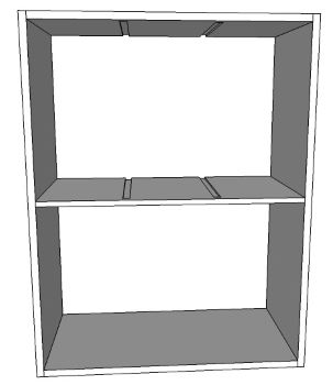

The dividers then go in between the top and middle/bottom and middle shelves. If you have access to a router these could be pushed into stopped grooves:
In a 350mm deep carcass the grooves are 18mm wide x 5mm deep x 325mm long (measured from the back)

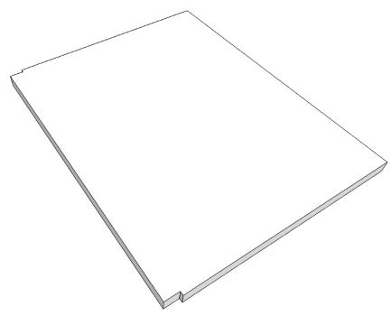

The shelves are then cut at 423mm x 335mm and the front 20mm notched top and bottom:
and slotted in, being simply glued in place with PVA wood glue in the grooves
You can put in multiple dividers this way. An evensimpler way to install thge diviuders would be not to groove the unit, or notch the dividers, but simply to drill the divider points front and rear and install "Magic Wires" top and bottom with a matching sawn groove in the top and bottom edges of each of the
dividers.
The back can be a simple rectangle of 12mm thick MDF sawn 10mm narrower and 10mm lower than the top, the edges chamfered and the whole pinned onto the back and inset by 5mm all round. The back increases stiffness greatlyn

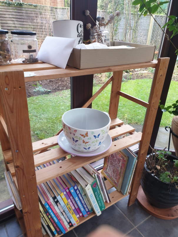

Funny, I used to have a fanatically-acquired collection of approx. 550 albums – mostly late 60s-early 70s prog rock etc. I kept mine in a slightly modified pine rack I bought out of a newspaper ad back then for £30, I think.
I’ll attach a pic if I can find one – since then, the collection has been sold on eBay (for about £5000 – there were quite a few first pressings etc ) the rack has been divided into 4 pieces, and used as separate units for other things.
Ah yes, got one, from back in 1984 I think
It’s not a great pic, but you may be able to see lengths of dowel used to separate the records into manageable quantities, and stop them falling over. Those have since been removed – here’s what’s left. You can hopefully see the location holes (drilled half way into the wood) for the upright dowels:
Of course, this design may not appeal to you at all – if it does, it would be a lot easier to make than your original suggestion – good luck
