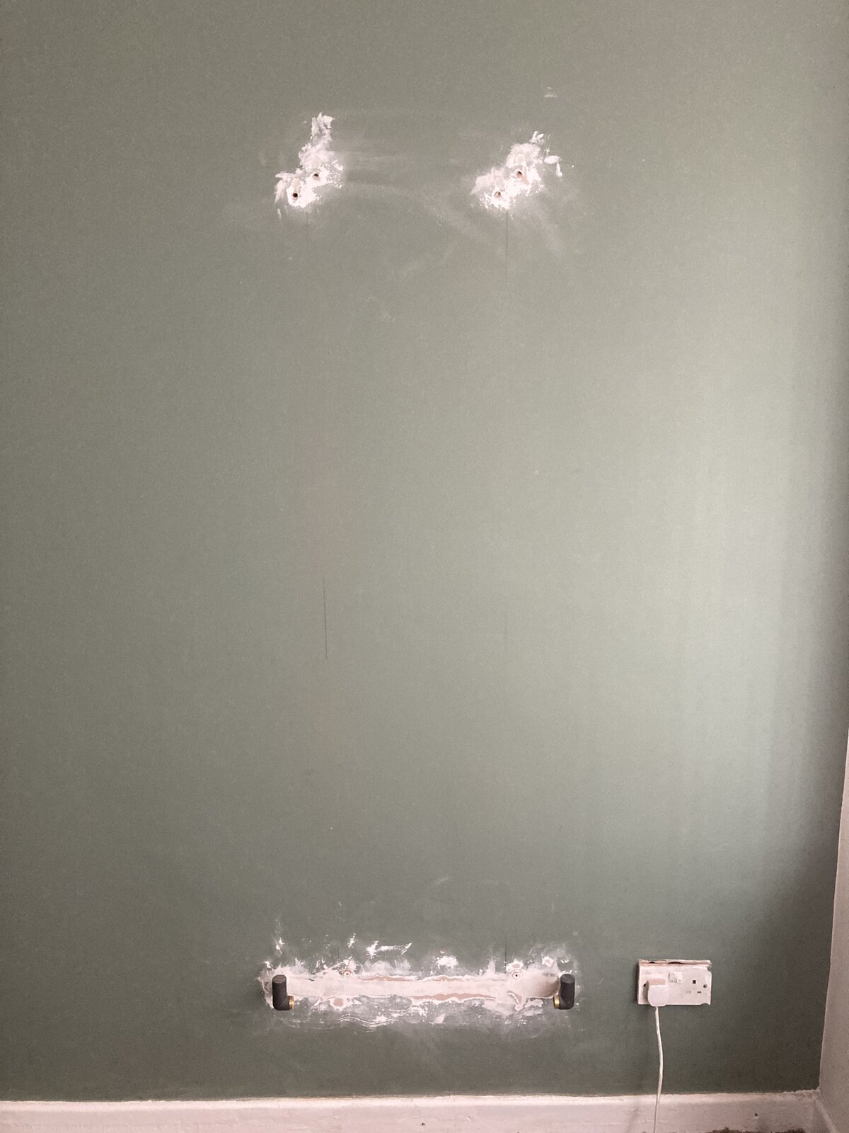

This is how it looks after they came to fill the holes - running my hand down the wall it feels smooth so hopefully it will all paint over nicely. He said it won’t need a mist coat, and I can go straight to putting the top coat on?

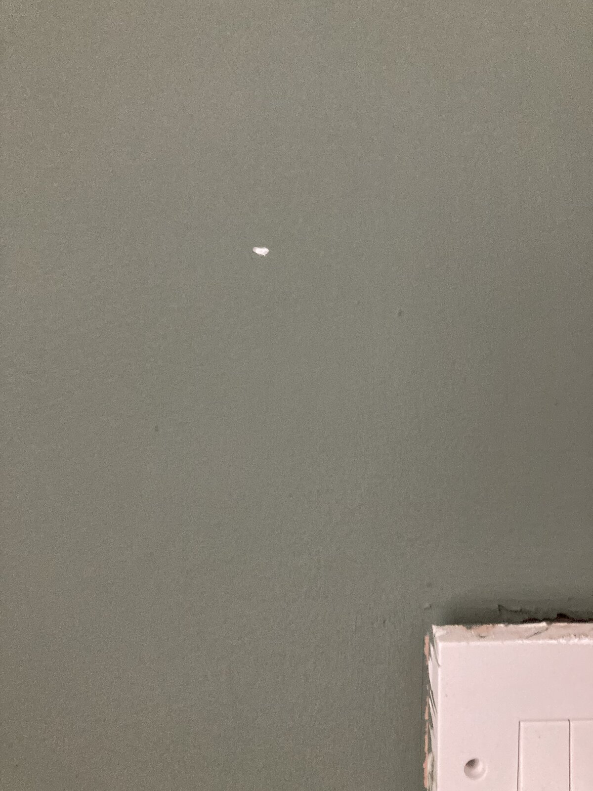

Also, the second photo is a small nick in the paint where they leaned the radiator on the wall :mad: Will running the roller over this also dry the same colour as the rest of the wall?

I would advise mist coating it first, the newly filled bit will suck the water out of the paint quicker than surrounding areas and on some paints and colours can be quite noticeable.
Regarding the nick, it needs to be sanded smooth then painted.
You can paint straight over it but would always see the little dimple
I would patch the wall as best you can, and any dimples or lumps can be sanded again and filled again so it's as good as it possibly can be.
Then I would consider painting the whole wall, because you are bound to see a evidence that you have touched up the paint.
