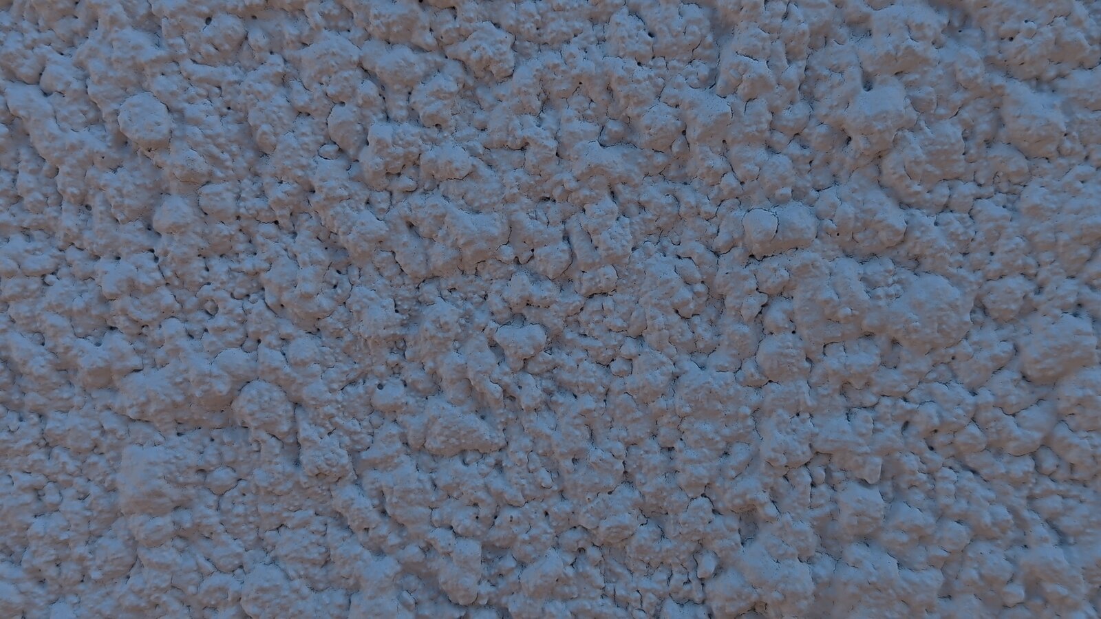

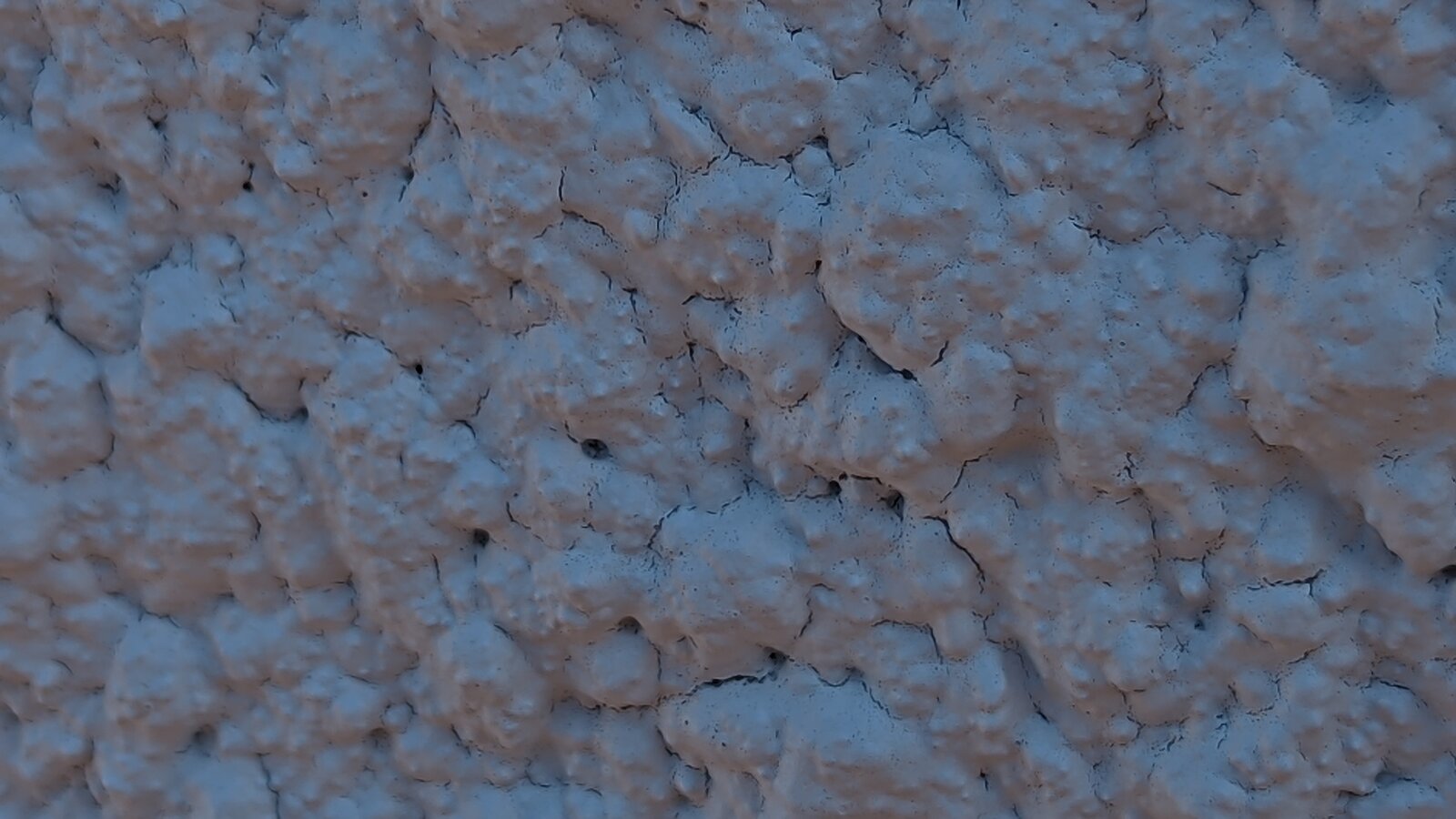

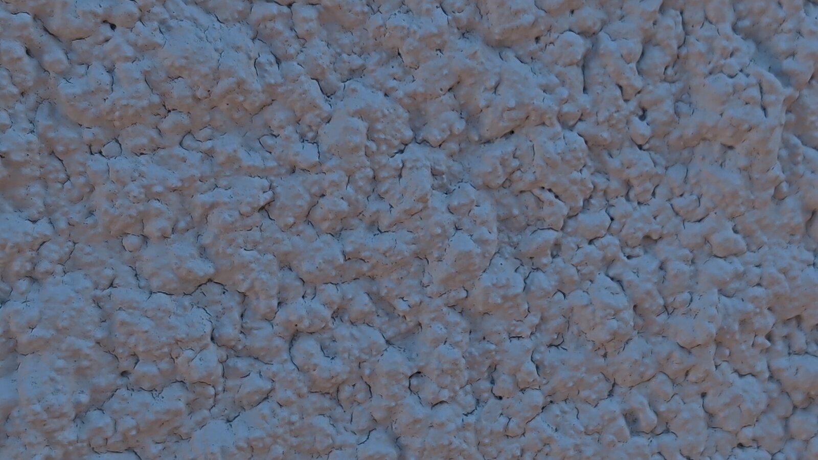

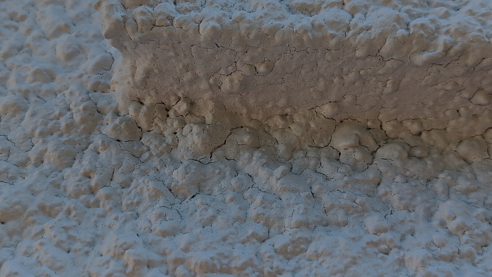

Had my walls professionally painted a few weeks ago and have noticed this effect in the paint over approx 75% of the coverage. Is this likely to be a problem long term?
Paint was Dulux weather shield smooth trade, ashen white.

Looks like the paint has cracked, which will mostly cause the paint to flake off after the winter.

That's what I'm concerned about - giving mould and moisture a foothold. Question is how much is acceptable?
Presumably applied too thick or poor prep?
None is acceptable when paying a professional. Possibly lack of prep and incorrect roller nap and yes possibly the application was too thick.

Did they clean the walls first before painting? Pressure washer?

How was the paint applied?
Was it the trade version of weathershield or the retail version?
I have had similar hairline cracks over pebble dash in the past (when applying the first coat by brush). I tend to do a wet on wet coat to deal with it- That said I am using the tins that say Dulux trade and not the ones simply saying Dulux

The hairline cracks may the result of the paint being applied too thickly, particularly if the surface was dusty before they painted it. That kind of pebble dash is a PITA to paint, you really have to stab at it with a brush. I can see quite a few pin holes in the finish, which would lead me to think that they hadn't been aggressive enough with the brush.
Pressure washing first is often advisable. A bit of light dust isn't too much of an issue, as you stab with the brush the dust blends in with the paint (but that makes the first coat of paint dirty).

No, no cracks previously. It sounds like this is borderline acceptable for professional work, considering the render is difficult to paint. I believe they rollered it btw.
