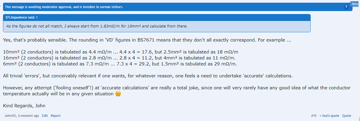

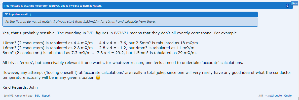

The TLC tables have 10mm² at 1.83mΩ/m and 1mm² at 18.1mΩ/m (all but 10 times) so I think it fair to say that is probably (near enough) correct even though the 2.5, 4 & 6 are not proportionate.

In any event, as I've just written the need for 'accurate' figures really doesn't exist, given the virtually inevitable (and quite possibly very appreciable) uncertainties about conductor temperatures in any particular situation.
Kind Regards, John
Not to mention that the MCB might trip at 4In but we can't assume that.
Indeed and maybe even at 3In. However, all we can really do is consider 'worst possible' scenarios - and I suppose that applies to conductor temp as well as everything else.
However, in the case of a cable used in a circuit whose design current is less than the CCC of the cable at 70°, I think it's reasonable to 'estimate' what its resistance is actually likely to be at the circuit's design current, rather than to work with the tabulated figure for 70°.

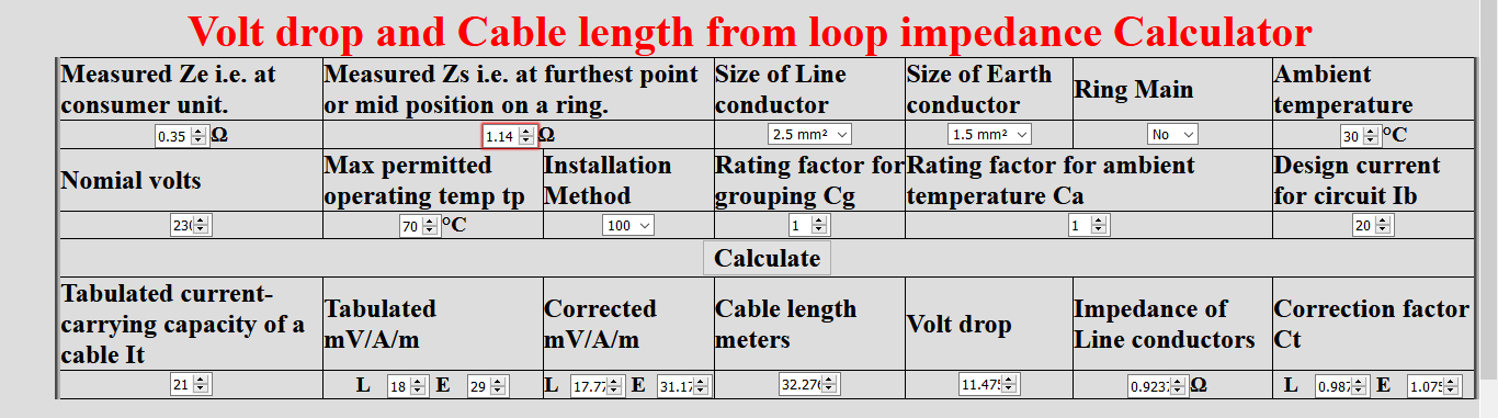

I think your question was fairly easily (and, I hope, satisfactorily) answered. Give or take some details, your maths was conceptually correct, other than that you were implicitly assuming an appreciably higher conductor temperature than would usually be seen in a 20A/2.5mm² circuit (certainly if Method C) - with the main issue being that of interpretation (and the 'relative importance' of VD and Zs).
However, what has spun off from that is potentially a much bigger can of worms. I may be wrong, but I do have a feeling that many people may not be looking at this 'Maximum Zs' business correctly. If someone measures (or calculates) Zs, either 'directly' or as R1+R2+Ze, and then sees a table in BS7671 of 'Maximum Zs' figures, I can't help but think that a good few will simply compare their measured figure with the 'Maximum' figures in that tabulation to decide if the circuit is 'compliant'. I hope I am wrong, but am not confident that I am!
