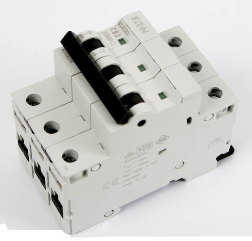

When fixing MCBs in a CU do not use a magnetised screwdriver for the bus bar clamp screw. Or if you do use something non magnetic to push the screw back into the MCB if it has come forward stuck magnetically to the screw driver as it is removed.
If the screw isn't pushed back then the clamp in the MCB remains closed and the tongue of the bus bar goes behind the clamp instead of into the clamp. As a result the tongue is not clamped when the screw is tightened.
The bus bar is pulled forward by the clamps in adjacent MCBs ( assuming those tongues are in the clamps ) so the tongue that is not in the clamp is pulled forward and presses against the back of the clamp. It makes electrical contact and thus the circuit appears to work and it seems also test as being properly clamped.
I normally do a visually on the MCB clamps on busbar to make sure they are gripped correctly.

I think that's very wise - I've always been a bit paranoid about this. Whilst what bernard says about magnetised screwdrivers is one possible mechanism, it is very possible to 'get it wrong' when not using a magnetic screwdriver, particularly with some makes of device.
I can't help feeling that it ought to be possible to improve the design of some of these clamp terminals, to make it much more difficult (ideally, impossible) to get things wrong.

Old memshield 2 used to have a plastic wigit in behind the terminal to force the bus far onto the correct side.

Short of using a dental mirror it seems almost impossible to get a clear view of the under side of the MCB once installed in the CU.
One "old hand" when confronted with these "new fangled" consumer units would remove the DIN rail, assemble the MCBs and bus bar and then fit the DIN rail back into the CU.

Some don't actually clip onto the din rail, they sit onto the top of the rail, the bottom just secured by the busbar. If the MCB is not secured to the busbar, you can still lift the MCB up.
In many CUs it is. That's one of the reasons why there are always inspection mirrors in my toolboxes!
I've sometimes been tempted, but have never actually done it! Whether it can be done obviously depends upon where the DIN rail fixings are.
