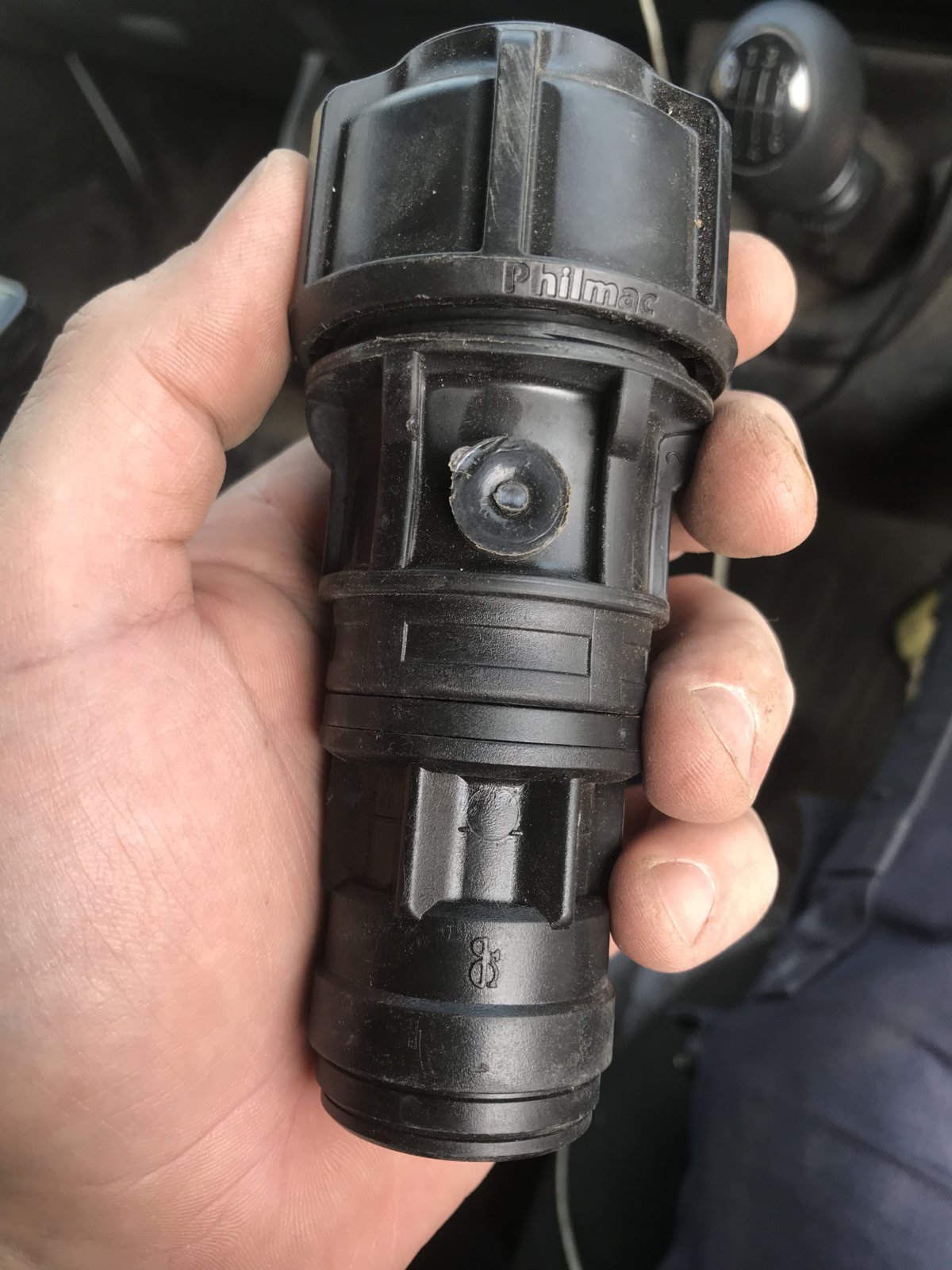

I need to run a very temporary connection to a garden shed using MDPE. I kind of assumed I'd be able to get something that went MDPE -> Speedfit, but unless I'm being thick it's all MDPE -> Copper, even with JG Speedfit adapters.
Can I do it?
Yes, there’s a Philmac fitting with Speedfit socket on the other end.
That’s a 25mm MDPE to 22mm copper or Speedfit but they do to 15mm too
Just googled (other search engines available :D) 25mm x 15mm (assuming that’s your size?), and several are available. In answer to your question, yes you can do it, just can’t b&q it :ROFLMAO:
Haha, cheers all. Looks like it's going to be easier and cheaper to chuck some copper in there but good to know for future, as I may run MDPE to my workshop one day.
