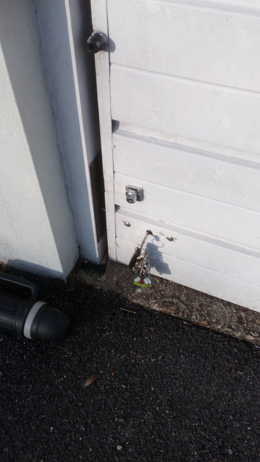

Used these two metal strips to slow down a break in because they can't get to rear screws. They can unscrew near ones though. The screws arent long maybe 25mm shall I put in 70 or 80mm ones? Worried they could still lever it offo
Number 8 screw size

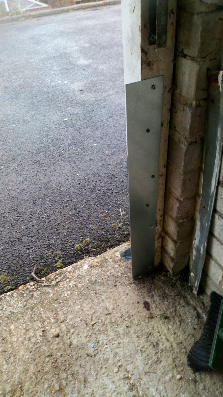

How deep into the hole does the bolt go? This will determine how easy it would be to jemmy the door. I would try to make them sink in at least 50mm from the outer edge of the frame. I would also think about trying to bridge that gap between the frame and the door. Maybe a length of angle iron fixed to the post in line with the door edge so the door will still open but be difficult to get a lever between.
A crow bar would slip in the gap between the door and frame then open the door in seconds.

At a guess the bolt goes between 30 and 50mm into wood. Obviously it comes out of lock a lot more than that. There are two bolts either side of door. The garage door can be forced to the left or right so if pushed to left the gap on the right opens up an inch
So the angle iron would run the total length of frame and screwed into it? Would wood work?
Off to get some metal strips or angle iron then and narrow that gap. Will have to have a bit of a gap i guess so door doesn't jam. Crowbars are tapered so not too wide. Would the metal strips need to run from top to bottom or just the first metre from the bottom?

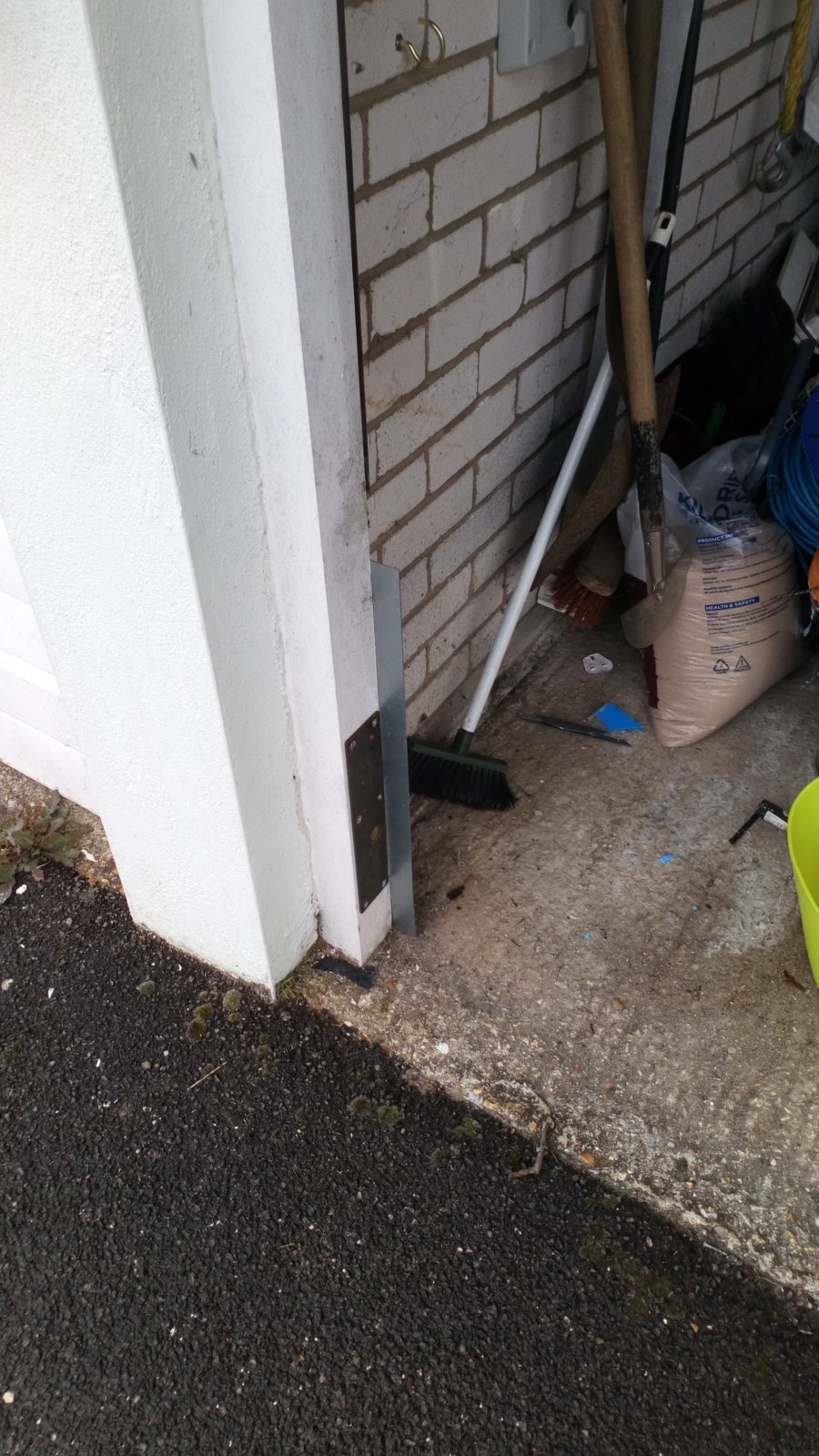

That looks better
If it was me, I would use angle iron on the frame first, protecting the back and side of each frame, then the sheet to stop crowbar entry - actually if you could source a T profile would be the strongest
