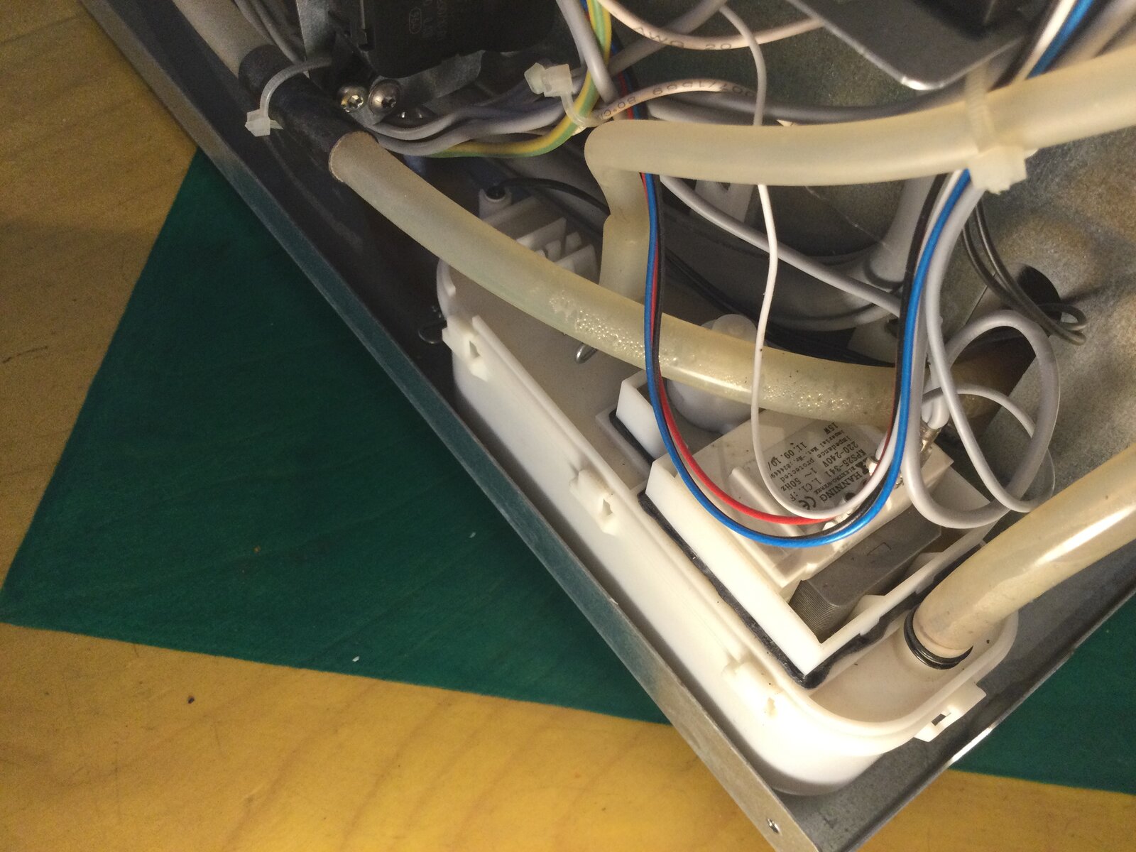

Of course. The model number is DGC5080XL, so it is a combi steam oven. Here is a photo of the pump. Or could this be due to incorrect wiring?
And there is no error code, just warning message "Empty the condensate tray". I guess there is a sensor near the pump that detect this, but the water is in the pump container itself, not on the condensate tray. The tray is empty.

How do you know the pump is not working.Is condensate never pumped up to the tank? Have you checked the pipe work for blockages. Does that valve shown in the video open.
@jj4091 I will get a multimeter and check. I can see the wiring are connected properly though.
I have watched it going through the a circle, it doesn't appear to be doing anything. Condensate does not get pumped up to the tank. It's also very likely the pump itself is blocked due to food debris (similar to how washing machine pump often get blocked). However these pump are so small, I'm not sure I can get to the internals to clean up.

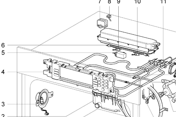

Drain valve (Y26)
The drain valve Y26 closes the hose under the steam generator. This ensures that water is retained in the steam generator. The drain valve consists of a release element which closes or opens the hose under the steam generator. When the drain valve is switched on, its internal heater is activated. The wax in the release element expands and the hose is opened. When the steam generator is empty, the release element heater is switched off. The wax cools and contracts, and a return spring acts to close the hose. The valve is opened after a power failure in order to remove any water from the steam generator. A complete opening and closing cycle can take up to 8 min.
Part 5 below - probably unrelated to your problem, my mistake for not reading the function description properly!

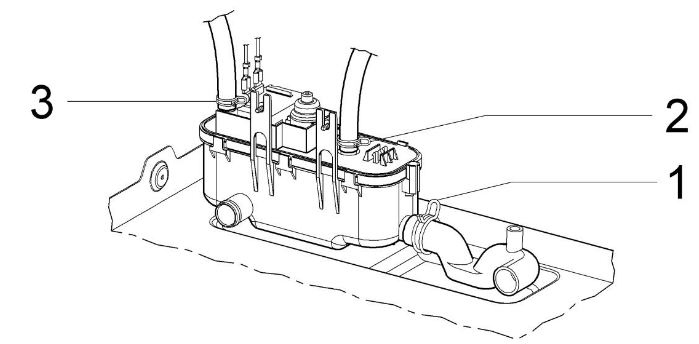

Drain pump
The drain pump has three water connections. The cavity connection, Fig. 1, Pos. 1, is a direct link to the cavity. This is used to drain off condensate from the cavity. Condensate from the condenser is passed to the drain pump via the condensate trap connection, Fig. 1, Pos. 3. The water level in the pump is registered via a float with a magnet. The magnet closes a reed switch and the pump is activated. Water is then passed via the condensate container connection, Fig. 1, Pos. 2, and a hose to the condensate container (tank model) or direct to the water drain (fixed water connection model).
Need to have a look inside if the pump can be opened up? maybe the float switch is stuck as suggested by food debris. Unlikely to be a wiring fault between the switch and controller... but who knows!
