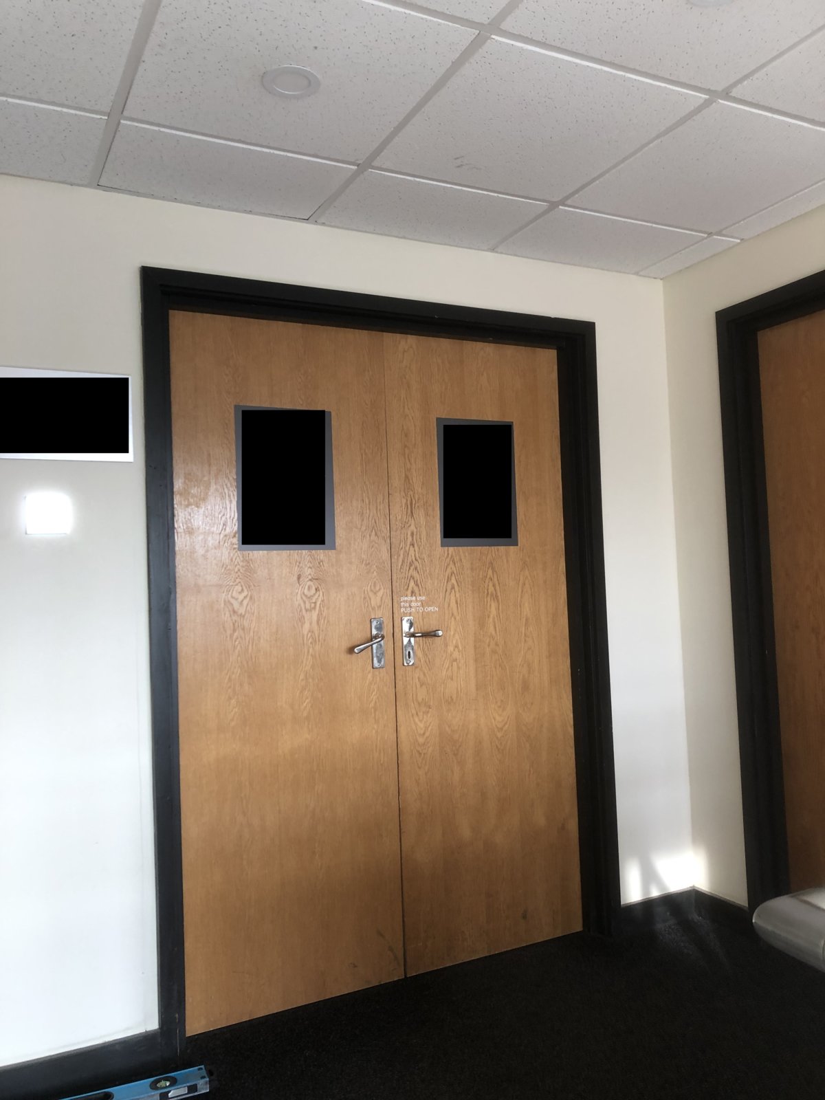

Hello guys
Anyone clued up on commercial regs?
Ive got someone who wants me to fit PVC doors in this as cheap as possible. Its an upstairs office (near the top of the stairs/landing).
The doors although solid don't have incandescent strips and the walls are just standard stud and plasterboard so I assume fire rated isnt required?
Just the height I'm a little worried on, Is there a minimum height regulation? Its going to be about 6ft opening if I go within the existing timber frame by the time it has a PVC top frame under it.
P.S I did quote to enlarge the opening for them but they want to get the price down from that.

1. If the doors are on the first floor opening near the stairs they are likely to need to be fire doors.
2. Whilst I am not aware of a minimum door height I would say general Health and Safety at Work would deem 6ft a significant risk of injury. (not for me as I'm a short arse)
The mind boggles why anyone would want PVCu doors internally.

Tell them the doors need to be at least standard 1981mm high otherwise anybody over 6ft will keep banging their head if the doors are only 6ft high.
ps presume you meant intumescent strips. You are probably right to involve Building Control if you are installing doors that should be fire doors ( fire doorset :cautious: ) and then they might want to reconsider pvc doors :!:

If that's an office environment, and that's an escape route, the doors will need to be self-closing fire doors with intumescent strips. And certainly no raised threshold.
The owner occupier should have a fire safety risk assessment, and this would state this. Otherwise, if there is a fire or they get a routine visit from the fire service doing checks, then he's in trouble.
I would cover yourself and refuse to fit any doors unless you are sure building regs on fire safety are being met.
ps glazed doors can be fire resisting and glazed vision panels are required in doors on a common corridor in offices anyway.
Its not building regulations but the Regulatory Fire Safety Order 2005. The onus is on the building owner/occupier to do (arrange) the risk assessment, and it's whether the risk assessor deems a fire door to be required - but in all work environments, and fire door will be required on offices, corridors and escape routes.

By piercing the door you have destroyed the fire integrity - glazed fire doors need to be supplied with a test certificate. The issue is not only the glass, but also the intumescent glazing mastic, lippings, etc.

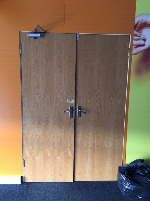

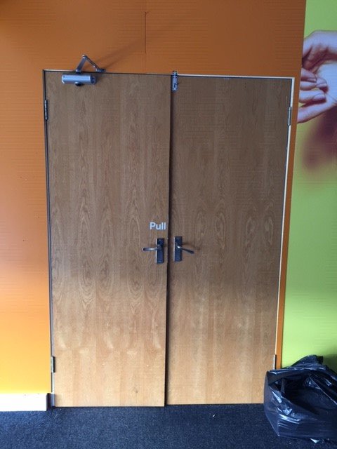

Are the doors actually compliant now? I.e. gap round 3 sides of 2 to 4mm, max gap beneath of 4mm (with or without a drop seal fitted), fire rated hinges on intumescent packers, appropriate intumescent or intumescent/brush seals in frame, frame appropriately sealed and fire-stopped (beneath architraves), doors currently marked with something like a CertFire or BCF rating sticker, appropriate closer, etc
The certificate of a fire door is invalid as soon as you alter it.
If you did cut a hole and fit a glass panel, it may well be OK, but no one (a trained assessor) will say that, so the it only way to prove it's performance would be to test it, and thus destroy it.
As I say I don't think they are fire doors (certainly not to modern specs anyway) just solid core doors I think. I will take one off and feel how heavy it is.
It has some wool brushpile strips around the frame but they don't go past/around the hinges and there is nothing between the 2 doors or under them

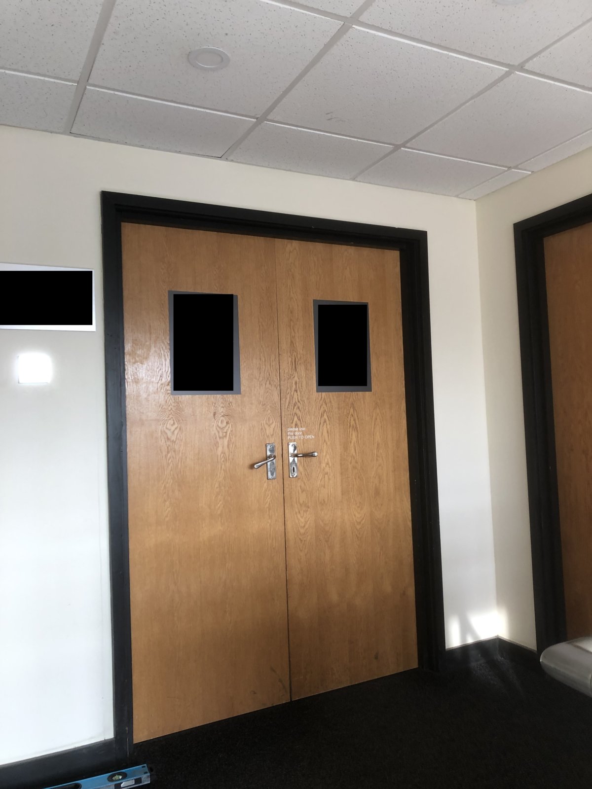

Here is an inside pic, The doors would be around 15 years old.
I have fitted Pyro glass for a loft conversion before so I have the specs for the glass, beading sealing of the edges etc although that was around 3 years ago before Grenfell.
Good point about a test certificate though.
I didn't have a good look around the offices myself but the customer has informed me that there are 2 other fire escapes with metal stair cases at either end of the building.
