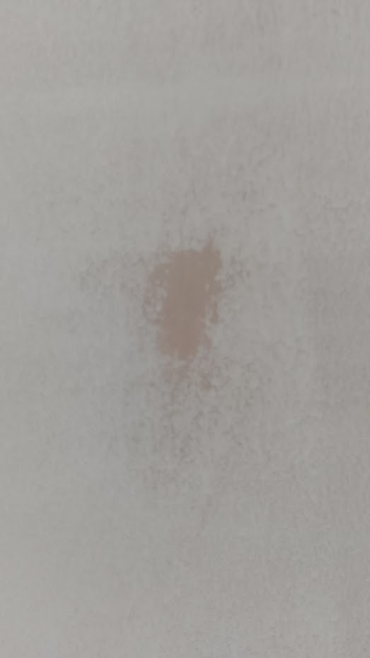

Hi all,
Just looking for some advice from any decorating experts on here please. I tried to mist coat some gypsum plaster the other day with Wickes Matt emulsion but reckon I might have c*cked it up!
I'm thinking I watered down the paint too much as I get a chalky residue on my fingers if I rub the wall in certain places. It can withstand the masking tape test easily, but if I rub hard enough it can also remove the paint completely in places (see poor quality photo)
Have I blown it? And if so how can I fix it - a wipe down or sanding and start again?
The room was plastered last year so good and dry. The instructions stated up to 40% dilution for fresh plaster (I think I may have gone 50/50). The instructions also stated to use the specialist mist coat emulsion for new plaster which is a bit contradictory.

Non-vinyl emulsions are somewhat porous, so suitable for use on new plaster that is still drying out. The tradeoff is that they are not durable. It makes a new house look decent until the buyers move in. Once the plaster is fully dry it can be painted over with something better.

Remist the bare patches and then give it an unthinned coat. It will even out the colour and absorbency and was cheap.
Then Paint over it with your preferred finish paint.

Funnily enough John I thought about doing a 2nd mist coat and then an unthinned coat but I wasn't entirely sure because the instructions stated only 1 mist coat.
I just trialed a few of the edges with some unthinned paint - its still a little chalky but would this be ok to go over with a more durable finish?
Yes, but you must mist the bare patches first
If your mist coat was very watery, and has sunk into the surface so you can see through it, give it a second thinned coat with 10% water. You will know when you have sealed the surface because it will no longer suck the moisture off your brush.
