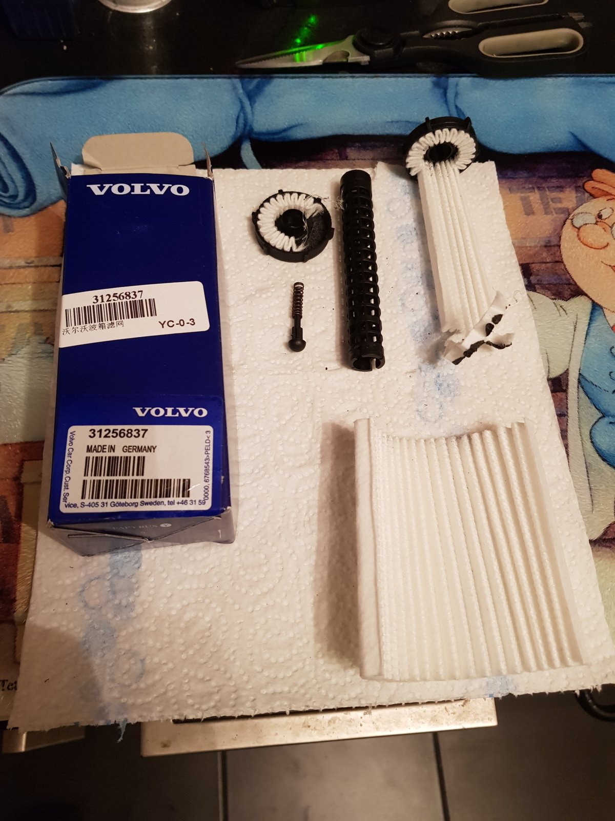

Just took a "Volvo" one apart, the filter gauze has a nylon mesh "support".
The genuine one has a stainless steel mesh to stop the filter collapsing.
They've put more time into making the box look genuine than the "filter"..
Don't know wether to be happy I've found an issue or pxxsed off that I've been sold knockoff filters..

It's 100% fake John, no question about it unfortunately.
From now on I'm keeping a genuine Ford as a quality control and comparing every replacement to that one.
Had a quick look at the "Volvo" ones before they went in, no obvious signs from the outside they were counterfeit and didn't occur to me to destroy one to find out!.
On a plus note I've got 5 known good ones to use, should last a while!.
If the filter medium has collapsed due to inadequate support, the bypass hasn't opened correctly (far too stiff) it's a recipe for disaster. Luckily due to fresh oil the gearbox has survived.
Much more confident in the car now.

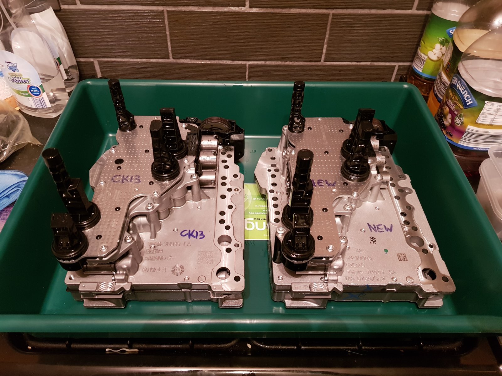

Well it did 450 fault free miles then the wife text me last Monday to say it was playing up again.

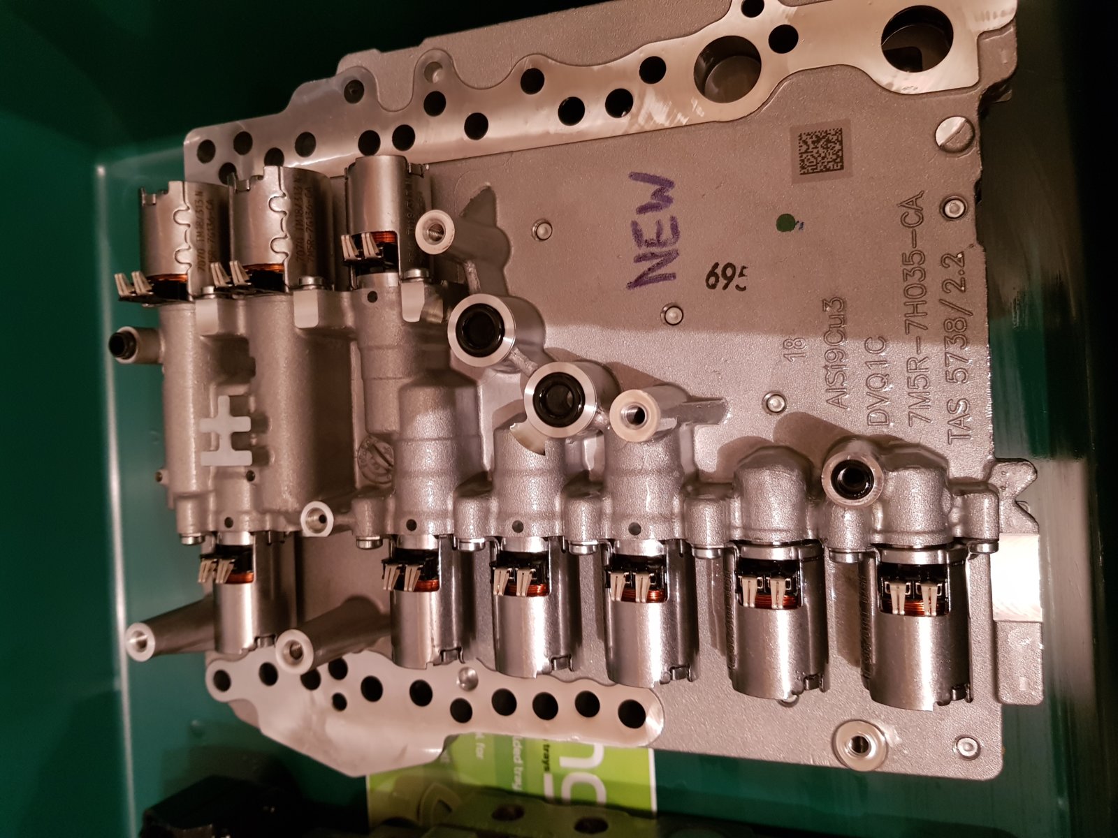

I've narrowed the fault down to Clutch Shift Modulation Solenoid 1, but these are not available as a seperate part unfortunately.
I found a brand new Mechatronic unit for £1060 so bit the bullet..
Unfortunately these come "blank" so I had to remove the Transmission Controller off the old one (married to the car) and swap them over.
I found a company in Poland that can rebuild the solenoids so I may end up sending the old ones to them for testing (didn't have time this time.).
Took Wednesday and Friday afternoon off work and managed to get it done in 8 hours this time. Lovely holiday laid under the Kuga..
If it goes wrong again I will be taking the sledgehammer to it I think..
Only saving grace is I've saved on labour costs (Ford is over £100 an hour now!).
We shall see..

Not giving up just yet!.
Heard a few people have used UK "specialists", one had his valve body inspected for £300/ £400 and it was worse when he got it back..
I might send the old ones off to Maktrans in Poland for testing, they have made a dedicated rig to test under normal operating conditions with a graph of performance, voltage etc.
Looking at their graph of a failing solenoid it looked exactly like how our car reacted, stepped rather than smooth clutch operation.
At least then I've got a spare valve body ready to go..
Seems garages just throw clutches at these 'boxes regardless from what I've been reading, not realising the solenoids are soley responsible for clamping pressure.
