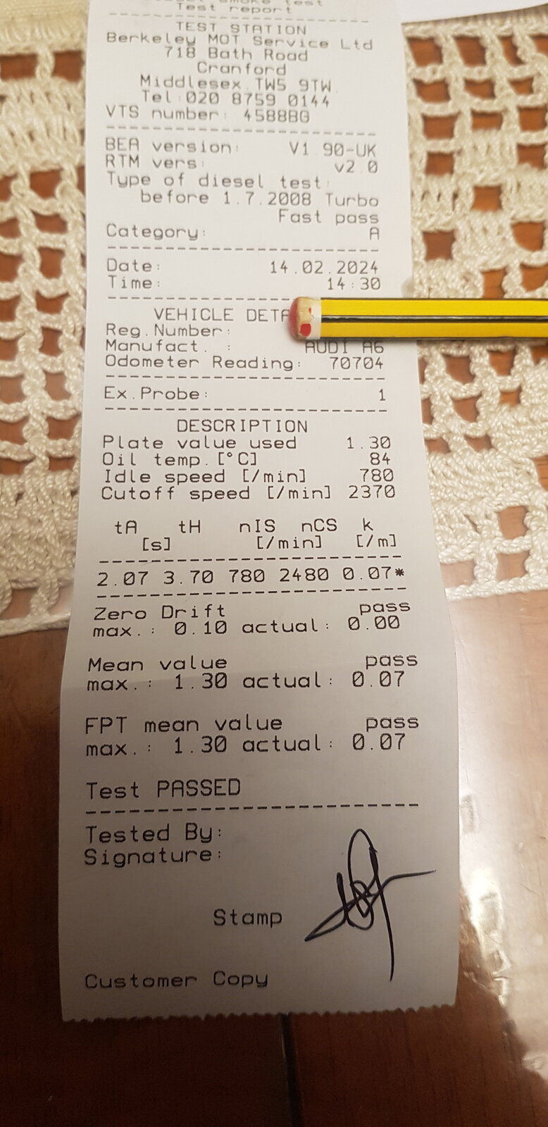

Had MOT done yesterday and, forgive me if I am not very good with numbers, but the limit of my diesel test is 1.30.
My "dirty" car has spat out 0.07.
I used 3 search engines and 1.30 seems to be a number a lot bigger than 0.07.
I find this strange.
Should I trust the internet?
Also, I asked my engineer friend and on top of his head he said my car is almost 95% cleaner than the limit set at factory (limit taken from chassis plate).
He's probably just making it up.
How come do I have to keep my car under a cover hoping for the emperor of Londinstan to fall?
Still confused......!
