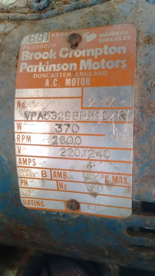

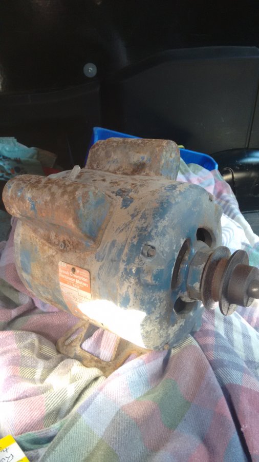

Looking at the original motor,
there doesnt appear to be a starter but just a small toggle switch on one of the 'pods'
I understand the new motor should be a Cap Start/Cap Run type rather than Perm Cap due to the load it must turn from standstill.
The correct 2800 rpm versions have just L and N connection terminals.
Would the answer to the original question change if I upgraded from the 0.38kw to a more powerful one ( the physical dimensions are a better match on the upgrades)
