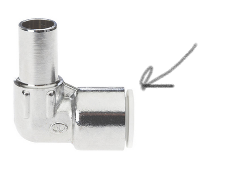

A little follow-up question, if I may!
It has been mentioned that the following fittings are reusable:
With the system drained, could I just push-in the white collar and pull out the hose, without cutting it off?
You get 2 types of 10mm push fit stems
th
th
The ones you linked to, in the post with the pegler instructions were the former that need to be cut off, the first pic of your rad valve was the latter type that are demountable.

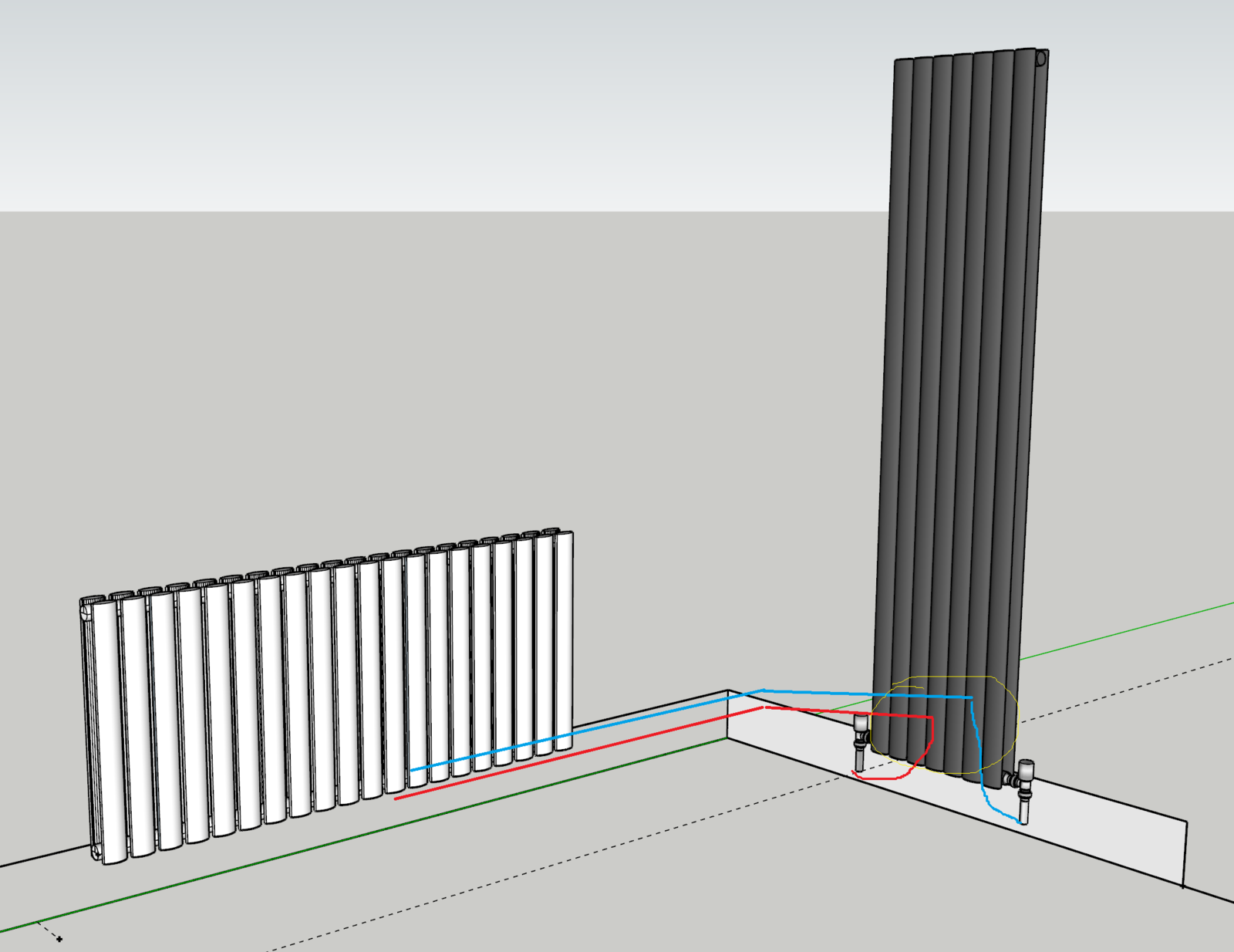

I am so sorry to keep coming up with more questions! The Mrs has raised the stakes by suggesting that we hide some of the pipes into the wall. I have a very rough sketch of this:
One question that I have is: how bad would it be if the 15 mm flexible polybutylene hoses form a bit of an arch within the wall (area circled in yellow)?
I think they will need to go up a little bit, to then come down from the radiator faceplate. Would it create any problems for the water flow?

One question that I have is: how bad would it be if the 15 mm flexible polybutylene hoses form a bit of an arch within the wall (area circled in yellow)? I think they will need to go up a little bit, to then come down from the radiator faceplate. Would it create any problems for the water flow?
Are you extending in 15mm, or sticking to the 10mm as per the current pipes? 15mm would likely require cold-formed bends to help it bend without deformation in what looks like limited space, but 10mm is far more flexible.
Thank you for highlighting this! I somehow thought that the smaller ones are 15mm.. nearly added the wrong item to the 'To Buy' list!
