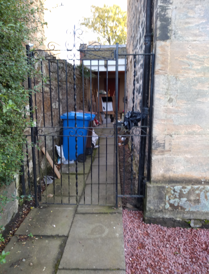

Ordered two patio doors and two windows, triple glazed, timber frame, and then found out that the heaviest of these is 230kg, and about 3m by 2m! The mechanical offload truck can't get into me so I am probably going to collect by hiring a dropside cab and getting the factory to drop the pallet on the back, and if I can get one with a tail lift I should be able to use that as a bridge, that will help with the first problem, which is getting it up the ~1m height difference between driveway and the front of the house. My plan is to take each unit off the pallet individually, and carry one at a time to the rear of the house, as the only access is down a side path about 1m wide. I am hoping that I will be able to lift out the sliding section and move this separately, which would cut the weight of the heaviest section down to say 130kg-ish.
As I can't get a hold of any Kryptonite I will obviously getting help to do this, but I don't have a lot of able bodied people I can call on. My brother will be there, and we have moved an old cast iron piano between us before, which was probably around 250kg, but a Piano can be set down and doesn't have the tipping risk. Suspect this will need some more bodies, at very least to stand at each side to prevent it tipping. Also thought of trying to rig up a dolly of some sort.

I'd post a picture or two of where you got to install to give people a better idea of the best method. Also you not been drinking your Iron Bru laddy.

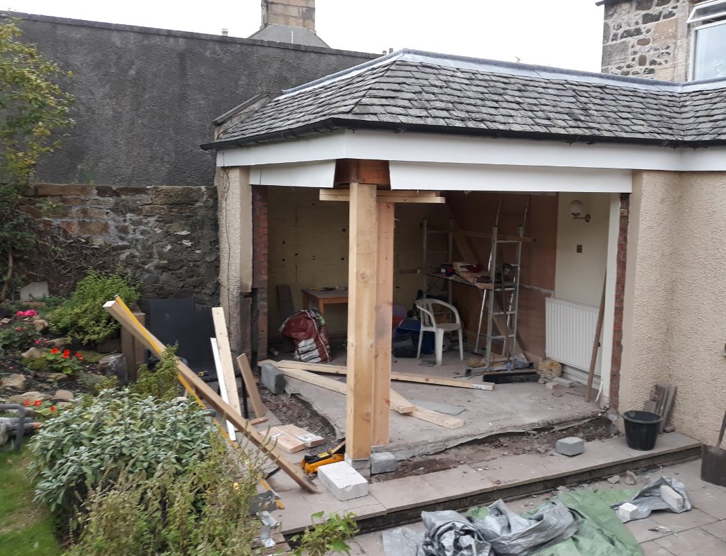

Driveway - a I mentioned, I am planning on reversing right up to the bottom of steps, then using the tail lift as a bridge across to raised area.
Once its on the path I may be able to wheel it around with some sort of dolly, can take gate right off the wall if need be, but width not really the issue.
Its a bit further on than this now, but gives an idea of the space they will need to be lifted into. Wall has been built back up to slightly higher than the height of the slab to receive the windows and leave enough for insulation and floor covering. Plan to leave 2cm at the top, and there is a good bit of space at the sides that will be built back out.

look into piano dollies. Hire one with large wheels
also lay down plywood or OSB as a surface.

The lift is a good idea, I think I looked at these before when trawling through the hire equipment for something that would help, but it would need to be turned sideways to get down the side of the house, and then the length of the lift at the bottom would be too wide to fit.

Use 1 only and set slightly it off centre -its more controllable.
With one dolly you can push in a straight line, then stop and swivel around to change angle.
If the frame is timber can you screw some 4 x 2 studwork 'handles' either side -the external part of the frame is not seen as it will be against the brickwork.
Have timber offcuts around like bearers to sit frame or glass on.
Have some rags or bits of foam, even celetex for when you want to lean against a wall.
Do not move glass if wet, its really slippery -I dropped a big conservatory dg unit once, it just slipped.
If you get anything like a dolly, use some pipe -110mm soil pipe might work or short scaffold pole offcuts.
What you are moving is well doable, 3 people would be better, but you should manage ok.
