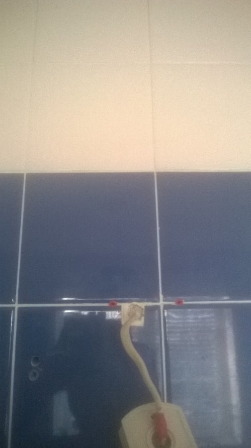

I want to change a bathroom light in zone 2, but rather than in the original position I want to have the new one 6 inches higher up (directly vertically above). It is a tiled wall, and where the old light was I want to hang a (larger) mirror and the new light just above the new mirror.
The big question is, how to relocate the cable upwards.
It is first floor bathroom with the loft above, so I would think the cable comes down from the loft, but I haven't been able to verify this yet, as the cable entry through the tiles is filled with silicone. What is the best way to remove the silicone without risking damaging the cable? Would silicone eater be safe?
If the cable did come from above, I hope I could drill, very carefully, a hole in the new position and hope to "fish" the cable. Any advice on this?
If this doesn't work and I need to work with the cable where it currently comes out of the tiles, I would need to run it upwards behind the new mirror, which sits rather flush on the wall. If the wall wasn't tiled, I would chase it in. Is there an easy way to do something similar with a tiled wall? As it will be covered by the mirror, it doesn't need to look beautiful, but I want it to be safe. In this case I probably would need to extend the cable by just a little bit. Is it okay to use a small junction box or something similar in the bathroom (zone 2 but covered by the mirror).
I attach a photo. I need to move the light about 1.5 tiles up.
Use thin nose pliers to grip parts of it and pull it away. Once a certain amount has been nibbled out, the bulk of it should pull away in one piece.
Unknown, but it is vile stuff and won't do what you expect anyway - it's designed for cleaning away small residues of silicone after you have mechanically removed 99% of it.
Not suitable for removing large quantities.
For locating the cable, drilling a small hole is likely to be doomed - even if exactly in the right place and you managed to drill the hole without causing cable damage, it will be very difficult to get the cable through it even assuming it is in conduit. If it's plastered in, no chance.
A better option would be removing the whole tile above the existing cable location and then chisel away the wall to locate a decent length of cable.
If the grout is scraped out from around the tile it is often possible to remove them in one piece, in this case using an old screwdriver or similar from the lower edge where the existing cable hole is should allow it to be prised away from the wall without damaging surrounding tiles.
Pop into the loft to see if there is a wire entering the top of the wall.

If your going 6 inch higher anyway you could lose that tile, sometimes you can score out the grinding and pop them off
I finally had some time to have a go at that. As you suggested, I removed the tile to the top. It turns out the cable does come from the loft as I thought, but is in an oval conduit, of rather soft plastic. So I will need to carefully open the conduit up.
However, I still need to get a bit higher, and want the cable to come out in the bottom third of the tile above the removed tile. Any advice how to achieve this other than removing that tile as well, route the cable to the right spot, and then cut or drill the tile? If possible at all, I'd rather not remove that tile as most of it, and the surrounding grout lines, won't be covered by the mirror or the light I want to install.

Pull the cable out of the conduit, then you won't need to rely on your care to avoid damaging it.
When you replace the tile(s) you'll surely do the grouting, so why is that a problem?
Anyway - if I've understood you correctly, then once you've pulled the cable out you'll be able to safely drill a hole in the tile through into the conduit.

The problem isn't the grouting as such, but that the grout rake damaged the tiles a little bit.
I am at the moment not able to pull the cable out of the conduit, as I can't get to the other end easily. Access to the loft is very difficult.
Had there not been the conduit I still had hoped I could have drilled the tile about two fingers above where I have access to the cable and then somehow pulled it in. But I guess that is hopeless.
Is there any trick to cut a corner out of a tile in situ?
If not, then guess I either need to get to the loft or remove the tile.
