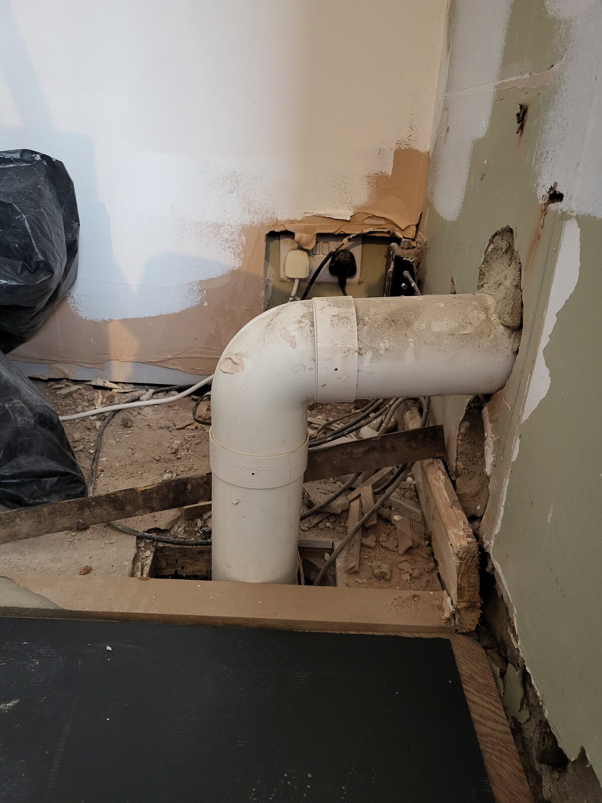

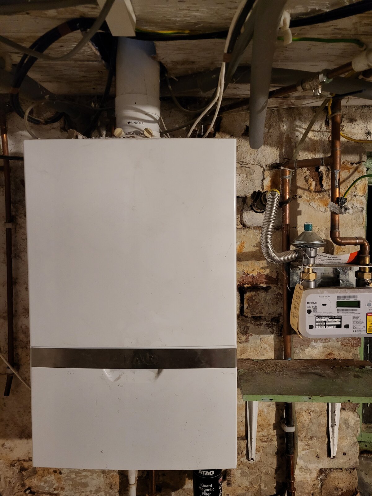

Really stuck with this one, and thinking there may not be a solution unfortunately, but thought I would ask the experts . . . .
My boiler is in the cellar below the kitchen and the Flue comes straight up i50cm and then right angles to the outside wall. This used to be inside a cupboard so wasn't an issue, but we are moving our kitchen and were hoping to put the integrated fridge in this location - Is there any way we would be able to get the flue closer to the wall so the fridge would be closer in to the wall? (thinking maybe running the horizontal pipe at 45 degrees?) - otherwise, we will have to rearrange our layout
Boiler is an Atag ic28

You might be able to use x2 45 degree elbows, or an additional 90 degree elbow to take closer to the wall. Might need eyes on site though to confirm.

thanks for coming back so quickly - does that mean the horizontal pipe could run at 45 degrees?

No, it means some additional fittings will allow the vertical pipe to move closer to the wall, or is that not what you wanted?
