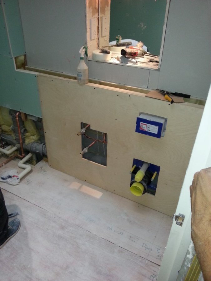

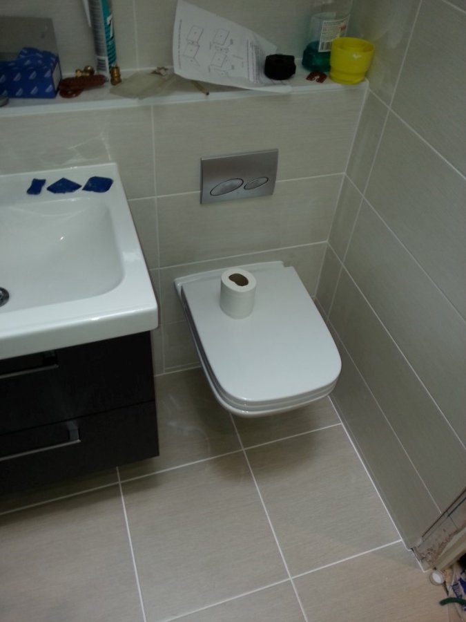

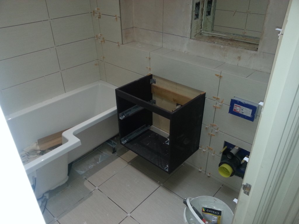

Geberit Wall frame and wall hung bog. make a nice box out and hide all the pipe work in there. Can get a vanity sink from Ikea if needs be.
They do now.... which is the bloody problem with the shaver socket (took a year to get round to doing it :LOL:). The line he drew was based on the old ledge. Not sure how it should have been dealt with really as time was against him - so no chance of moving the socket up.
