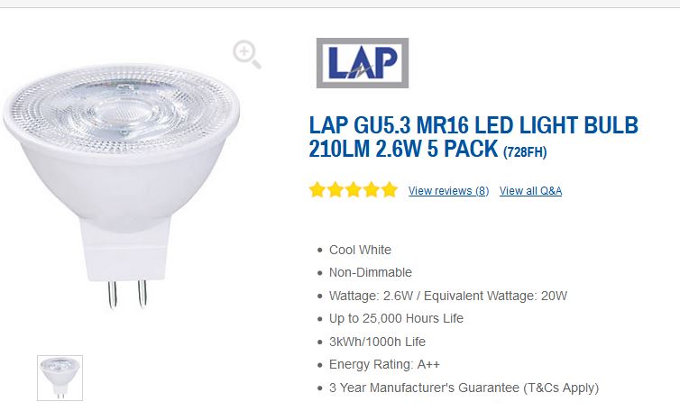

I am looking at these in screwfix https://www.screwfix.com/p/lap-gu5-...ck/728fh#product_additional_details_container problem is they do not state if they are DC only or AC/DC others are asking the question that is not being properly answered there.

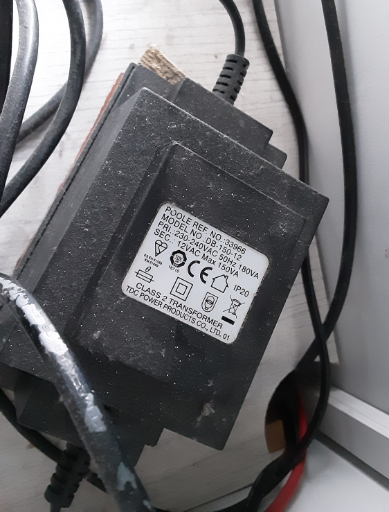

My transformer is an older 12V 150W AC. I have 12 7w (rubbish] T15 wedge bulbs at the moment.

The transformer is a heavy wire wound one. Do you think teher will be a problem with the LEDs being too low at 2.6 W - there will be 15 of them = 39W total.

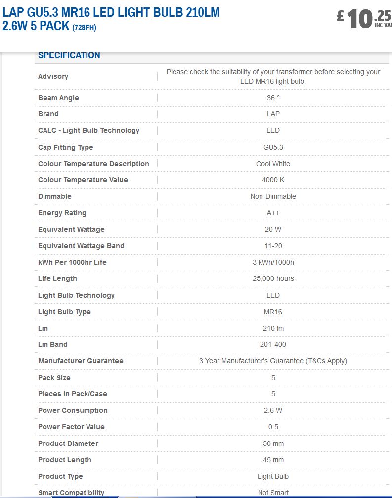

I did not know the link was blocked but these are the ones I am looking at and there is no writing on those one to see here are the screenshots

Wire wound transformers do not require a minimum load to operate properly, the output can be left open circuit without causing any problems.
It is Switched Mode Power Supply ( SMPS ) "transformers" that can become unstable when the load on them is too small
The transformer is a heavy wire wound one. Do you think there will be a problem with the LEDs being too low at 2.6 W - there will be 15 of them = 39W total.
View attachment 188850 View attachment 188851
Transformers don't have a minimum load. However regulation is often not all that good, so the output voltage could rise with only a 39 watt load on a 150 watt transformer. However I would not worry about it, the rise will be fairly small.

So its unlikely that a MR16 12v led bulb will be DC ONLY - so most of them are AC/DC and none of them are AC only :unsure:
It doesn't help not knowing the manufacturer of the LAP screwfix ones so I could check there.
Some could be AC only, these use a capacitor to limit / control the amount of current driven through the LED element, these will not work on DC.
In that case I want to try and avoid investing in AC only bulbs ( need 15 ) because some time in the future I may need a new transformer and that then could be a proper driver instead.
Looks like a Ring select-a-light Transformer from B&Q.

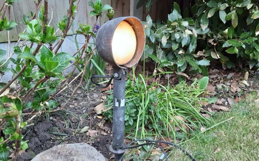

And the lights are like this?
You might struggle to get the MR16 lamps to fit in the T15 fitting (I've tried).
Yep that's the one apart from my lights are like this. I have done one and replaced the T15 with an MR16 fitting very successfully there is even a round recess just bigger than the MR16 porcelain which I hot glue melted in place.
I will convert another and take pictures at each stage. ( I have got 15 to do ) those 7 w T15 bulbs are rubbish. I looked at replacing with T15 LED bulbs but some of the reflectors have lost a lot of the chrome, it doesn't matter with brighter MR16 bulbs as they don't need the reflector to bang out the light as they are the reflector
