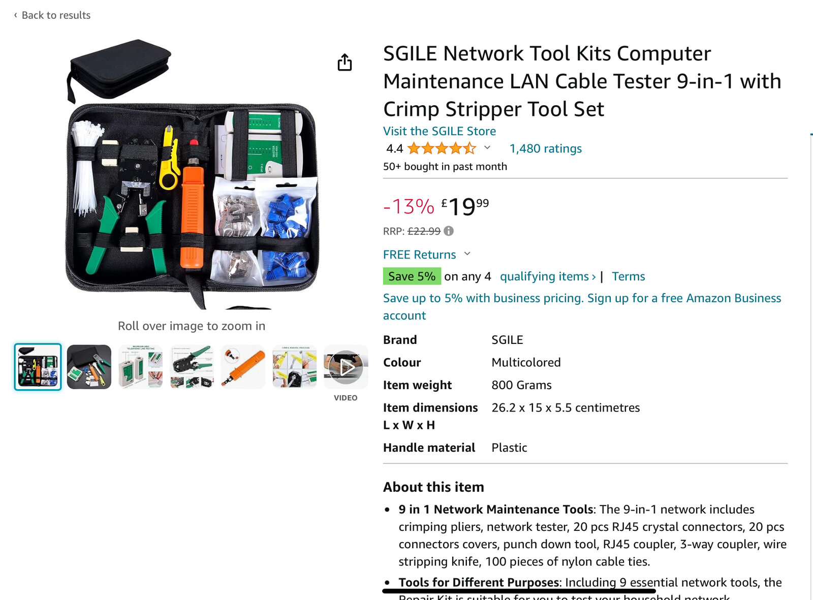

When I did mine, I bought a reel of loose cable. You can make a neater job if you cut it to length and fit your own ends. It’s really easy - the complete kit with crimping tools and even a line connection tester is really easy to use and can be bought for less than 20 quid. I used Cat 5E in my house. You need to get proper copper cable though, not copper clad aluminium (CCA) cable.
When I did mine, I bought a reel of loose cable. You can make a neater job if you cut it to length and fit your own ends. It’s really easy - the complete kit with crimping tools and ebven a line connection tester is really easy to use and can be bought for less than 20 quid. I used Cat 5E in my house. You need to get proper copper cable though, not copper coated steel cable.

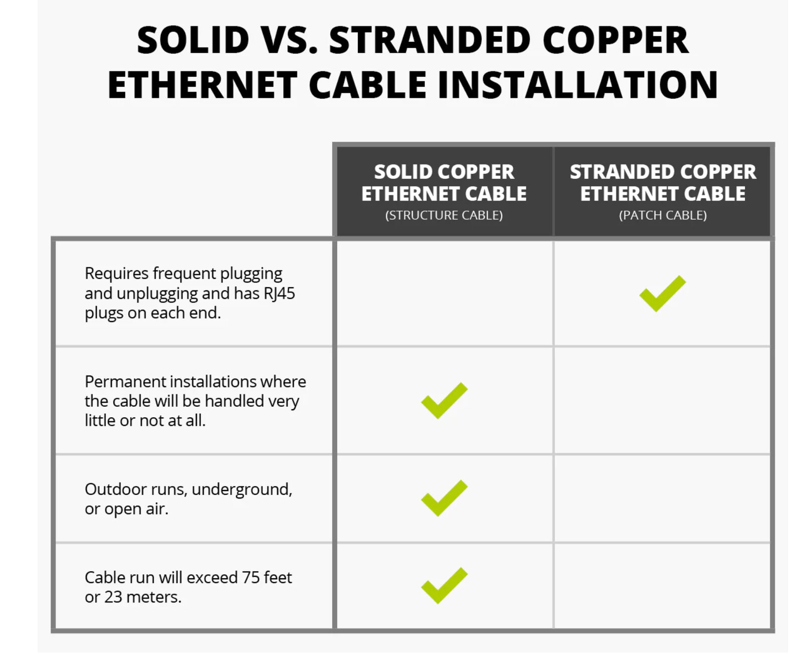

..and the stranded, rather than solid cored.
Only for the patch cables, not the main fixed runs.
The crimp on plug ends don't work reliably, with the solid cores. The solid cores are fine as you suggest, for fixed runs, socket to socket.
So it would be...
plug - flexible - plug - socket ------------ solid -------------- socket - plug - flexible - plug
If you wanted to not bother with sockets at all, then it would be...
plug ------flexible -------plug
So it would be...
