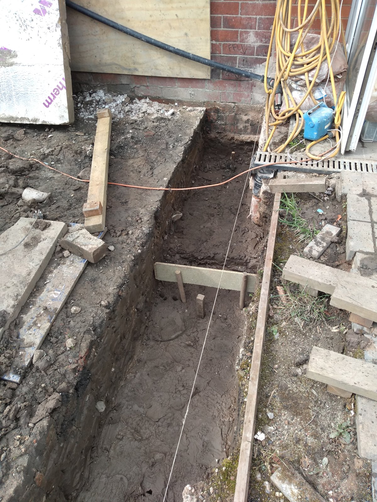

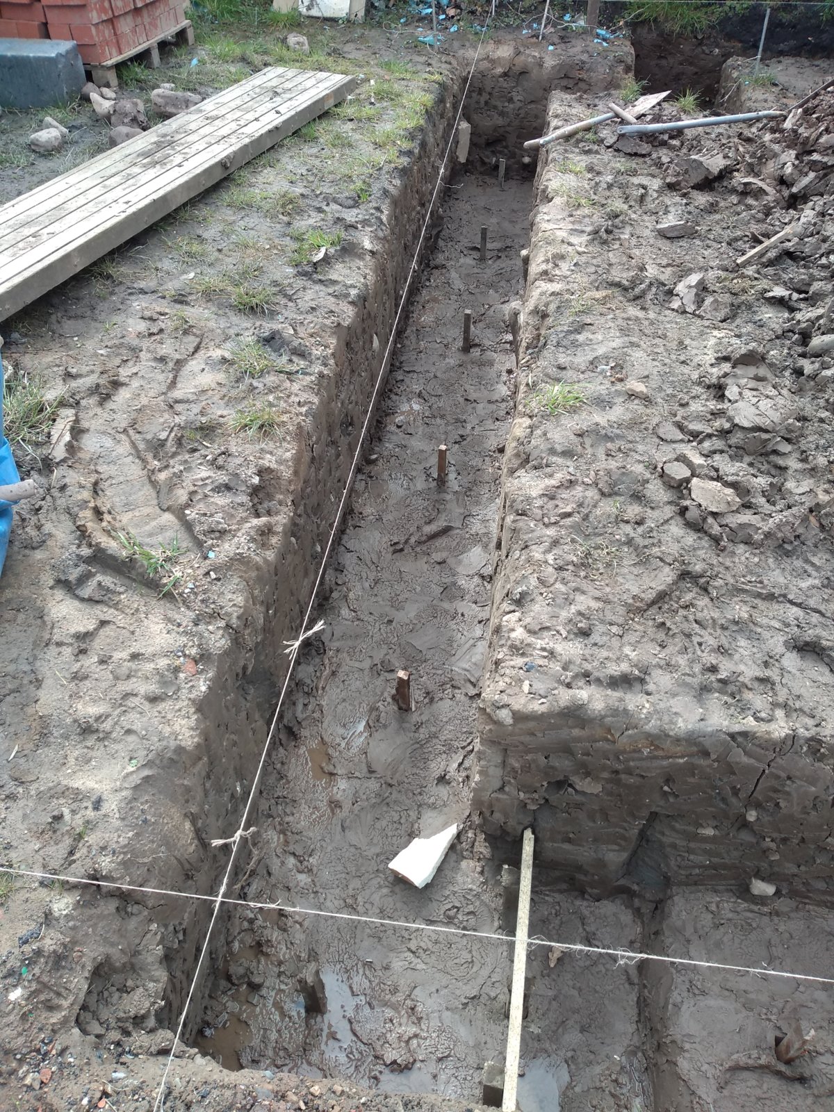

I started my 18m of foundation trench on Monday and put in my building notice application. I dug a sample section 750mm deep by 600mm wide and was expecting (as it's clay) to be told to go down to 1m. BCO came out today, seems very reasonable. Said unless I wanted the exercise not to go that deep (we must have hard clay here up North, not that soft southern stuff). He said 600mm deep and to expose the existing house foundations and if they're higher just step up to them. Then he rang me about another issue and I said I'd exposed the existing and they were about 450 down. In that case, he said dig the rest to match - 450 is the minimum we'd accept for clay. Happy days - but I'm still going 600 down and stepping up to 450 at the house.
Only thing he did say was that I need an SE on board straight away because there's lots of steel going in and any pads etc would be best done with the foundations.
I will update and post some photos when the sun stops shining and it's back to rain as usual.

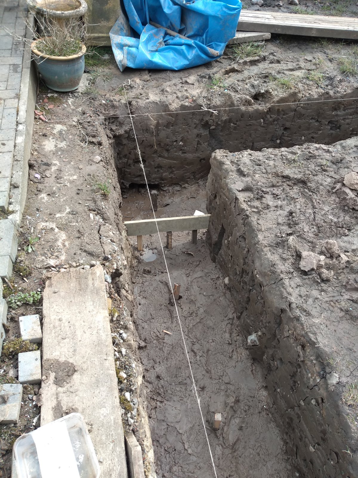

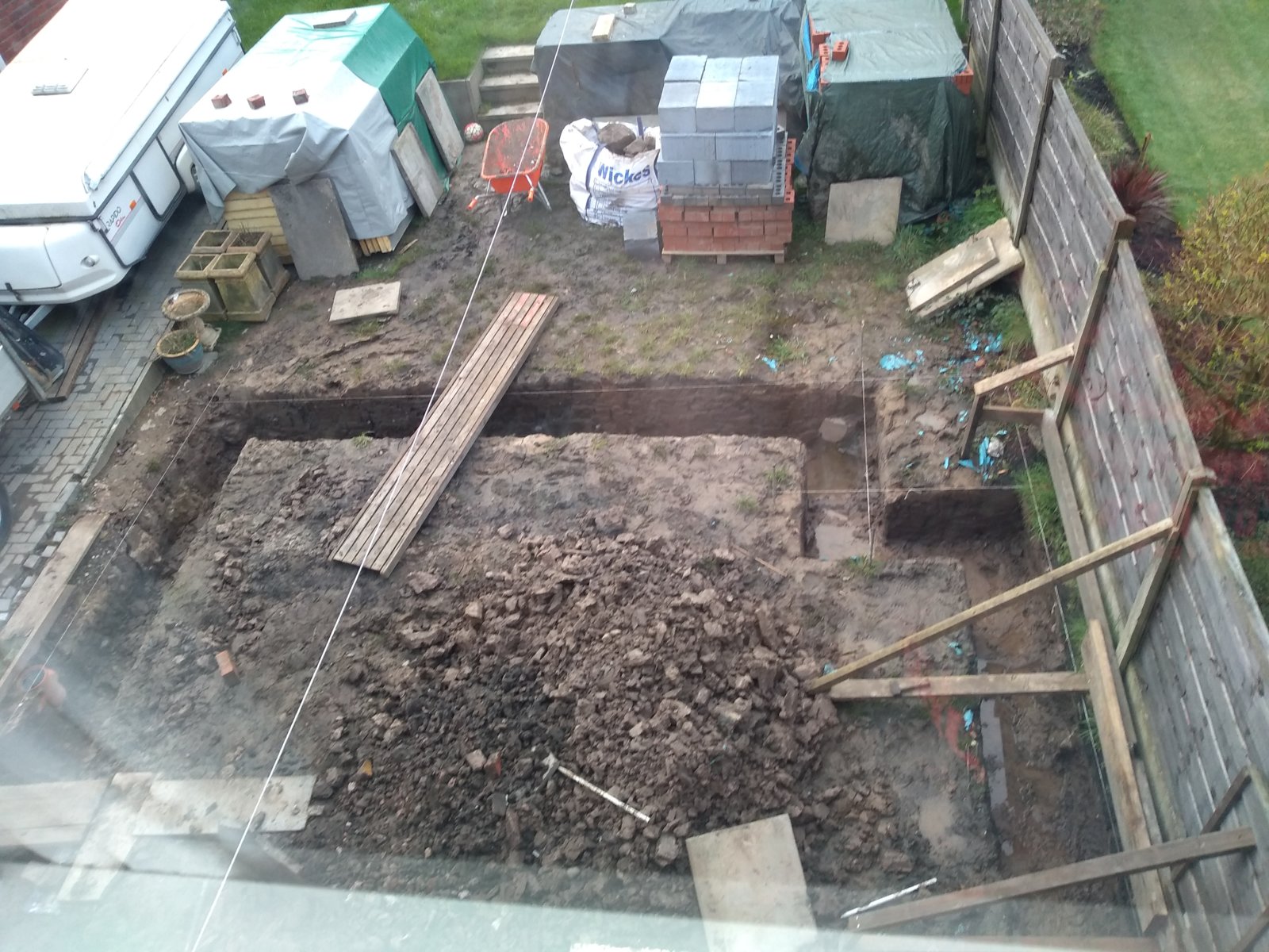

So here's a bit of trench:

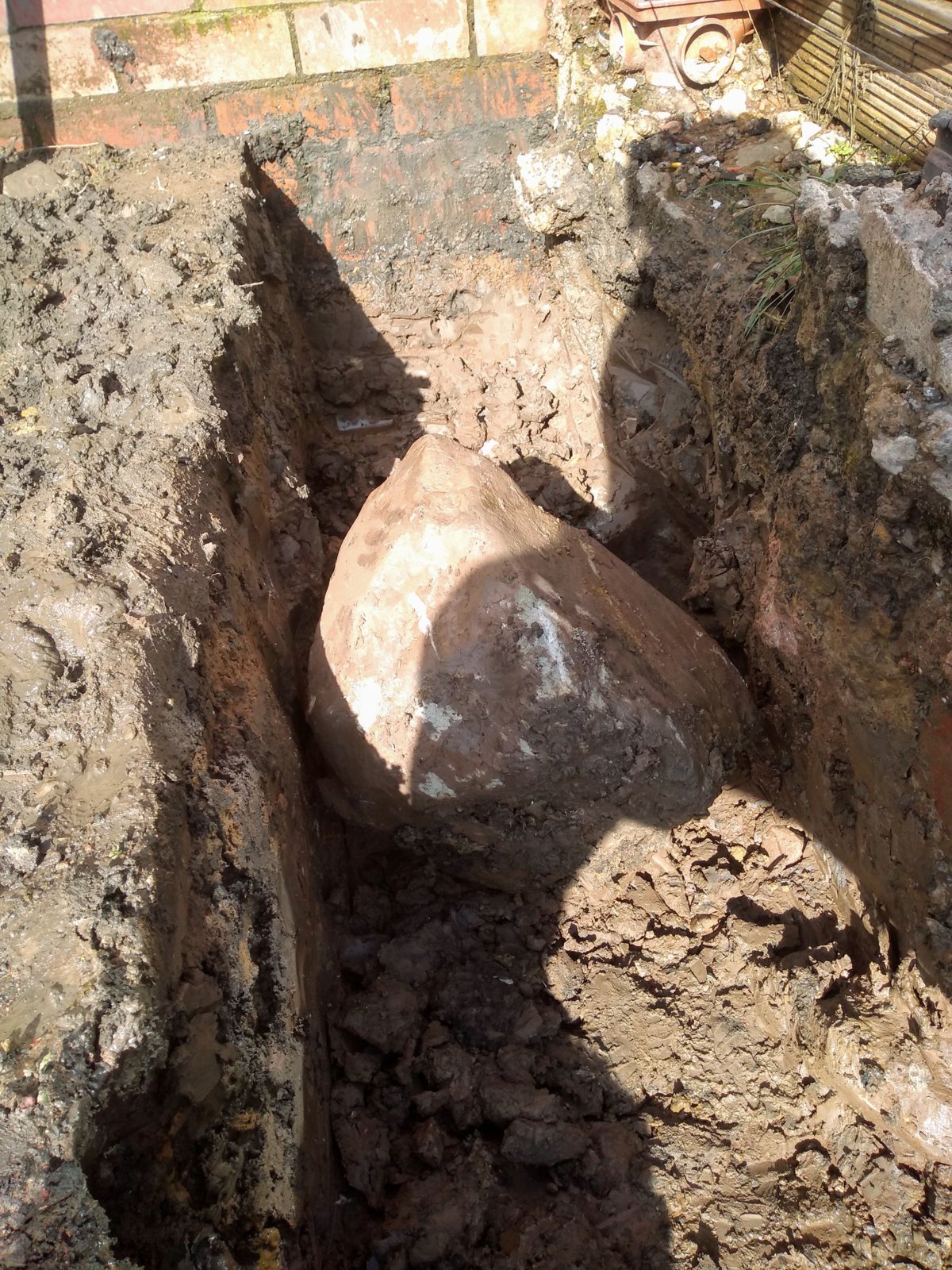

Here's one of the rocks I've dug out (some others were too big and only partially in the trench line so I've had to drill and chisel through them with the SDS):

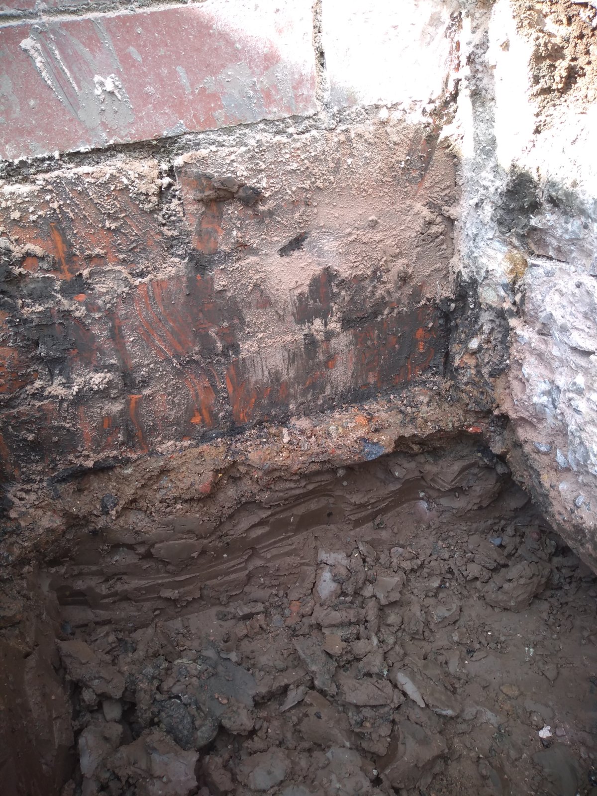

Here are the existing house foundations - 3 bricks below ground level and about 30mm of concrete on clay!
Nice trench!!! Have you got a drawing of how it will look when finished?
Why so deep with footings? you have sound clay just below surface if your into good clay you should be fine. If your in good clay here regs are happy at 2 foot, even if its not clay but its hard. Its more concerning if you in soft wierd crap or in fill, that looks good stuff.
when you happy with depth try make bottom of trench flat it makes concrete stronger wirerd lumps can cause issues with strength,.
(ops just read rest of your post!)
good job just make it flat in bottom (y)

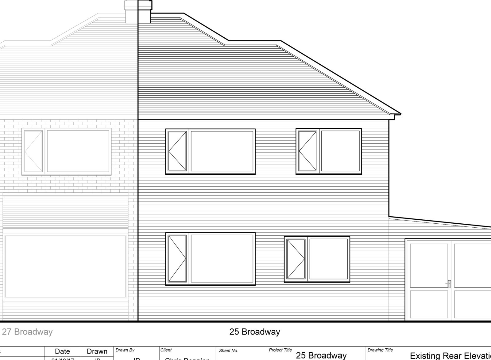

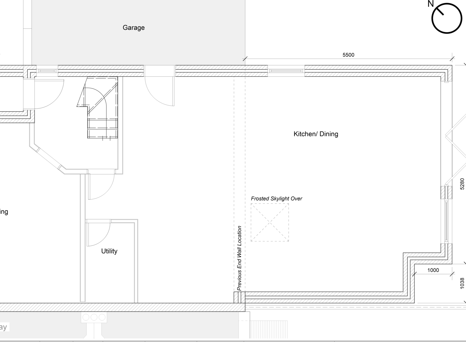

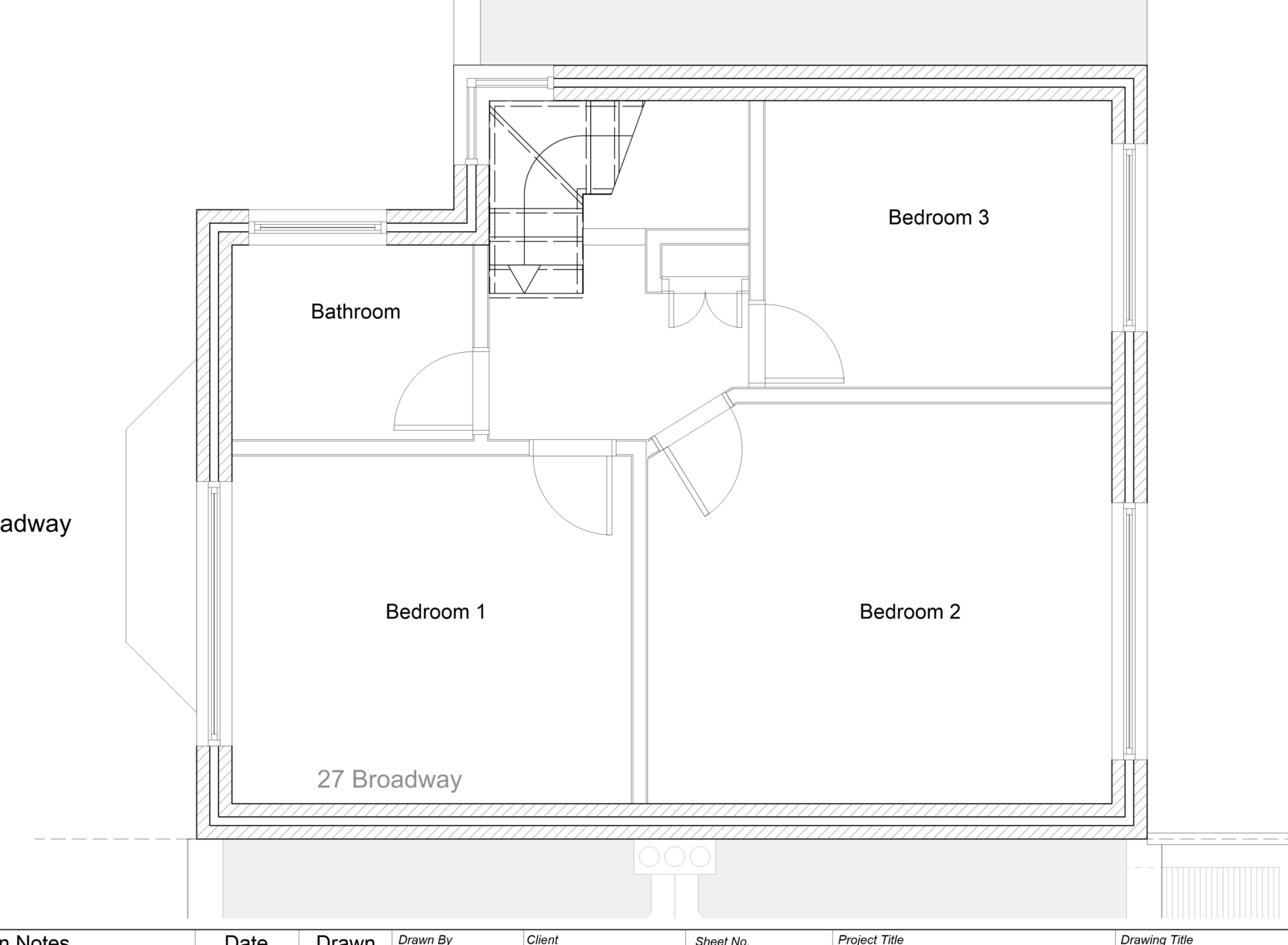

Hi Ian, I only have some basic stuff from the planning app:
Existing rear elevation (the bit at the side with the french doors is a through garage):

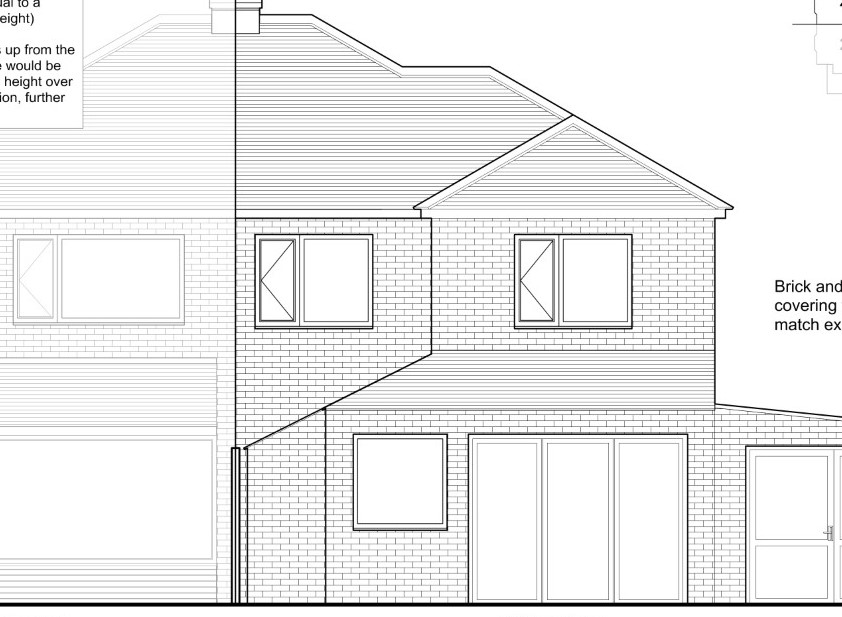

Proposed rear elevation:

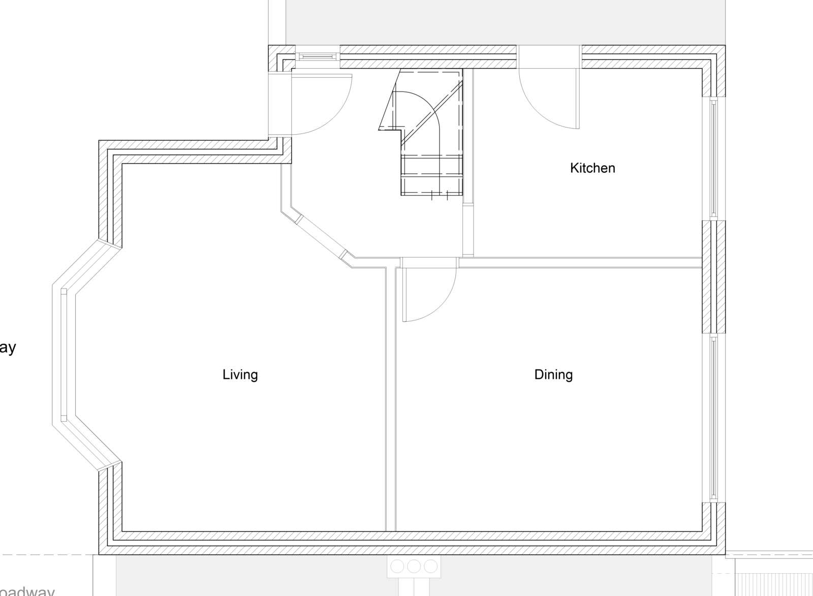

Existing ground floor plan:
Proposed ground floor plan:
Existing first floor plan:

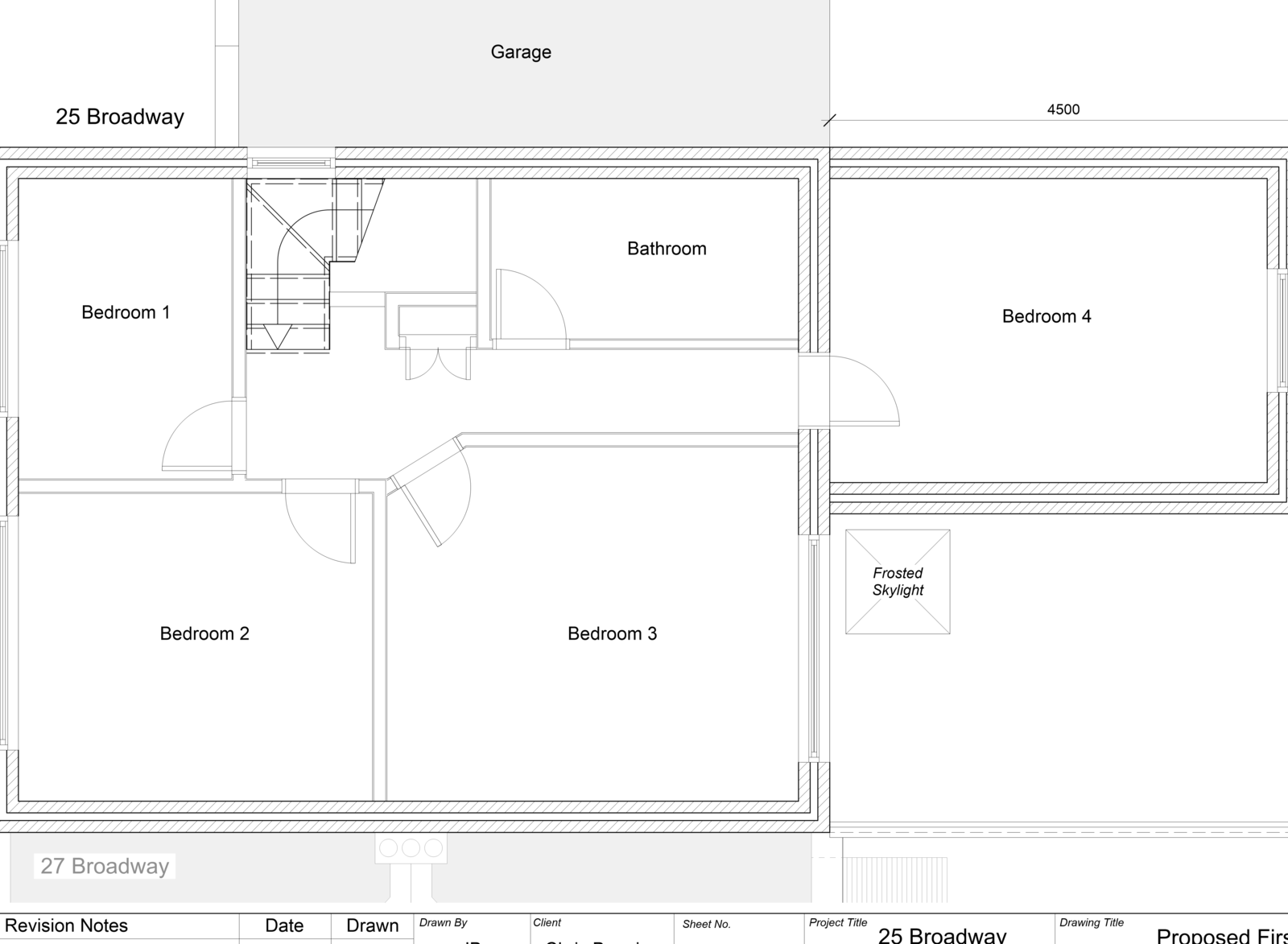

Proposed first floor plan:
We had to make some compromises on the design to get the planning - the left hand wall along the boundary is only 2m high so we'll have a collared ceiling on that side, and we had to chop a metre out of the corner to meet the 45 degree rule for the neighbour. We also need to shift the bifolds over to the left (it's been kindly pointed out that they're too close to the corner for building regs) so will be deleting the window next to them.

you could always move door to you new bathroom to make it on suite, if thats you new master bedroom, works well making that a bathroom/corridor.

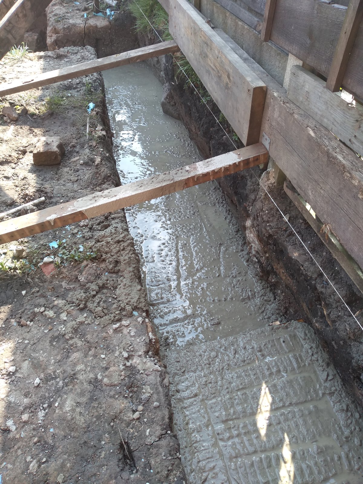

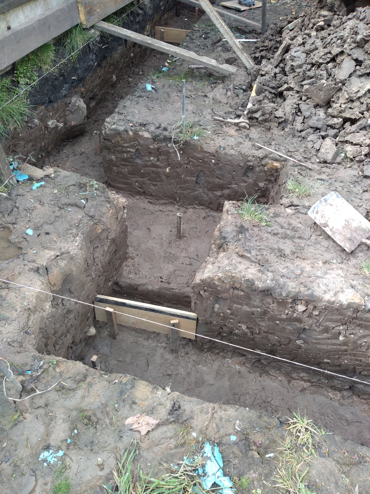

I thought I'd update. Progress a bit slow as the digger has been out of action with an infected root canal! Trenches now all dug out, squared off and staked ready for concrete:

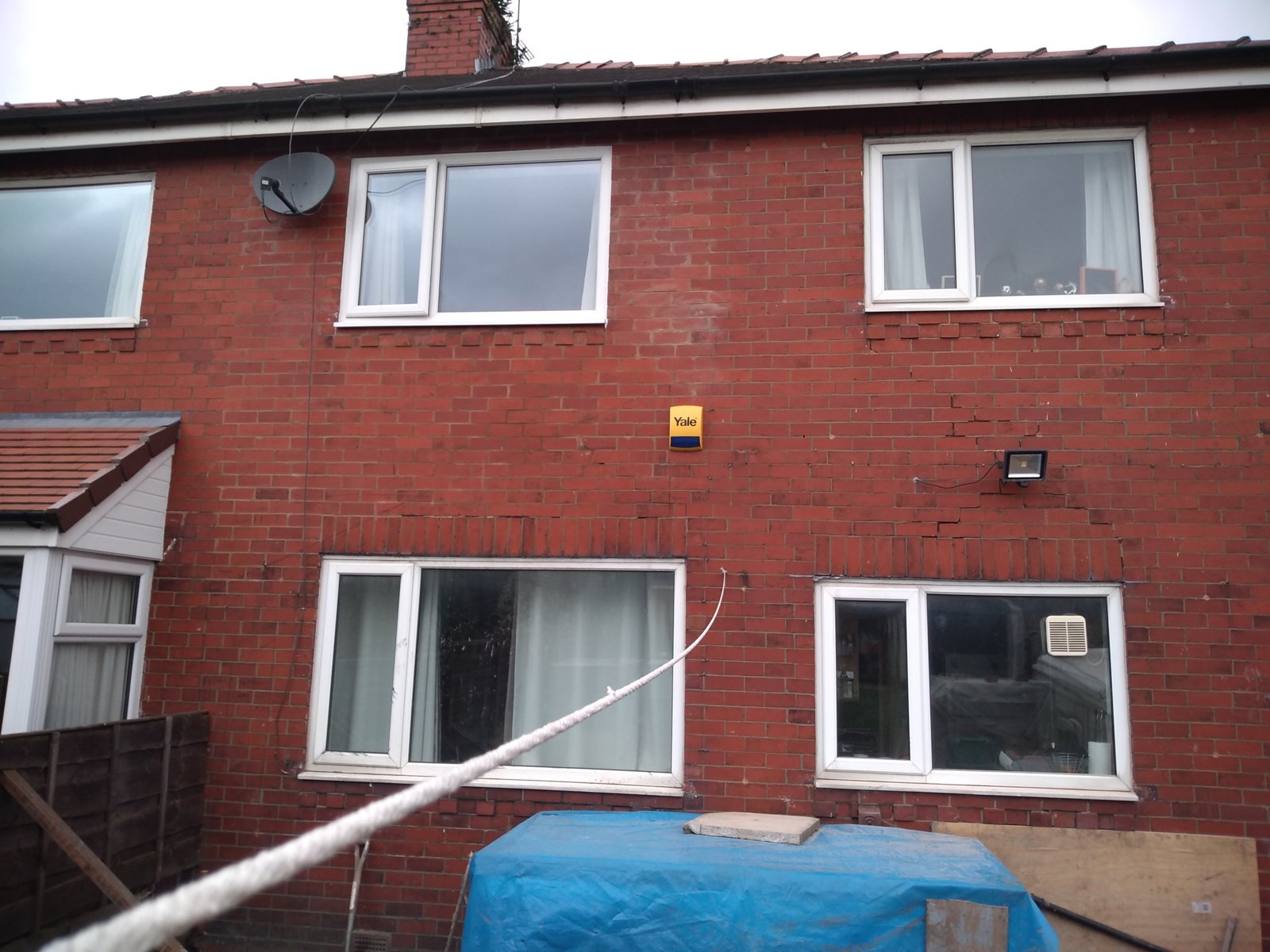

This photo shows the back wall of the house, which is all coming out on the ground floor apart from the bit between the windows which will form a pier to hold up the (seven!) steels supporting all the first floor walls):

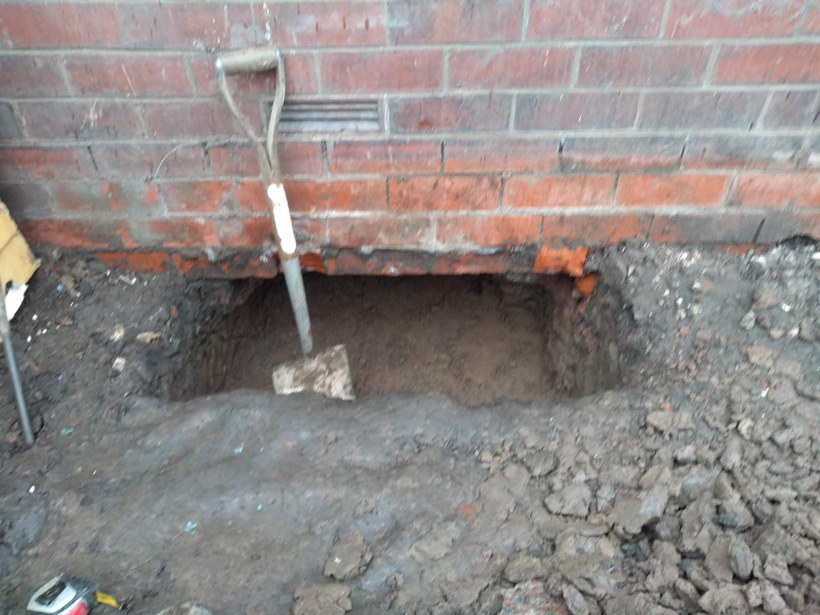

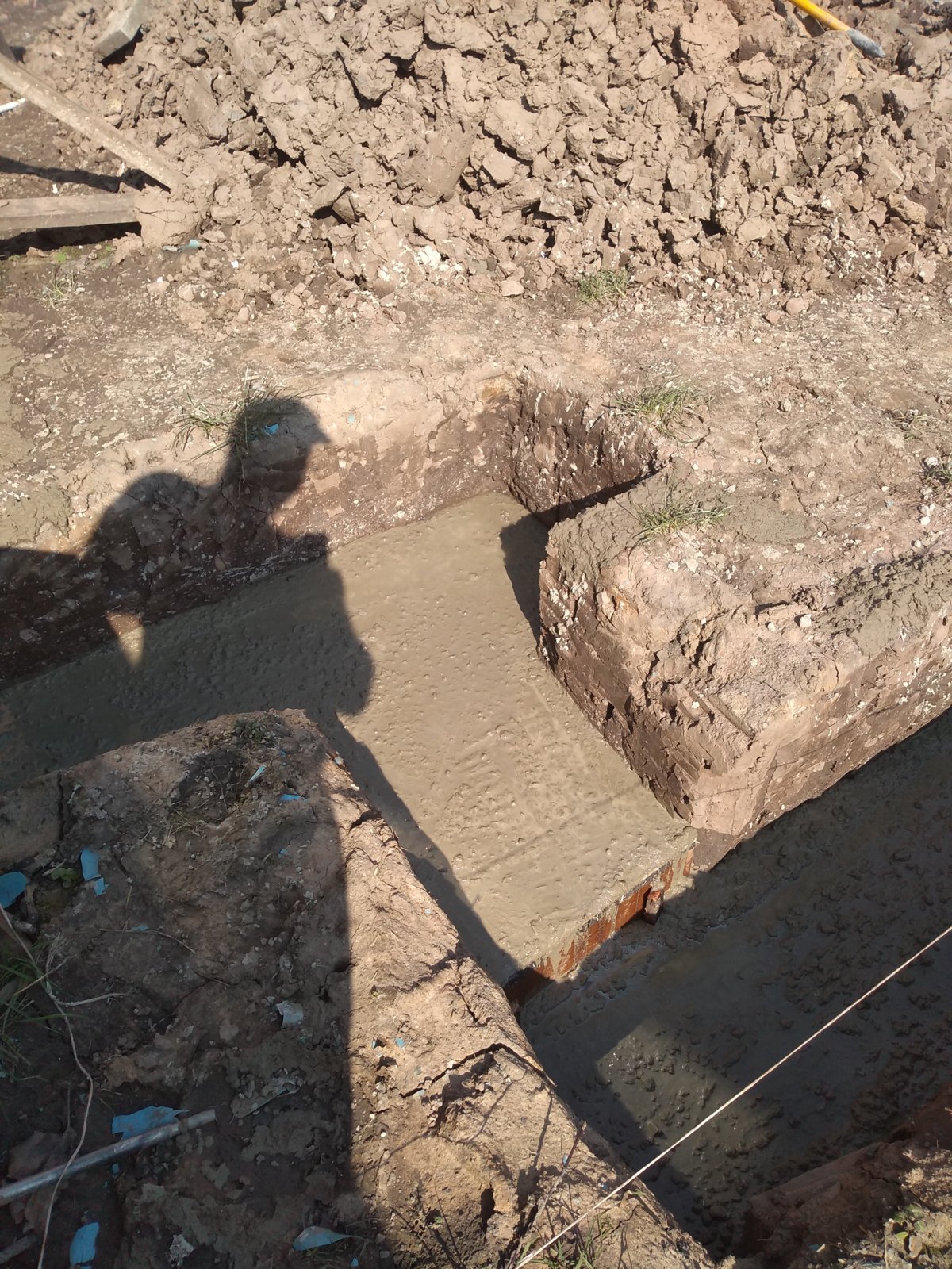

As there isn't much in the way of foundation my SE has specified a 900x900x400 concrete pad to underpin this, so I've dug out the hole:

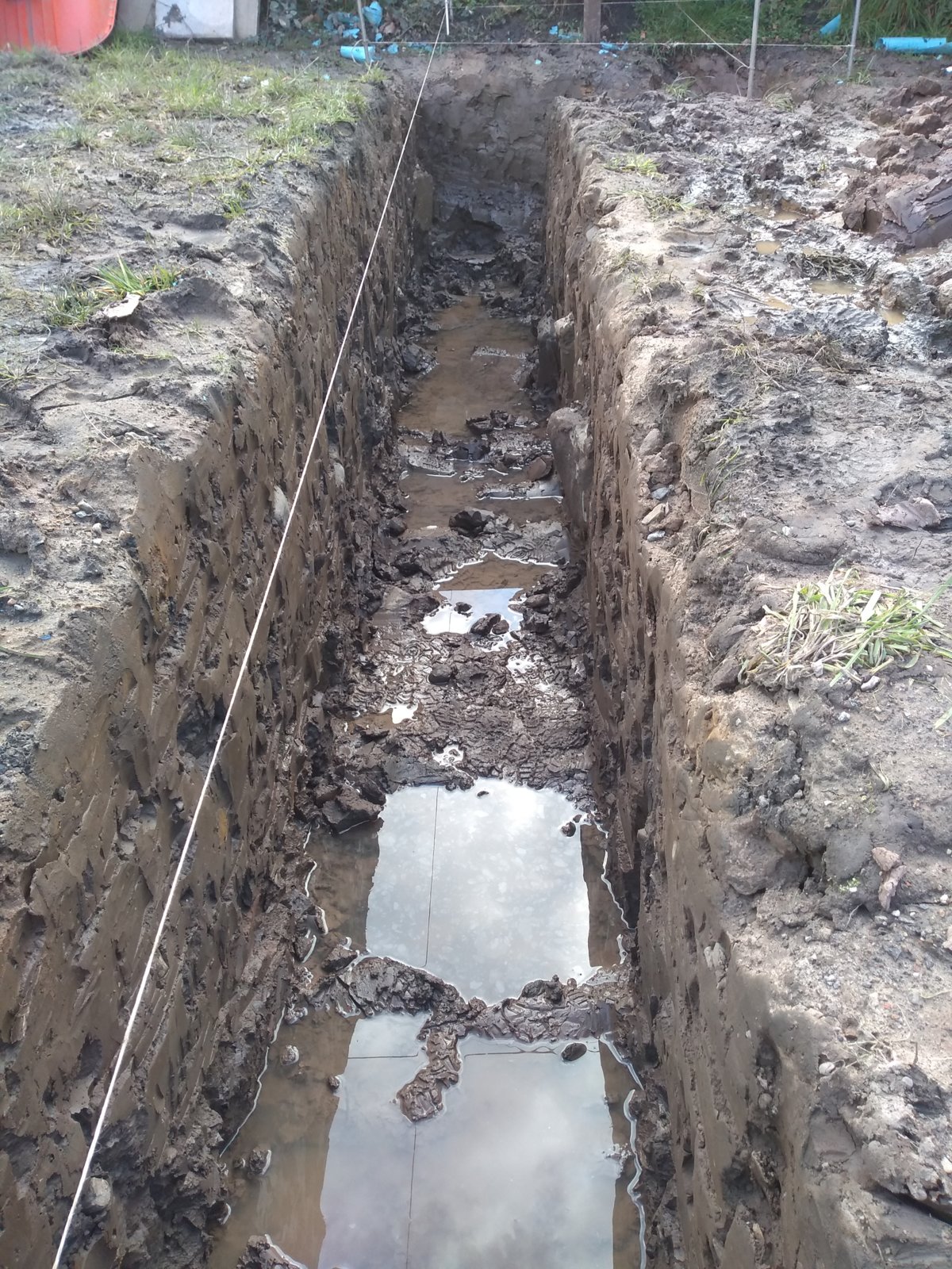

I booked the next BCO inspection for today, it rained all last night so I got up early and spent an hour hoovering all the water out of the trenches with my Karcher wet and dry - an amazing bit of kit for £42!:
BCO was happy with everything and gave me the go ahead to do the concrete. I asked him when I should get him back - he said "when you've got the roof on" which surprised me a bit but I suppose that's a building notice for you - it's up to me to get it right. Anyway he's agreed to come and check the ground floor build up before I cast the slab. Barrow mix are coming on Monday - I reckon between 3 and 4 metres at £138 a metre (much as I like to do everything myself I couldn't mix it for much less).

Looks good nice neat job,
dont under estimate how much concrete you footings will take and how heavy it is to move get plenty of people, wheel barrows showel rakes etc to flaten it out.
also make sure wagon has plenty on to mix.
my neighbours a lemon and had to barrow about 5 cube with no under standing of how difficult this task would be around his whole house..
it was hard enough with 4 of us in a barn floor and the wagon was dropping it into the pad,
my advice get plenty of help makes job much easier.

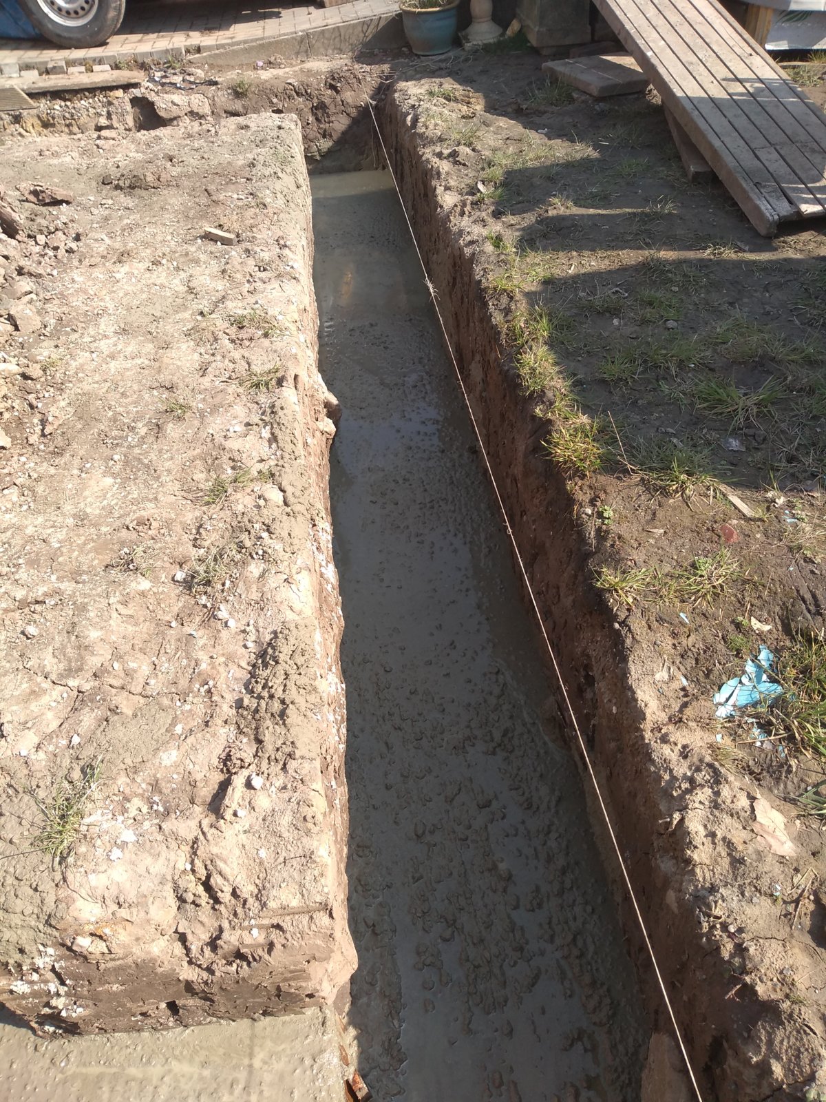

Concrete done today. I was there with my wellies and rake expecting a right slog but it was the easiest thing I've never done. 2 muscular Barrowmix guys with long arms wheeled in 3m in less than an hour, I left it till the water rose to the surface then just raked it about a bit till the "puddle" was evenly spread over the surface. Should be good enough to build off with a thick bed.
It cost £414. To mix it myself would be 6 bags of ballast @ £40 plus 40 bags of cement @ £4.50 = £420 plus 7 trips with my trailer to get the stuff - it's no good getting it delivered as they just drop it on the grass at the front - I can just about reverse my trailer up the driveway and through the garage with 1 jumbo bag in it.
After the holidays I'll start building up to dpc. Because the adjacent ground level is so high I'm surrounding the perimeter of the extension with acco drain so I need to think about how that will work - I'm thinking of backfilling the outside of the trench with a weak mix of concrete (mainly consisting of the hundreds of stones that came out when I dug the trench) and sitting the channels on that.
Aahhh! This takes me back. Looks good so far. Surprised at how little concrete has gone in there.
A nice tidy site too. A tidy site is a happy site. I never got the hang of that.
Keep the pics coming. It’s great to look back on.
