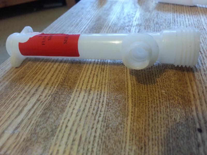

First many thanks to all who contribute to this forum. Your invaluable help has enabled me to diagnose my flooding shower has having blown a pressure relief device. Below is a lic of the outlet pipe showing the ball missing from the prd! Its a gainsborough 8.5v Stanza btw

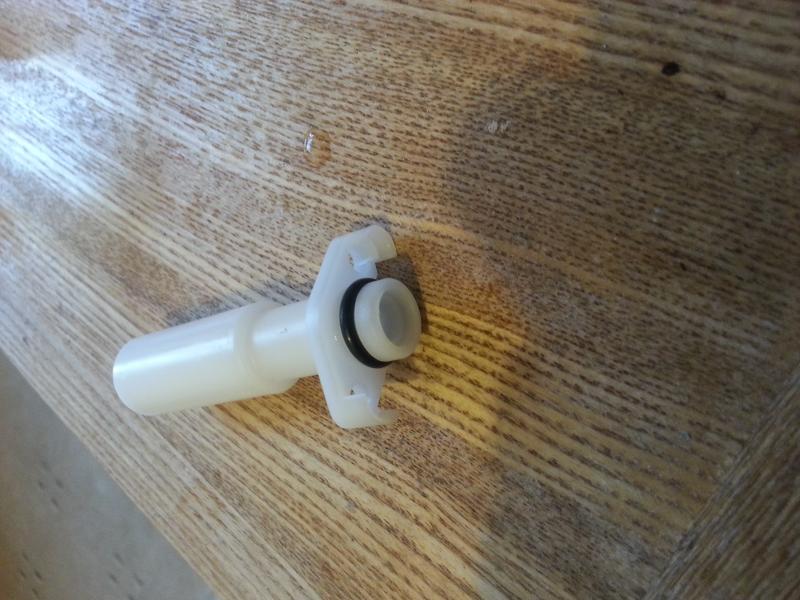

However when i opened the shower to hace an initial look this piece fell out inatrached to anything.
This is a mystery to me. Shower seems to flow without it. Anybidy on this greay forum have any idea what it is?
My guess would be that is there to flush he pipe work prior to commissioning. If I'm right, what a good idea from Gainsborough.
You can test the pressure at the outlet, the long bit is for connecting a hosepipe to - just guessing :LOL:
