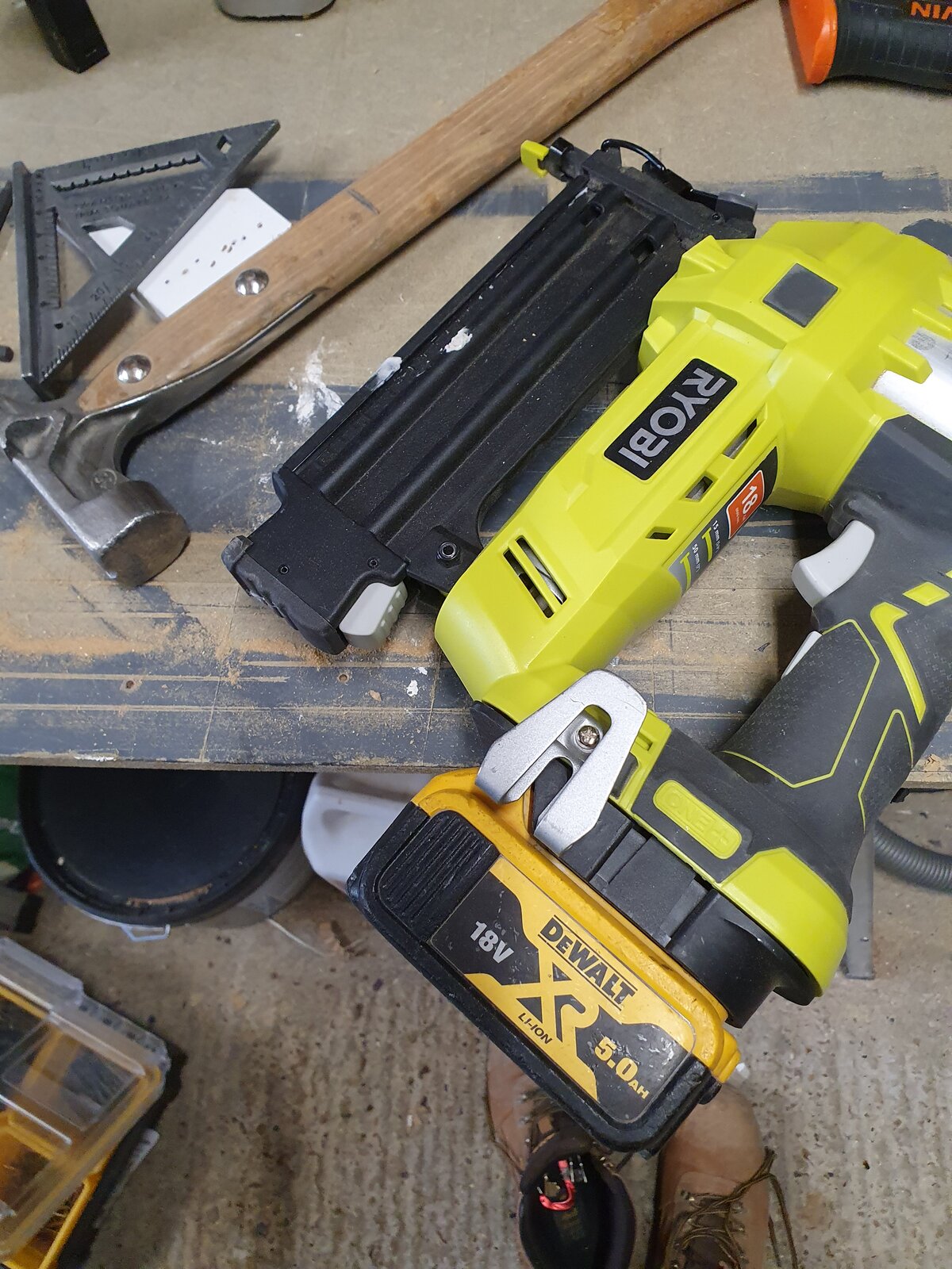

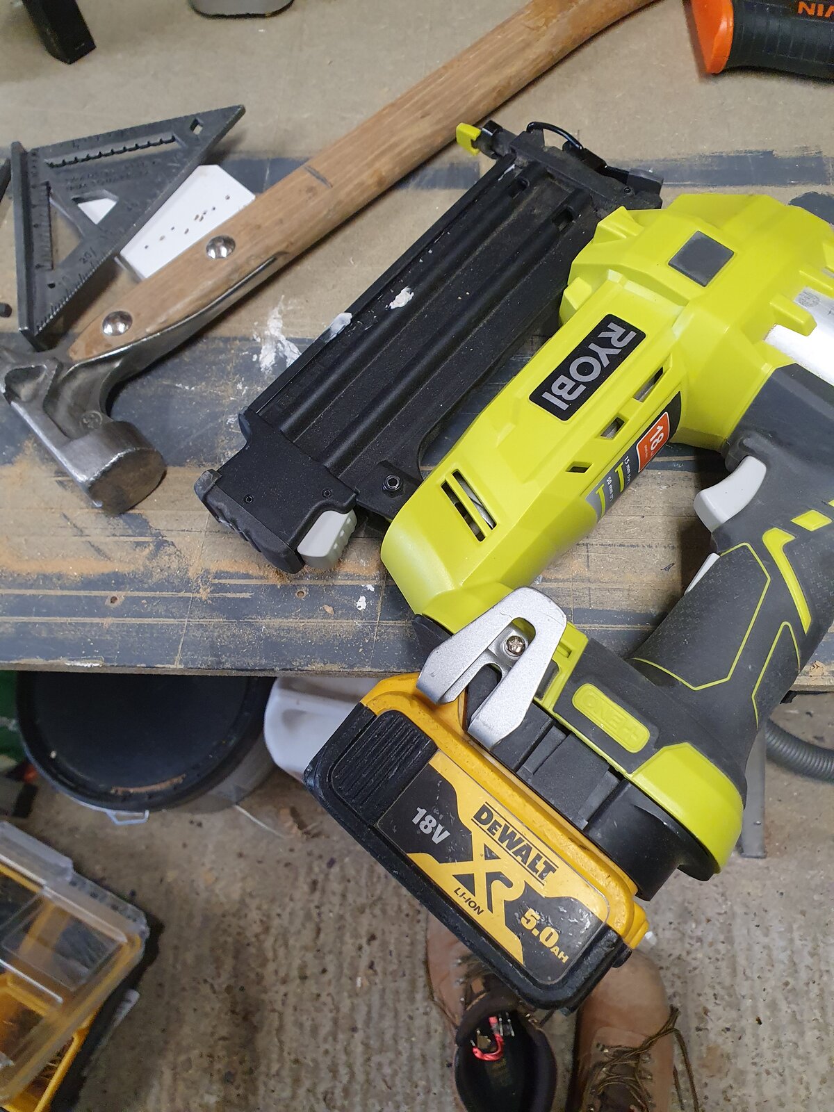

You're be surprised what a 16g nail will hold but some of the cheaper options to look at is Ryobi nailers I had a couple of jobs that I needed a 18,g nailer for a didn't want to pay paslode money
so brought after good feed back a Ryobi 18g nailer and was I surprised yes great little gun so look for one of there first fix nailers
i have both the ryobi 18-16 gauge nailers and yes they are brilliant and getting nails out is very near impossible ----bbbuuuttt---the heads are too small and wet wood has a hell off a lot off pull and about perhaps 5% off nails wont have enough resistance
now angle nailing will have a bit more resistance as the actual nail length at the angle will be about 25-40% more dependent on angle and nail will have to bend to pull out giving further resistance
and another trick, if a plank starts to lift tap it back flat as you can with a hammer then holding in fire 2 nails in a "X" pattern they will tarnish and match in as the wood greys ---- how do i know this ---frustration and trial and error ;)

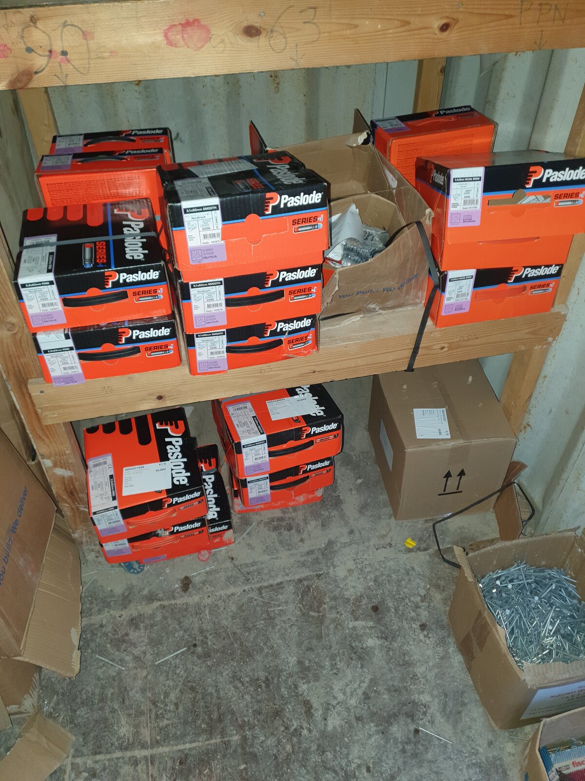

Talking nails an cladding I'm out of 51mm ;)
