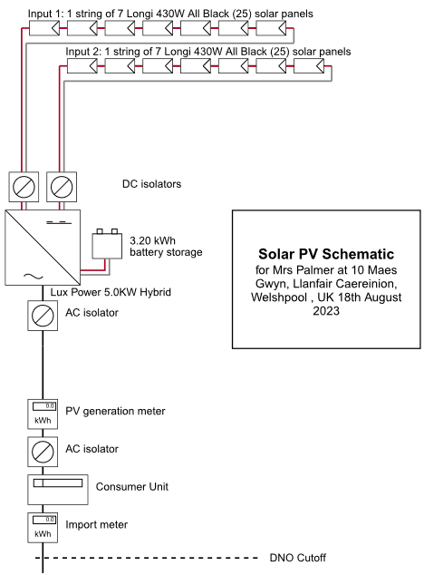

The pack has a lovely schematic diagram 1697795995157.pnghowever I have 5 UPS outlets which are in the kitchens so that's a special location in Wales. And to need to turn off both battery and isolator seems wrong.

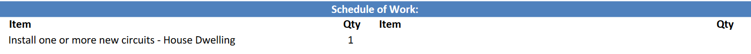

And there is a option to complete 1697806888773.png but no details, they fitted one I watched them do it, again special location as out side, but no details. Do remember I live in Wales.

The building regulations notification only has the very brief description of the work - that's all that can be put there, it's just a short list of predefined things to choose from. No option to add any extra information.

I am sure there will be not problem, and the workmanship seems good, the only think I am not happy about is no way to switch and lock off the UPS supply. I don't like trusting a push button to turn it off. I feel I should be able to lock off, even if only using a cable tie. i.e. it should need a tool or key to turn it back on.
