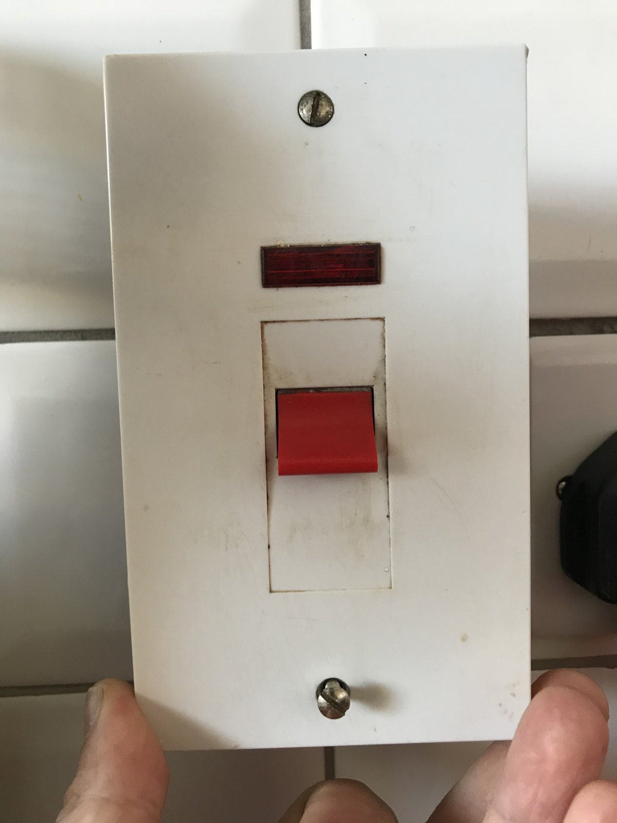

i just bought a new single electric oven, but this one comes with a 13amp plug fixed. Previously my oven was connected to a junction box along with my electric hob, and connected to an infused cooker switch. The fuse in my fuse box for this circuit is 30amp. How can I install a 3 pin socket on this circuit next to the fuse jox for the hob on this circuit? Is there a combo box I can get that will allow my to keep the job wired directly in but also has a 3pin socket?

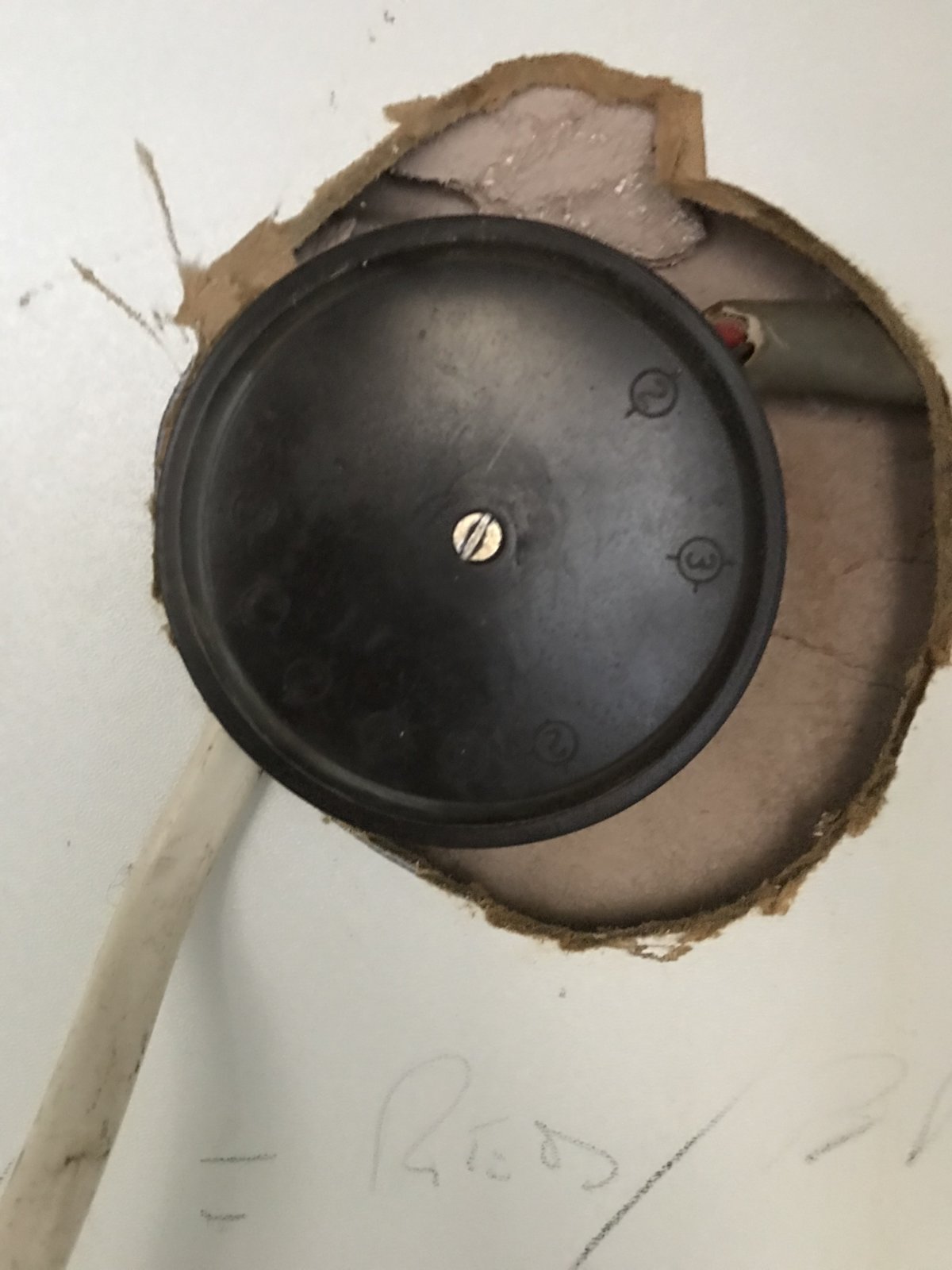

Replace the rouind JB with a twin cooker outlet plate
One outgoing cable to the hob, the other to a socket.
Where is that JB in relation to the switch? There are rules for where concealed cables are allowed to be run.
The JB and the switch are on the same wall, about 70-80 cons apart. The cable goes into the wall from what I can see.

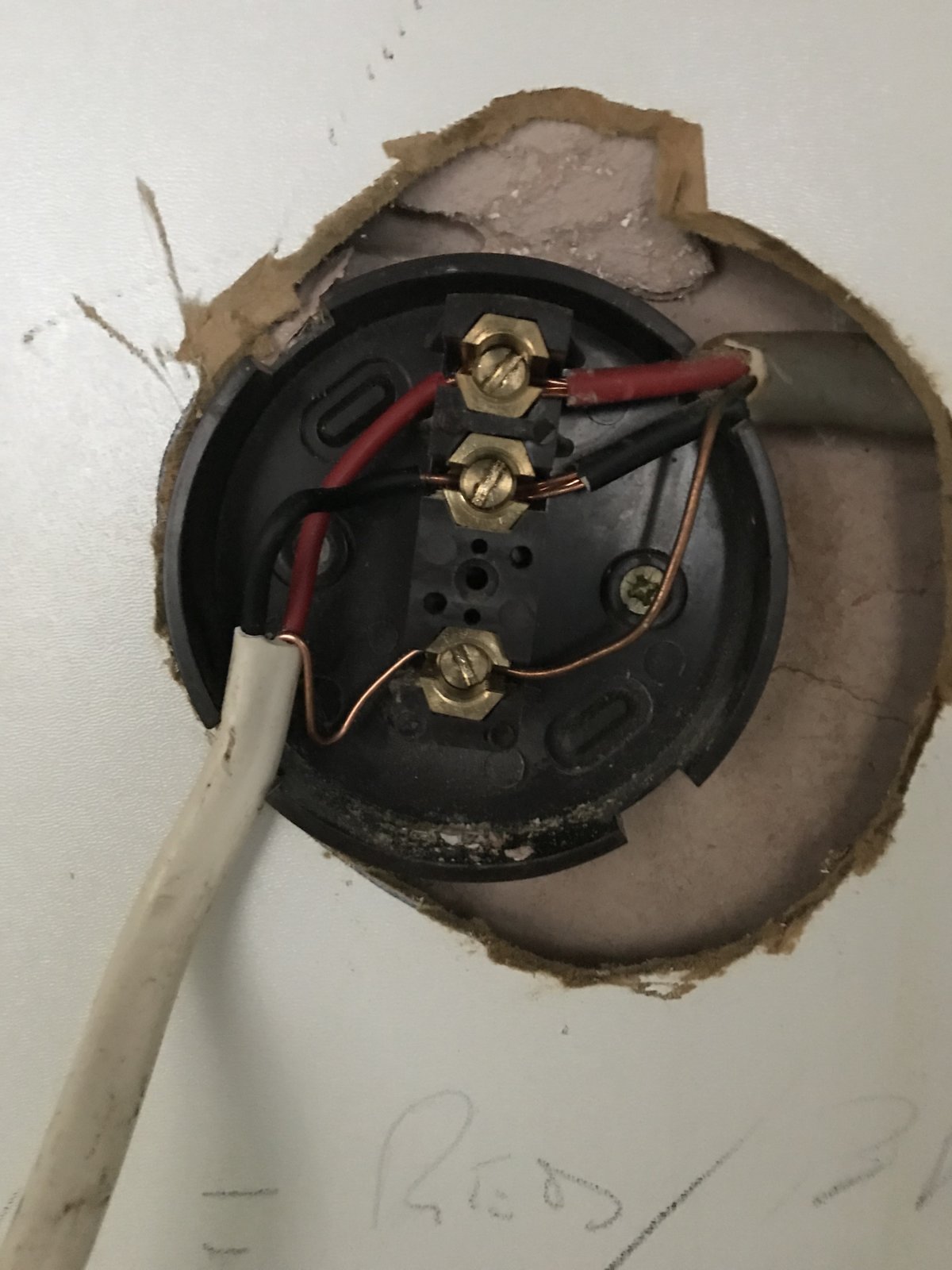

TAKE A PICTURE, WITH THE POWER OFF, OF THE JUNCTION BOX WITHOUT THE LID.
This will confirm to us that the grey cable on the right actually is 6mm2 cable.

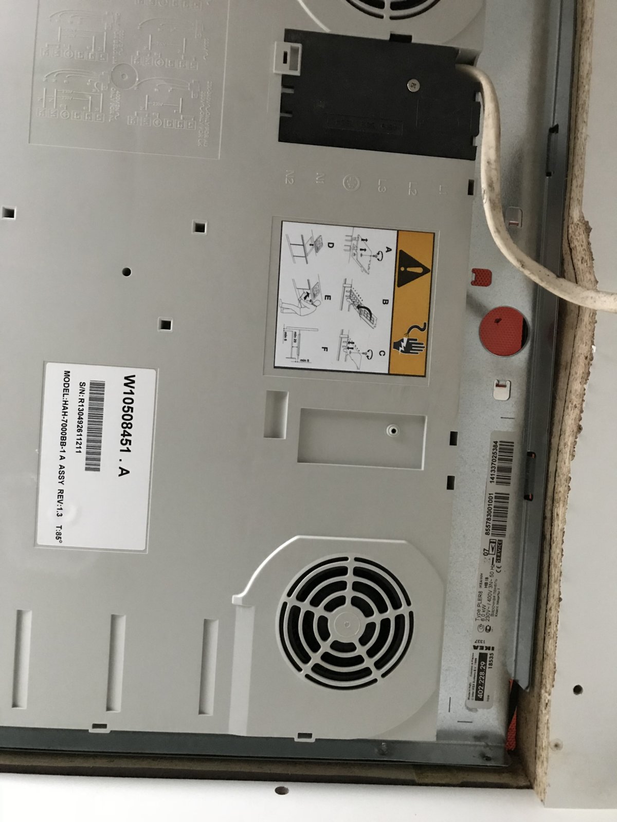

We also need details of your 'electric' hob. That white cable looks incorrect at a glance, so hopefully we can prove otherwise.

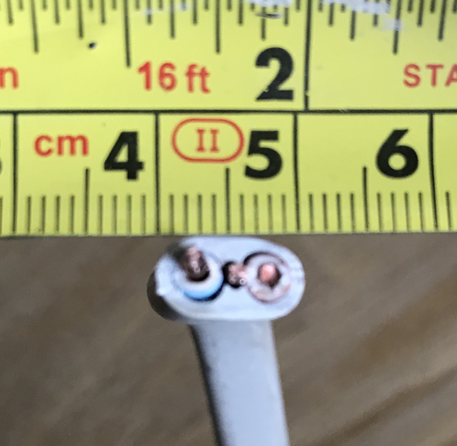

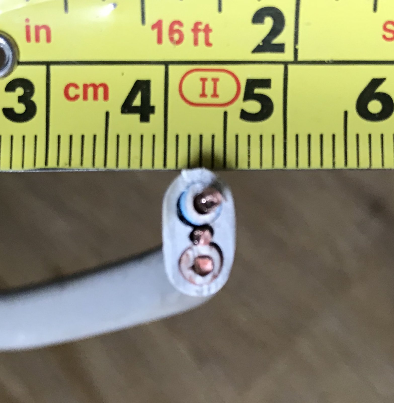

Here are the pics of the JB cover off, and the underside of the hob. Also the measurements of the cable I have, which I think is too small.
Note! I did read the wiki article. I didn’t install anything that is currently there. Judging from the angle of the cable, it’s not running diagonally.

Ok. First of all, that is NOT how you measure cable size.
The cable on the right of the junction box is 6mm2, so that is good.
The cable on the hob is ropey.
Can't make out how powerful the hob is.
Is the hob all electric?, is it gas, or definitely all electric?
You may need to upgrade the cable on the hob.

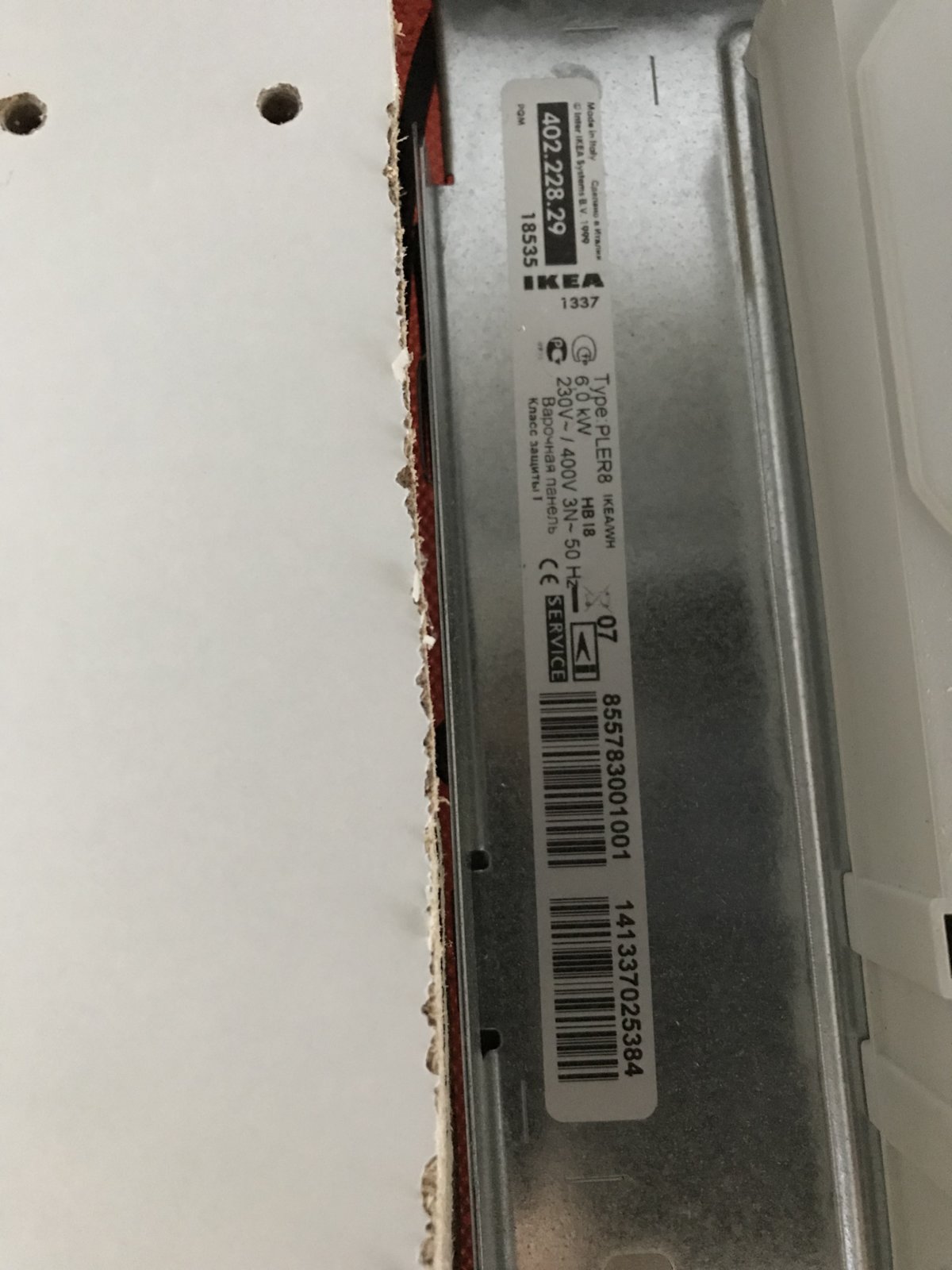

The hob should have a rating plate or label, which states how powerful it is in W or kW. We need this.
Yeah the hob is 100% electric, induction hob, bought from ikea and that is the cable it came with. It’s been installed for around 4 years.
The hob should have a rating plate or label which states how powerful it is in W or kW. We need this next.
Sorry the image didn’t attach with my last post. Looks to be 6,0kW

Ok, that sounds right.
The white cable on the hob is woefully unacceptable. It is undersized, and not very flexible as the red and black wires are solid, not stranded.
So, you need some 6.0 mm2 twin and earth cable.
Forget your cable measuring technique. You do not measure cable in that way. You will have to ask at whichever shop you go to for 6.0mm2.

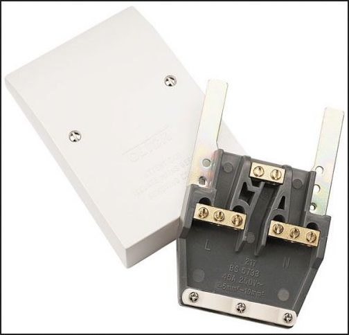

Now you need a new junction box. That twin cooker outlet you were shown is ONLY suitable if it has a back box fitted to the wall. Which you don't appear to have, unless it's hidden somewhere.
Alternatively, use a 60 amp junction box, which are usually an oval shape. Click make them.
