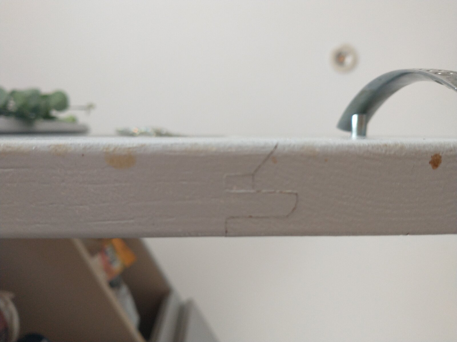

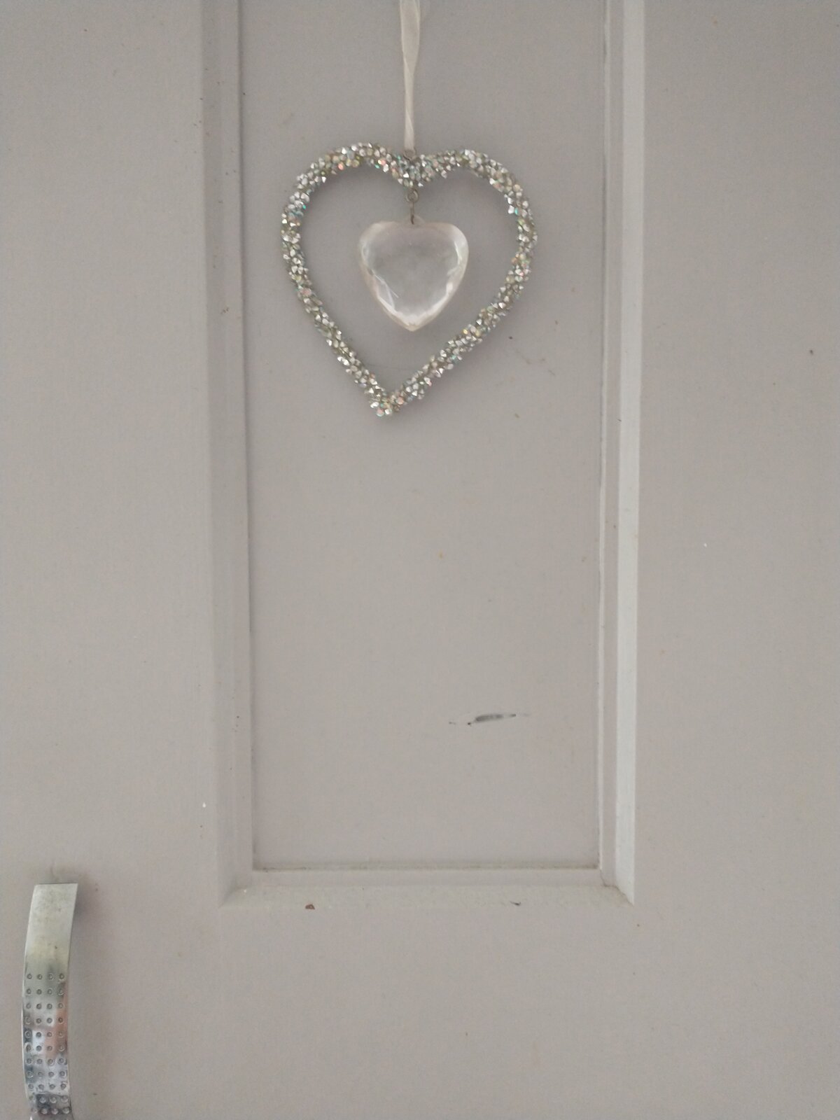

Wanting to find router bits so I can make some kitchen doors. I extended my small kitchen 5 years ago and one thing or another I just hadn't put the extra few doors on. Now, I think I'll do it before it turns into another 5 years lol. I prices about for 7 new doors and was getting quoted over 1000euro. At these prices in these times I think I'll make them up myself. I have the tools and skills to make them , I just need the same or similar bits now.
The doors are oak however I painted them when extending my kitchen. Now that the timber is painted, I am thinking of using cheaper pine and some birch plywood for the new doors. What's your thoughts on this?

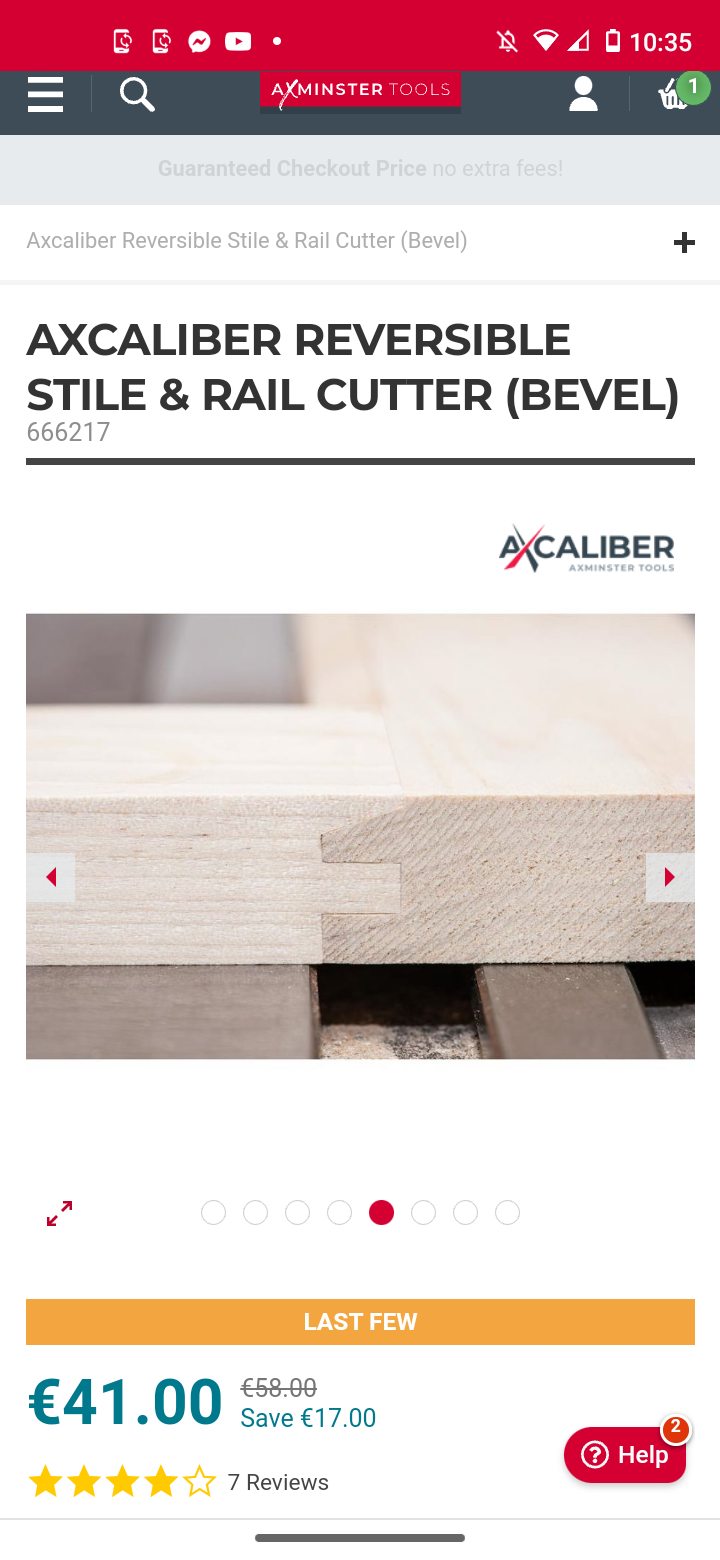

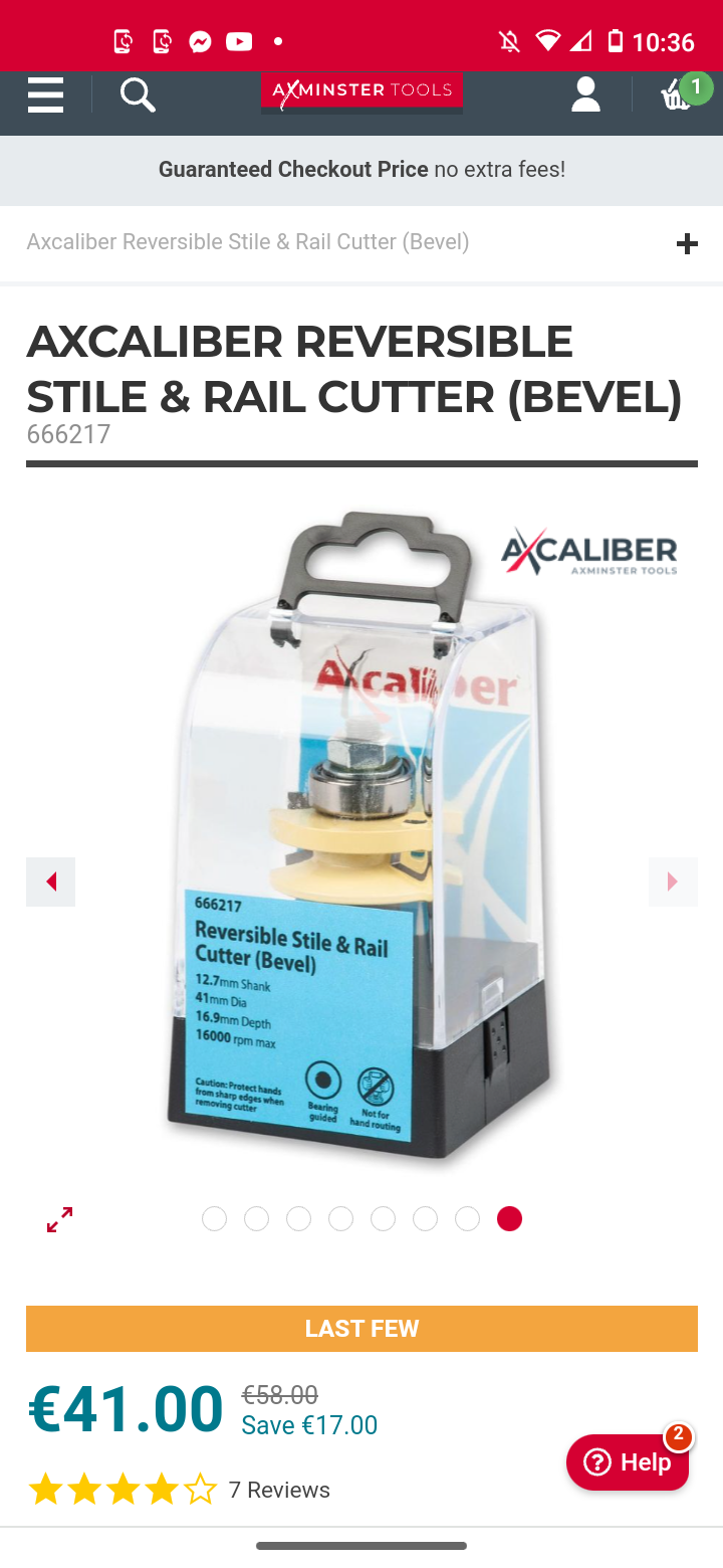

I found this reversible router bit very close to what I need. I might just go for this one and some planned 5x1 and see how I get on. TBH, I think they will be ok. I'm not thst fussed about them being exactly the same and who even looks at kitchen doors for all them to be exact anyway.
the angle will be half at around 22.5 compared to 45% and you wont have an around 4x8mm step so quite a visual difference that may be reduced by a bit off around 4x8mm planted on ??
