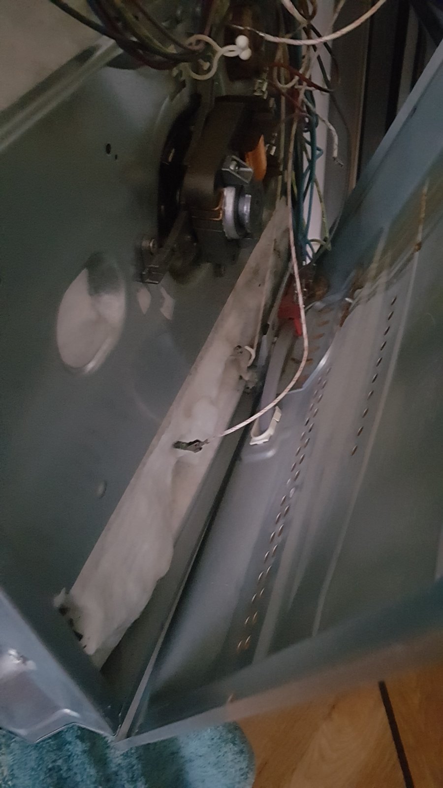

i have a neff oven that has been working fine for 3 years. top oven all works fine.
bottom oven I can choose from fan grill etc with the dial but as soon as I change temp from 0 within a few seconds it trips the rcd.
I bought a new bottom element and still same issue. don' think there is anything wrong with old one as multimeter shows continuity.
took thing apart and even swapped thermo from top oven with bottom and still trips so must be a bottom wiring issue?

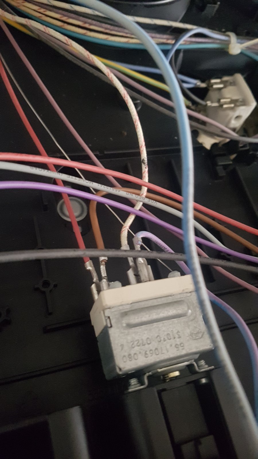

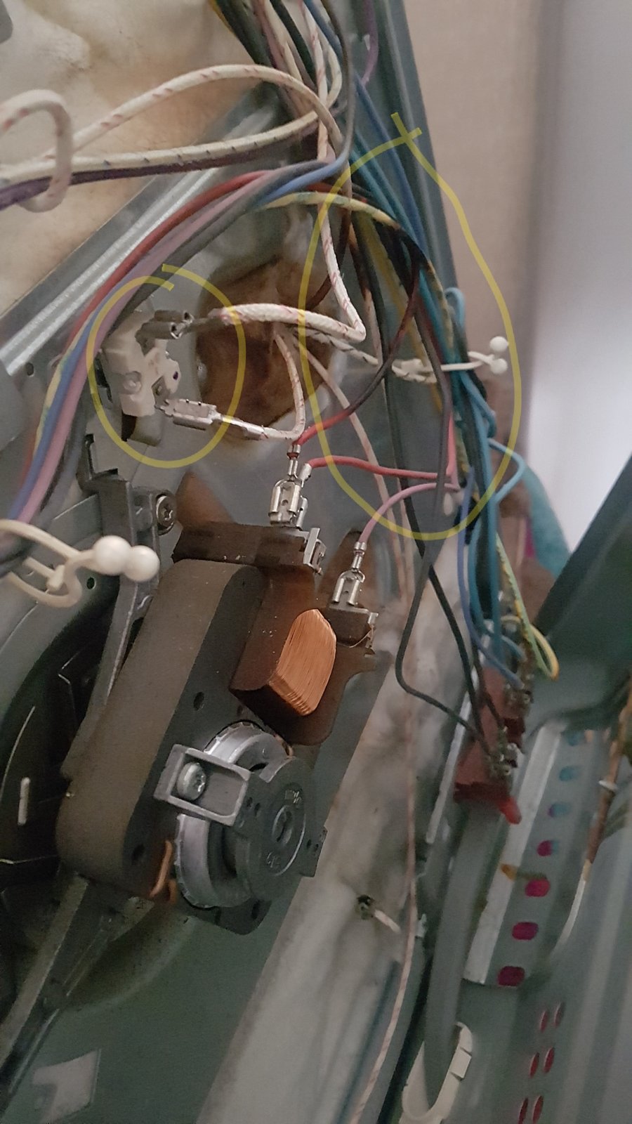

there are 4 wires coming from the bottom thermostat dial. process of elimination I removed each wire and flicked power back on. it only seemed to trip when the red and white lead was connected - I followed this lead and it goes to where the bottom element goes into a small unit which I'm not sure what it is. on the image it is near the top with the red and white lead going into it. I put multi meter on this unit and it seems to have continuity.

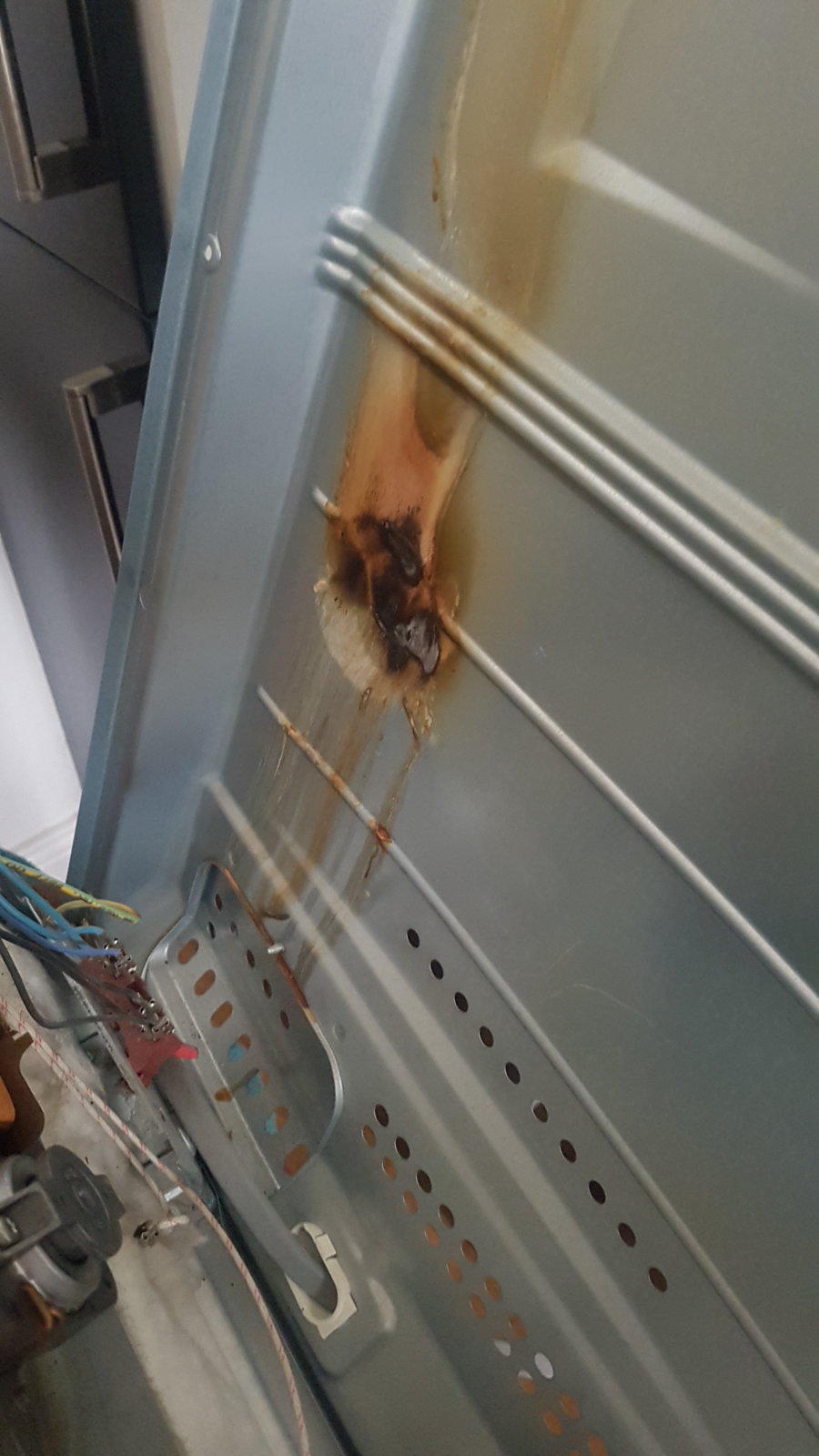

I did notice behind this area above, the back plate is burnt / marked
all cables looked attached properly and none were frayed but some look black from the above
just to add I done all the tests without the bottom element attached. as it was tripping with or without it. assume if it was the element and I removed it, it shouldn't trip?
please see images attached if they help
thanks in advance really appreciate it!

live and netural not connecting through switch at exctley the same time ,,,,,,,will cause rcd to trip ??? unbalanced load but with element diconnected its a wiring fault or that box ,try turning off and unplugging all other euipment on that circuit at fuse box

The brown staining is just cooking fumes escaping and not unusual, does the main oven have a fan element as this would be the most likely culprit.

Unlikely to be thermal cut out, you do have a fan element on that model it surrounds the fan blade and has electrical connections on the back.
Connect everything up apart from the fan element and see what happens. If no tripping then connect fan element and tripping will come back if it is the fan element.

The cut out on the lower oven prevents fan element overheating if oven fan fails.

a wire goes from bottom thermostat into thermal cut off. then another wire from thermal cut off has 2 spade connectors - 1 goes into bottom element which I have removed and the other part goes right into the bottom of the oven where a prong sticks out and is covered in insulation. is this just an earth?
when I remove this above lead from thermal cut out it doesn' trip.
