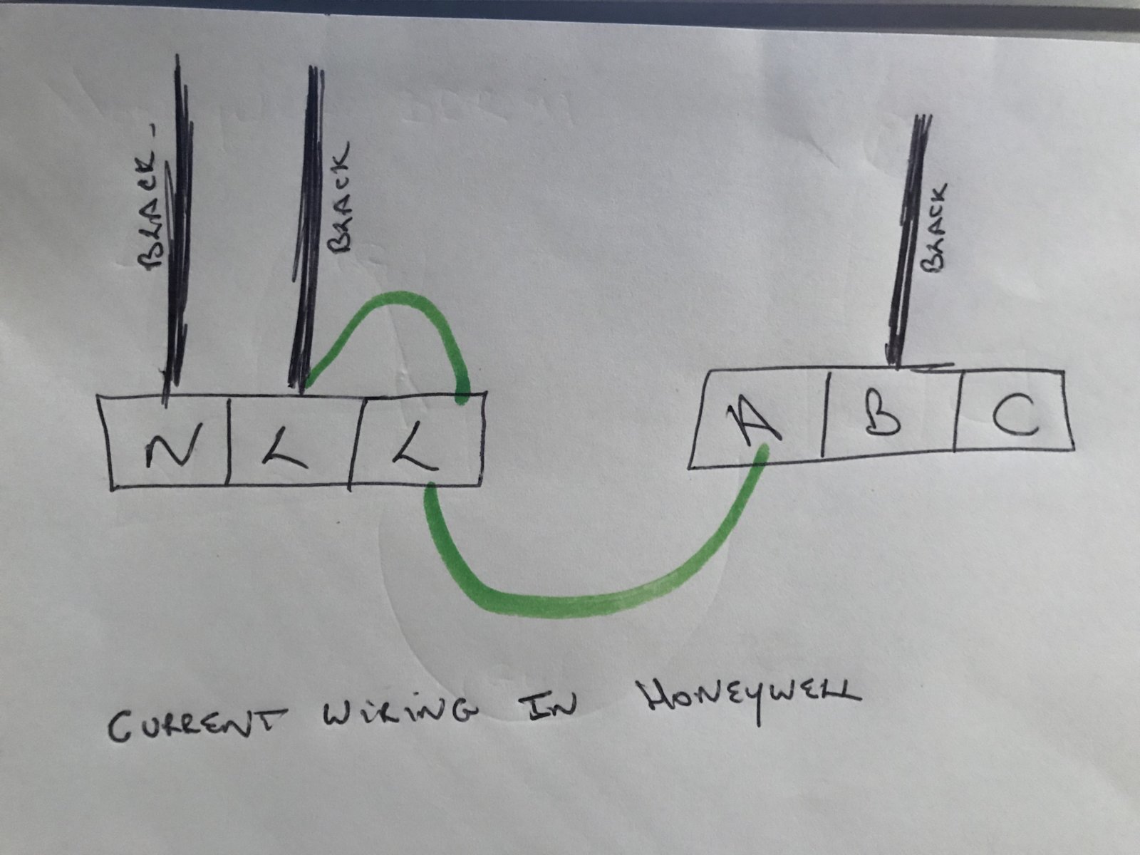

Hi
I have a Vaillant ecoTec Pro 28 combi boiler which currently operates with a Honeywell wireless programmer and a Honeywell BDR 91 relay box. I'm thinking of replacing the Honeywell controls with a Nest 3rd Generation Thermostat and trying to determine whether or not i need to get it installed professsionally.

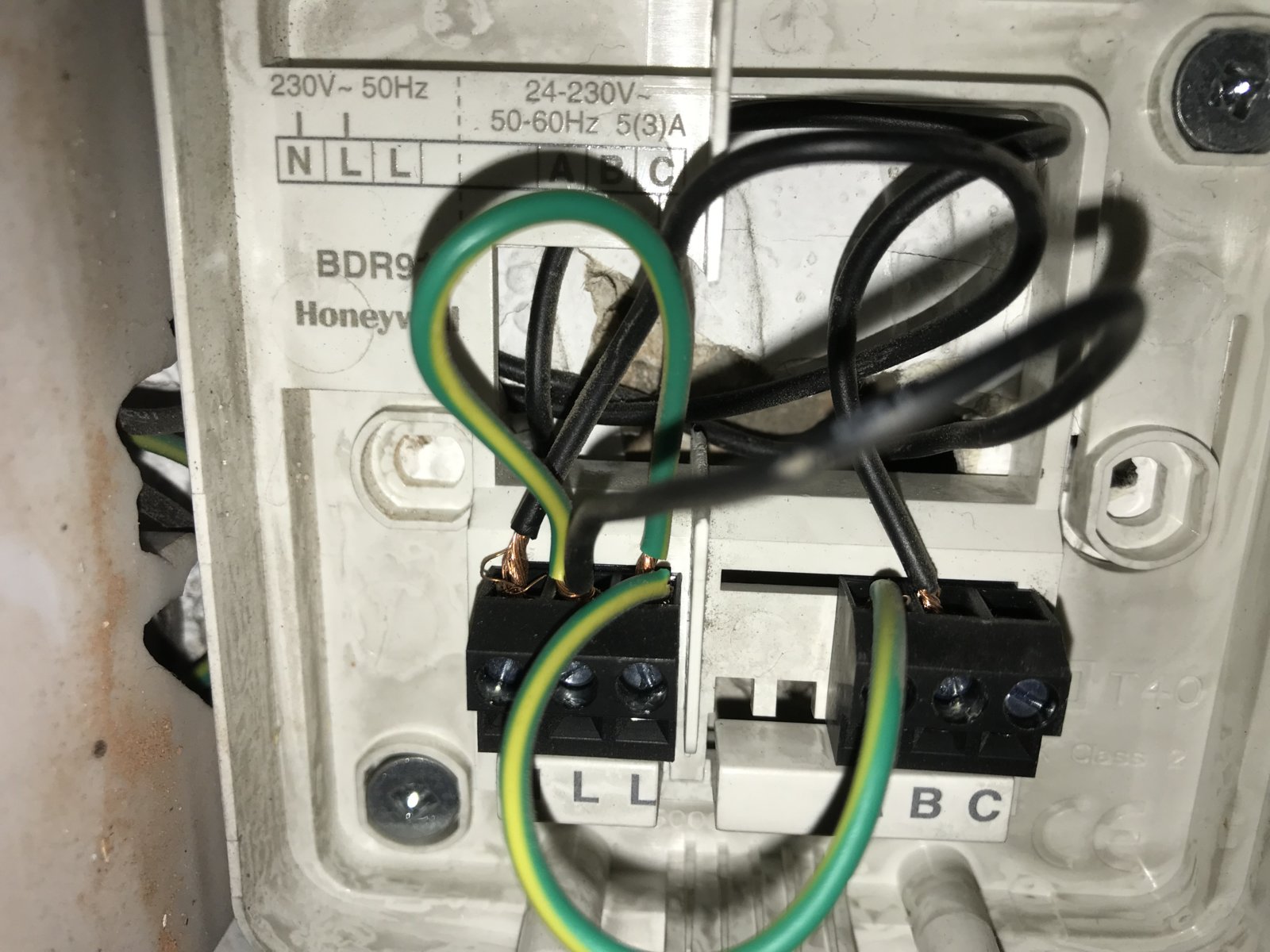

I have looked at the wiring in the BDR91 and note it is wired as follows :
1 Black wire connected to Neutral
1 Black wire connected to Live (middle in photo below)
1 Black wire connected to B
1 Green/Yellow wire connected from Live (middle) to Live (right)
1 Green/Yellow wire connected from Live (right) to A
(I assume that although the electrician that originally installed the Boiler and Honeywell system used Green/Yellow wiring, they are not actually earth cables and that he should have covered them with the proper colour tape so that they could be correctly identified).
The 3 black wires will i assume simply connect to the Nest Heatlink unit as follows
Honeywell (Black) Neutral - Neutral
Honeywell (Black) Live - Live
Honeywell (Black) A - 3
What action is required regarding the Green/Yellow wires in the Honeywell ? How do they convert to the Nest unit? I was under the impression that a wire would be required at connection 2 on the Nest.
I'd be grateful for any advice. I've included a photo of the original BDR91 wiring diagram, one of the actual wiring in mine and a sketch in case the photo doesnt show clearly where each wire is connected.
I will probably still get an professional installation as i'm guessing they would rewire it directly from the boiler using the correct cables/colours but in the meantime i'd like to try and get my head arround what the correct wiring should look like.
Harry

What a mess.

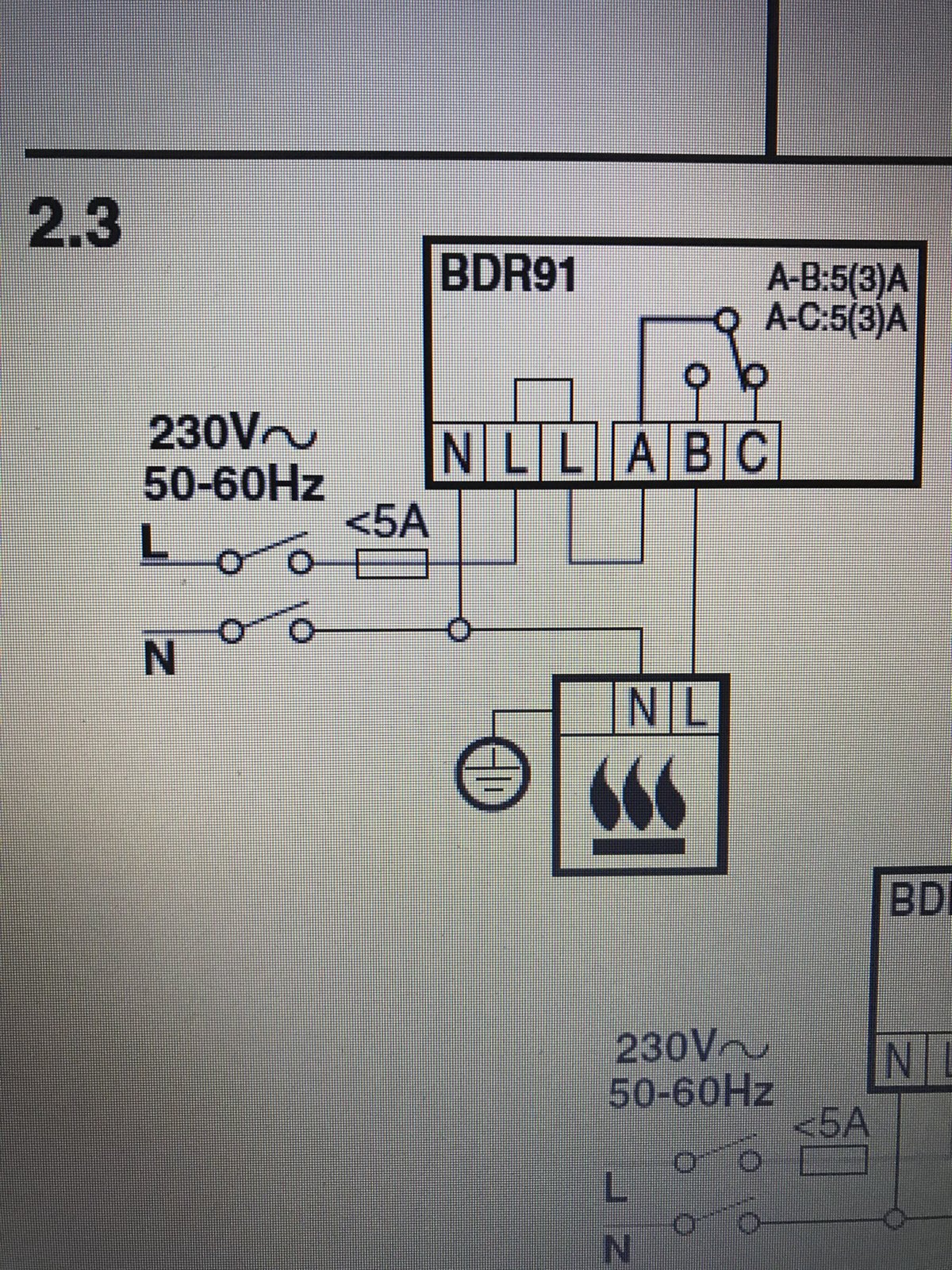

The wiring diagram is in the nest installation manual. If the wiring is this sh¦t here it is likely to be just as bad elsewhere I would recommend calling in a professional heating engineer to install it properly, for a start the upper green and yellow link between the 2 L terminals isn't even needed.

This is how my honeywell is connected.
Left to Right
- N- Neutral supply
- L- live Supply ( to power the unit)
- L to L is not needed (hes linked it so the first live gives power to the second live) but Im sure it already does that
- Second L to A is linked so it’s constant
- B is connected to switch for boiler
If you have a multimeter, if you take the L-L out and test if the second L still has power, that would comfirm my theory that it doesn’t have to be there.
Hope this helps.

I'm not as much of an expert as some on Nest here, but I do have a honywell programmer and BD91 relay. And it is connected to a combi through connections at A and B. Mine does not have the live bridge wire to term A. It looks like your combi is configured to operate at 230V for the stat so if it is working properly, the BD91, I would replicate that set up in the Nest.
I agree with other comments, that wiring is terrible a long way from professional. Lots of conductor showing, use of a earth coloured cable for live conductors, no identification marks on the black wires......
Thanks for all your replies. I've definately got a better handle on what the wiring should look like. The Nest website does provide a wiring plan relating to a 230v combi boiler (photo attached) which seems to confirm the information you all have given me. I'll think my best course of action is to perhaps get it professionally installed as I cant be certain but it looks as though the wiring used in the Honeywell is stranded and its my understanding that the Nest doesnt support this type of wiring.

Yes, that is the wiring diagram. 230v combi. Looks relatively straightforward map from the BD91. If you have some experience and can use a multimeter etc. you should use some colour sleeving on those black cables at the very least to identify as you pull them out.
Your wiring can be tidied up by someone with more attention to detail and experience. It is virtually a 1 to 1 match across that 230v nest diagram. The use of earth colour insulated cable for the jumper / bridge links should be replaced with brown or another suitable if required on the nest i.e. between L and 2.
Cables should be carefully trimmed and inserted fully into contacts with no copper strands showing.
