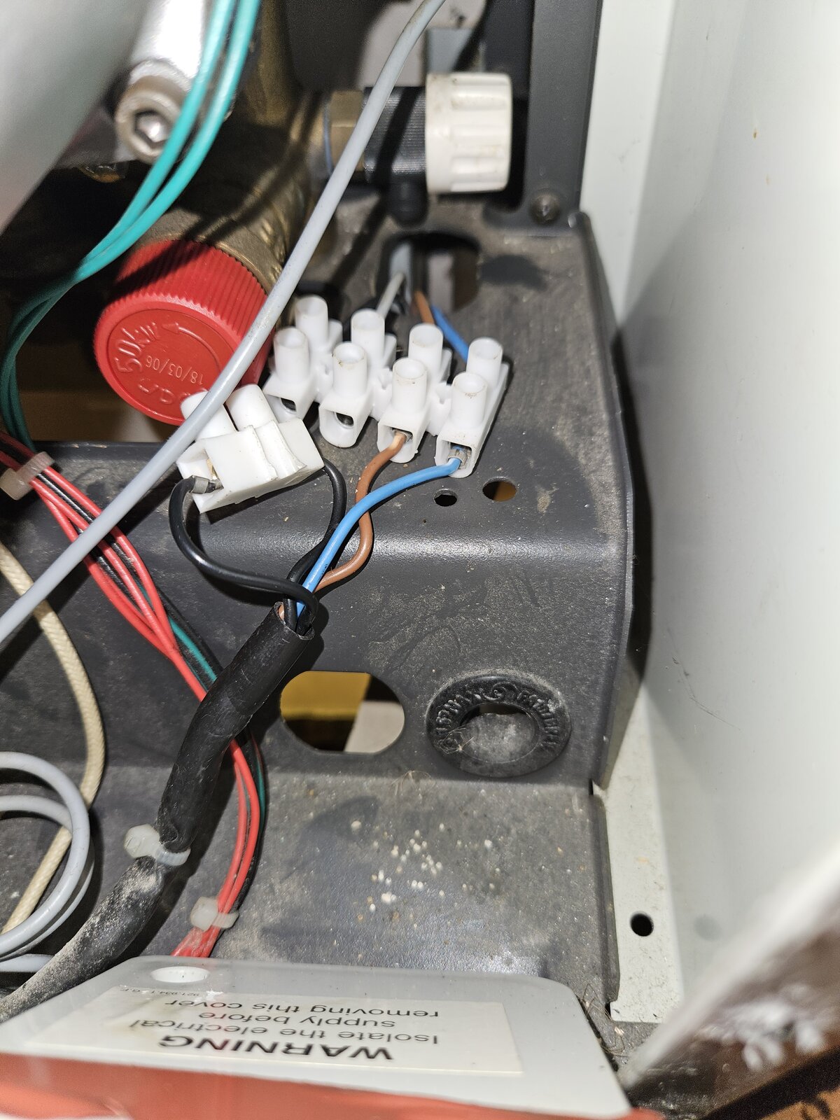

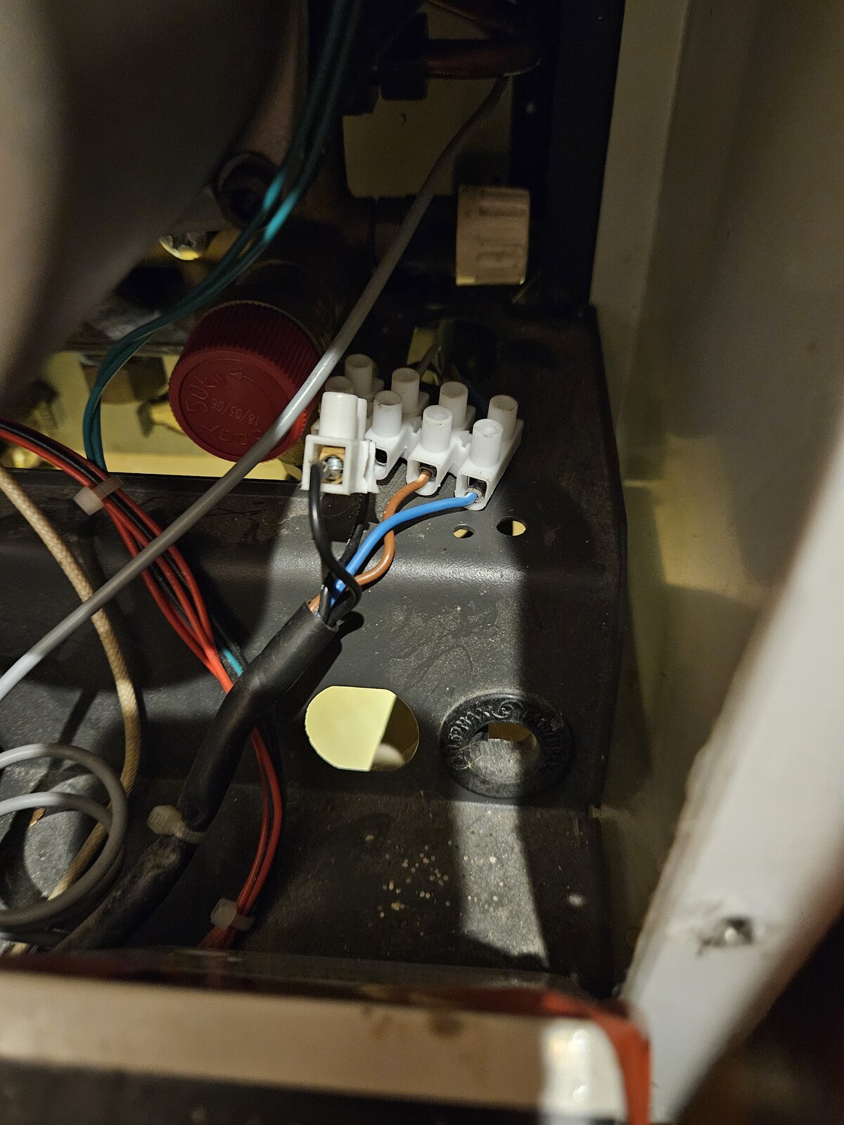

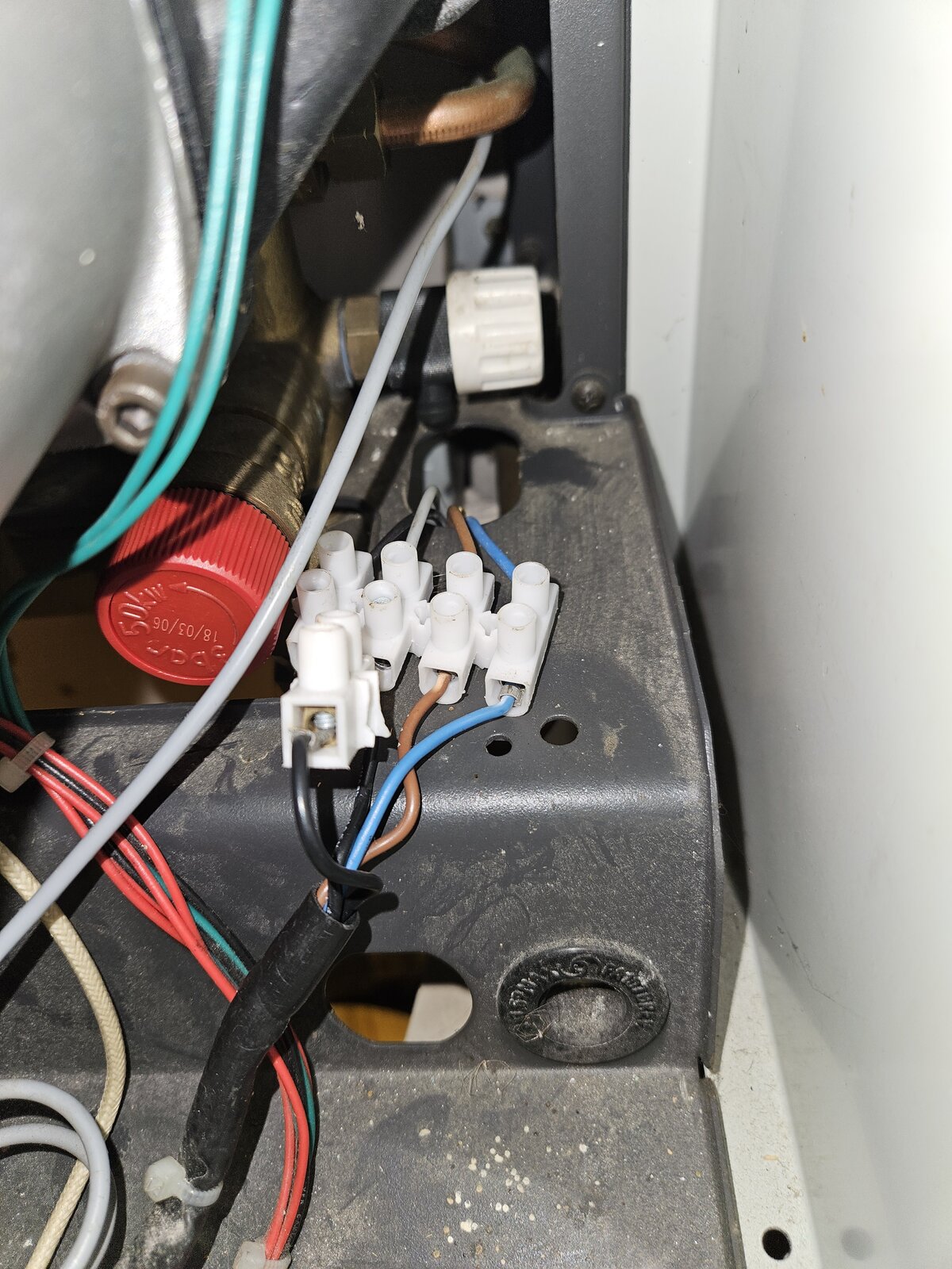

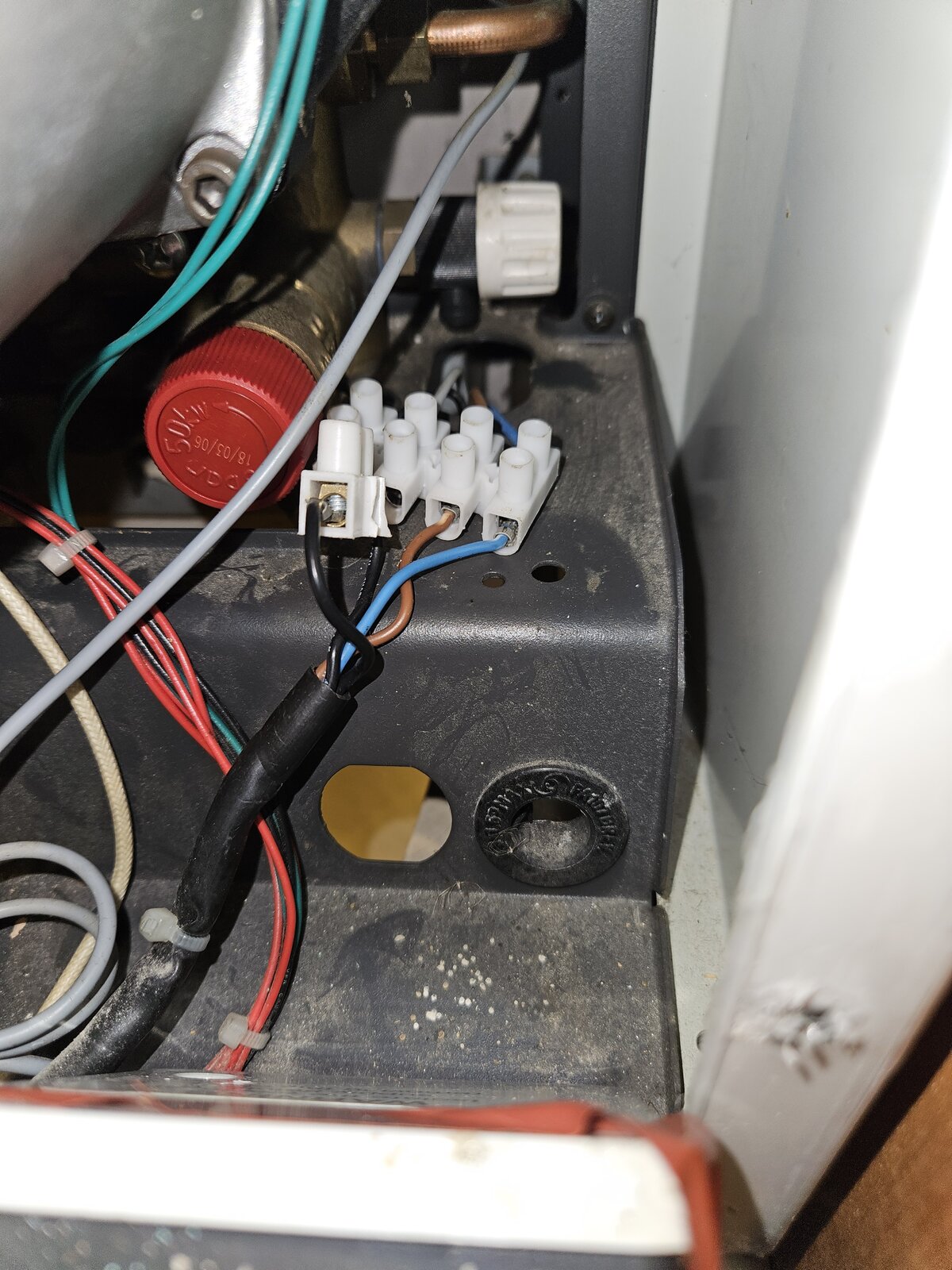

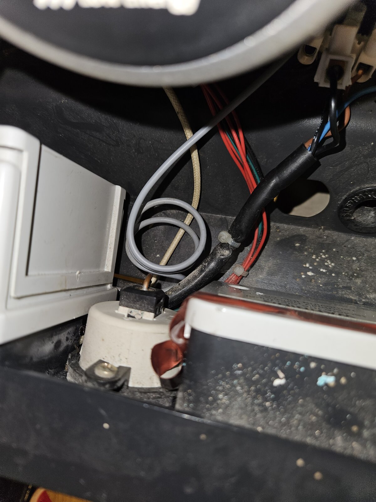

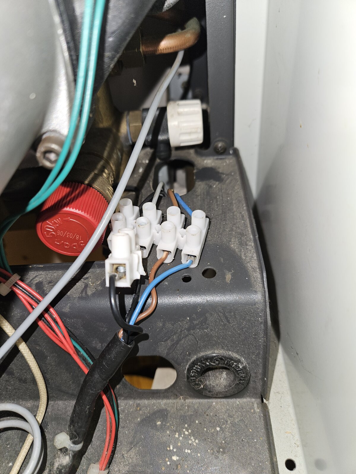

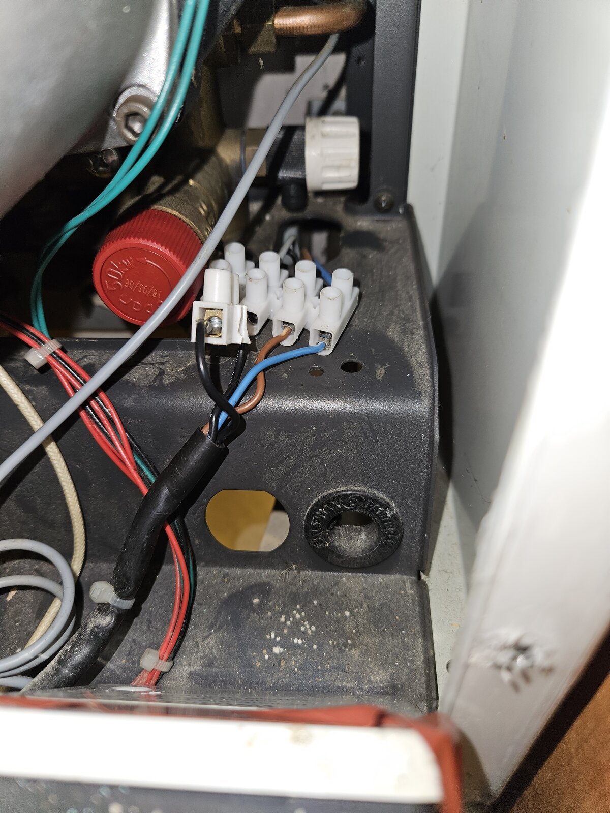

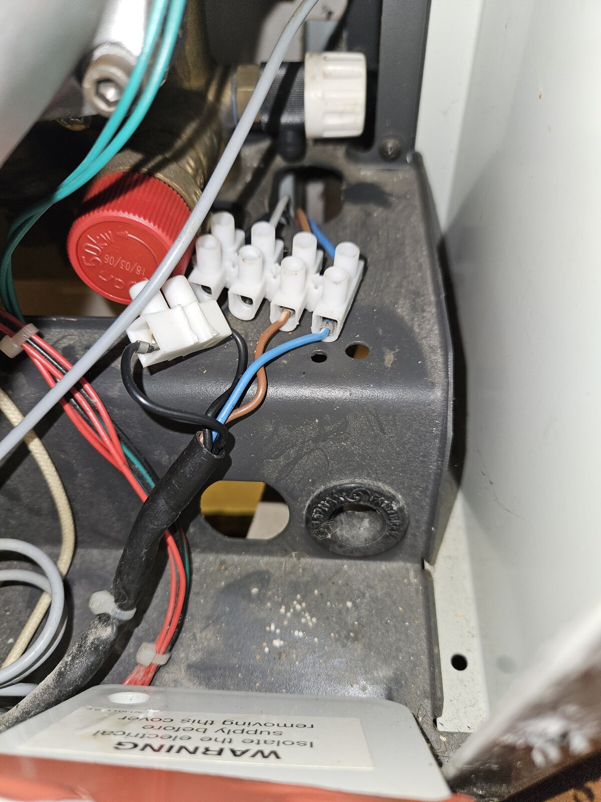

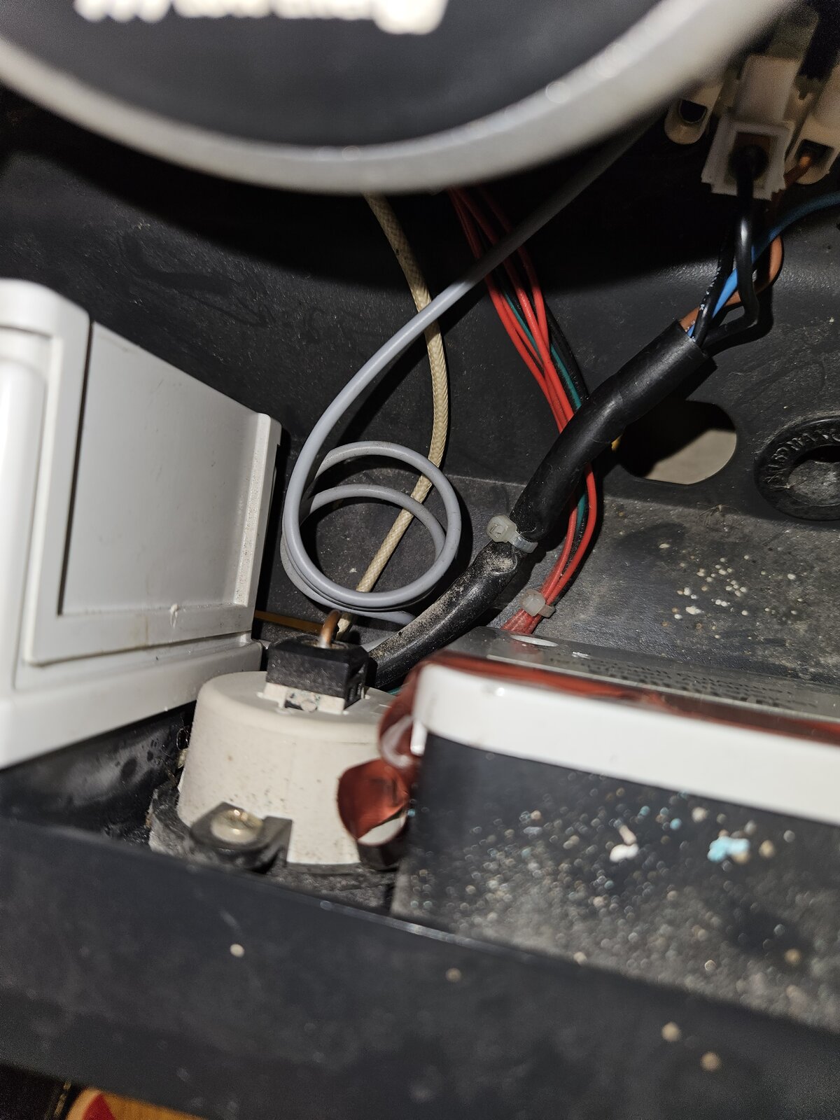

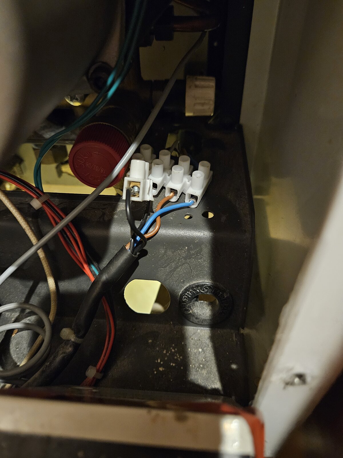

I took a few pictures there, is it just me or are the black and grey wires going nowhere? Might be hard to discern from the pictures but have a look

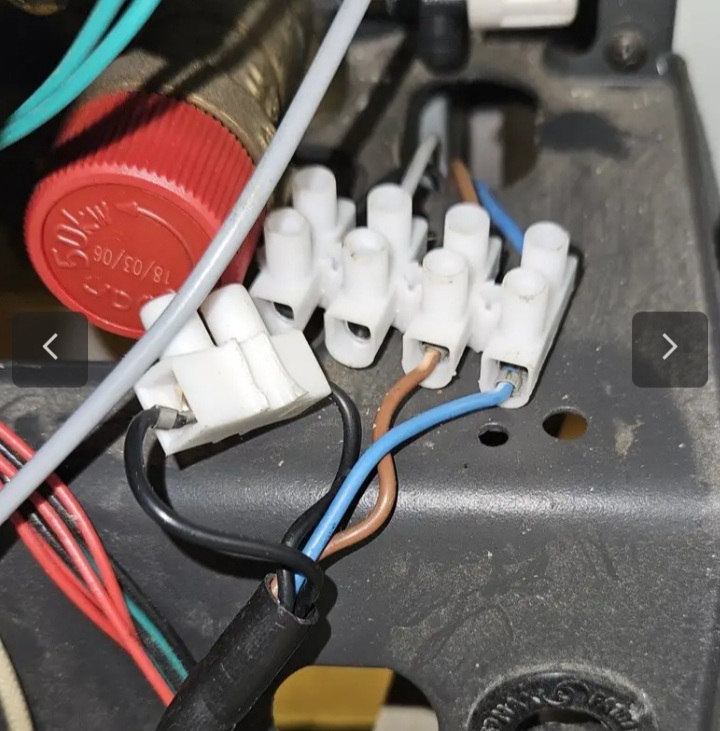

Hard to tell exactly, but they appear to be wired via the clock? Have you looked on the left hand side?
Yeah I was thinking they were connected to the clock too.
Nothing on the left, but oh sorry I should add in case its not clear - the wires come up from the Nest from the *background* of this photo
Just looked again, and the black from the clock is looped. The main boiler power cable should be on the left.
Looks like it to me too - a bit of a bodge.
Maybe the correct terminal blocks were inaccessible due to the cabinet?
As a test (with power isolated), decouple one of the black wires from the clock (safely isolating it in another terminal block), and see if the central heating remains off.
Edit, I believe these terminals aren't linked in to the clock, but are on an extension cable, that dips under the pressure guage and into/around the PCB enclosure - probably connected to the correct terminals on the left hand side of the boiler?
