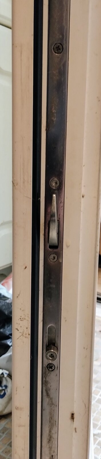

Fair play.
It might be a good idea to take a photo of the door edge so that someone more knowledgeable than me, eg @ronniecabers , can advise you further.

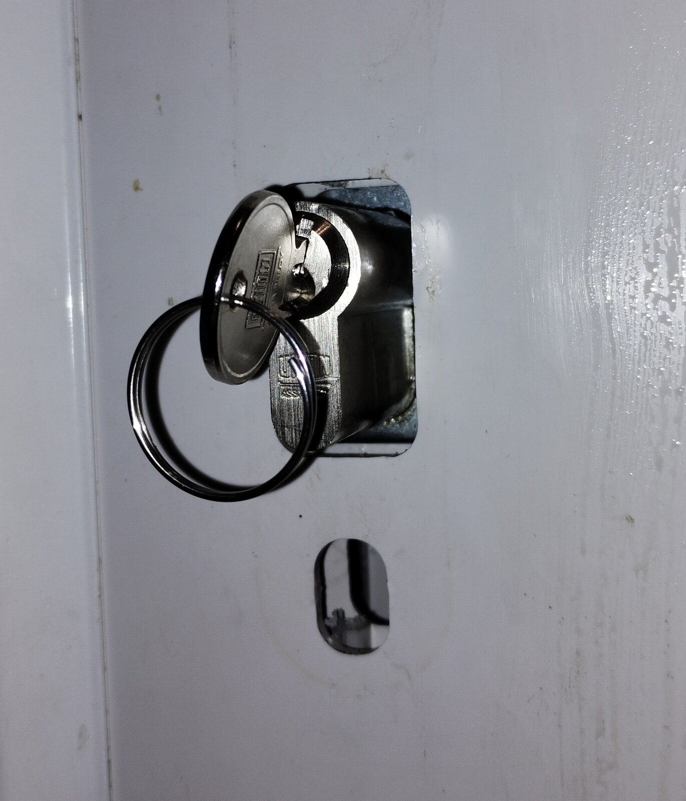

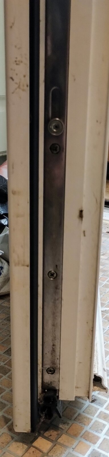

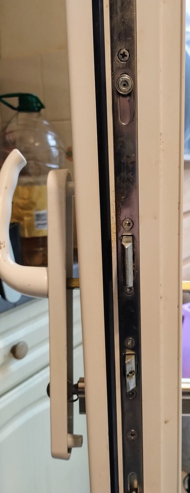

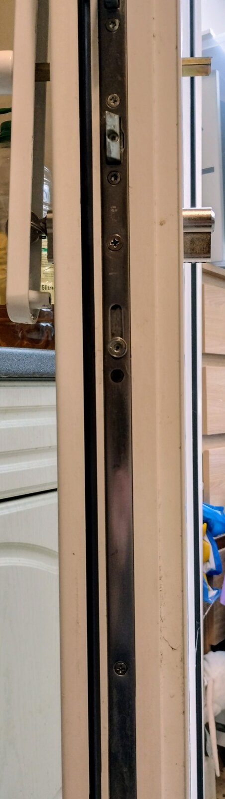

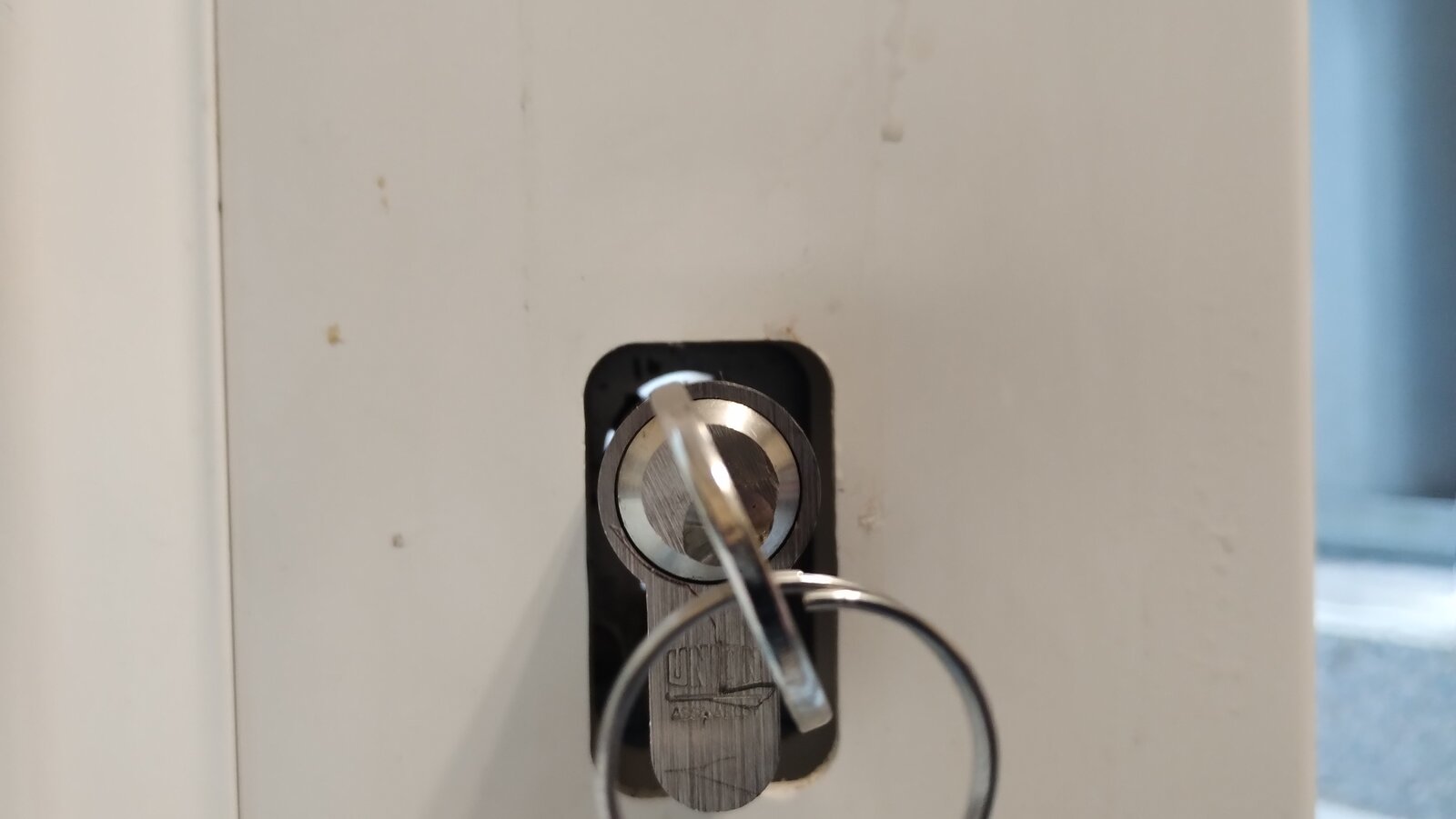

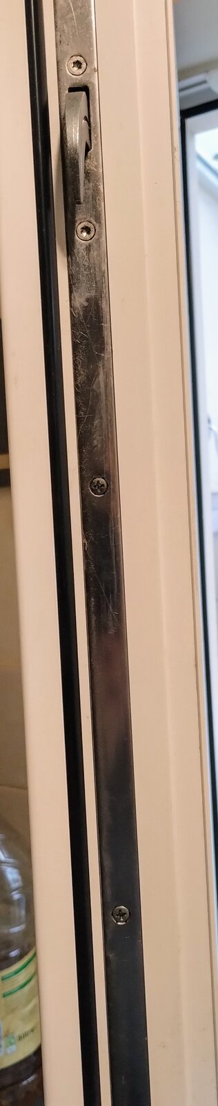

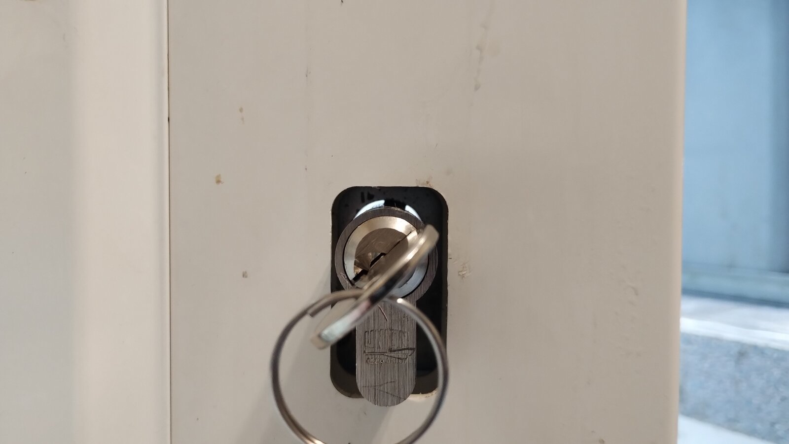

Unfortunately not. The key will only move between the 11 o'clock and roughly 12 o'clock (actually more like 1 o'
clock) position, so a turn of about 60 degrees. I've tried all sorts to get it to move more (WD40, knocking it, pulling it, pushing it, moving it up/down) but it won't budge - and I don't want to risk snapping the key.

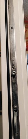

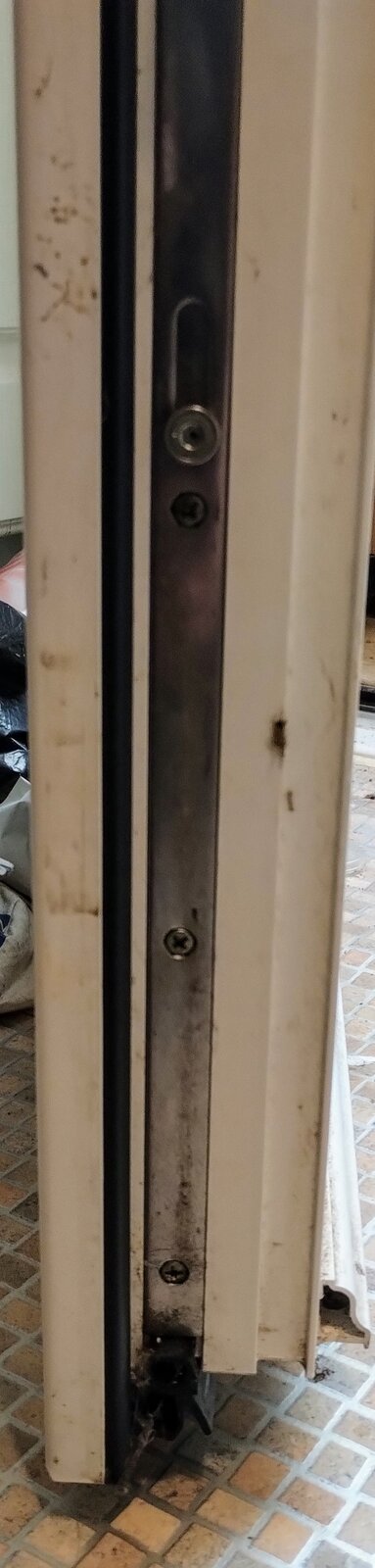

Attached are some photos showing the edge of the door and the extent of turn that the key will complete (you can just see the cam inside as well).

Yes, the key's in the cylinder lock (in fact it's jammed in and won't come out) and will only turn through an angle of 60 degrees - see photos above. It's just bizarre but the only thing I can think is that the new cylinder lock I put in is faulty which is why it's now totally jammed up.
