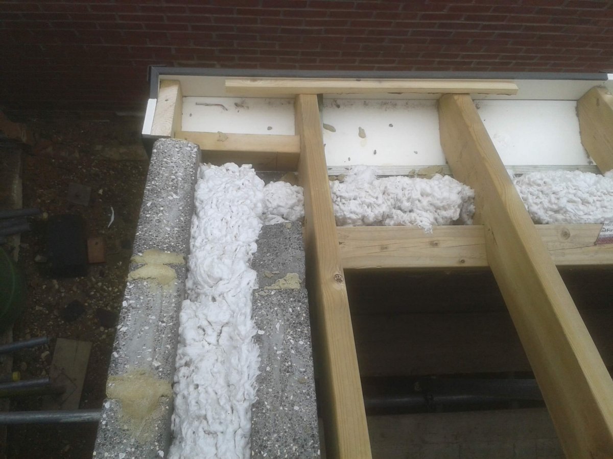

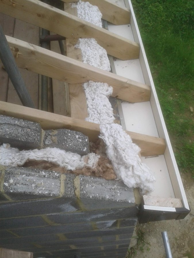

We are having a ground floor extension built and the insulated walls have been left uncovered resulting the insulation getting soaked through. There has been a delay and they have been left exposed for a few weeks now, and unfortunately there has been a lot of rain. The wall is built with breeze blocks - both on the internal and external sides.
In its current state, the insulation appears to be bulging out of the cavity at the top (see photos), and has been bleached white in the sun. The insulation is wet to touch, and I've stuck my hand down inside the cavity and it is wet as far as I can reach. The top bit of insulation is easy to pull out, but after that the insulation is kept in by bits of wire that go from the internal to external walls (wall ties?).
I have attached a couple of photos taken from the first floor, looking down.
I am very worried about this. The architect doesn't seem concerned. I'm yet to speak to the builder.
Is this a problem?

If the wall is now kept dry the insulation will dry out. If it is finished in render outside and plaster inside and the cavity capped by the roof, I really don't know how long it will take to dry out - 6 months? Until its dry you will have problems with interior decoration.
