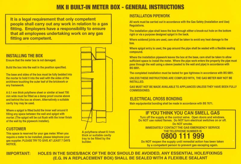

A couple more questions have arisen;
Is it possible to retro fit the inset gas meter boxes?
Like these:
http://www.meterboxes.co.uk/content/METERBOXESdetails.asp?ID=13&CatID=23&TypeID=1
Secondly, when the pipe passes through the wall, can it be buried in the plaster/wall so that it can go to upstairs?
I realise this needs to be done by an RGI etc, but I want to know if this is possible before I put the meter in a stupid place!
Here are the fitting instructions for the inset box, but the same question applies, even if we have to have an external box.
Thanks for your help :)
I would say no... you would be better getting a sunken one rather than knock a huge hole on you wall, you would need a builder not a gas man for that job.

Pipe can be buried in the plaster but it needs to protected with the appropriate tape or covering. And yes they can go under floor boards
