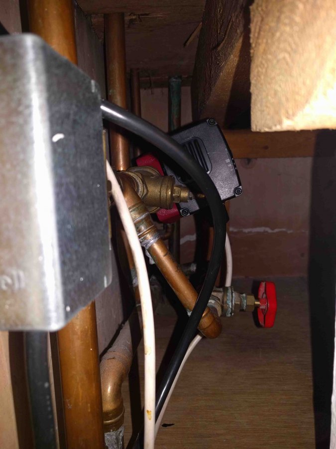

The instructions say the pump must be installed with the shaft horizontal; no mention of 15-20 degrees from the flat. Is it under a floor?
Is it an unvented system with a F&E tank in the loft? If so, what is the vertical distance between tank bottom and pump?
A pic would be very useful.
I was worried about the tilt as well but the manual does say it's OK at a slight upward angle, but not down....

I know that, in the past, Grundfos said that it was OK for the front to be slightly higher so I check the latest versions of the manuals on their website. The Installation Instructions say:The pump must always be installed with horizontal motor shaft.

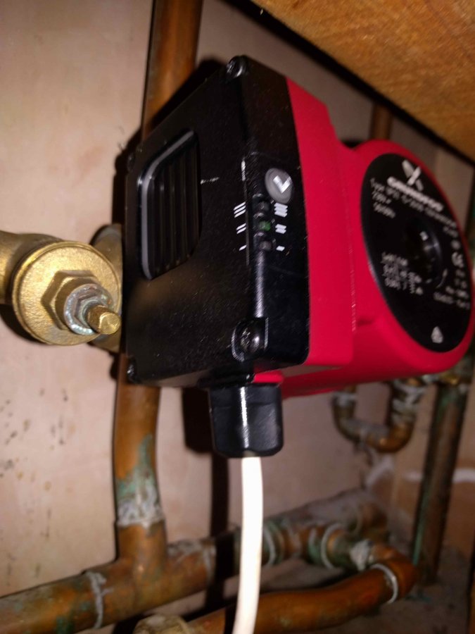

OK, back home, and as promised here are the pics
First one shows how tight it is in there
Second shows the pump angle

And listning to it try to start up you can hear it try, and once when the boiler was running, there was a very nasty noise (bag of spanners) that sounded like it was from the pump, then about 10 seconds later the pump started and everything was fine again
