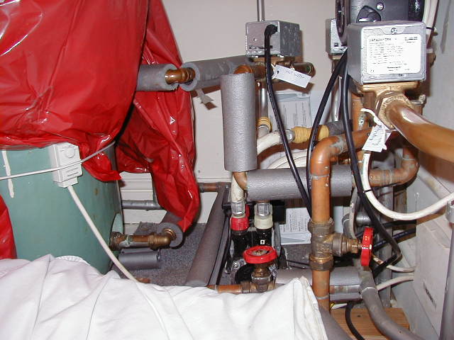

Two issues: 1) quantity of hot water created/stored in cylinder 2) erratic delivery of hot water to shower (Aquilisa).

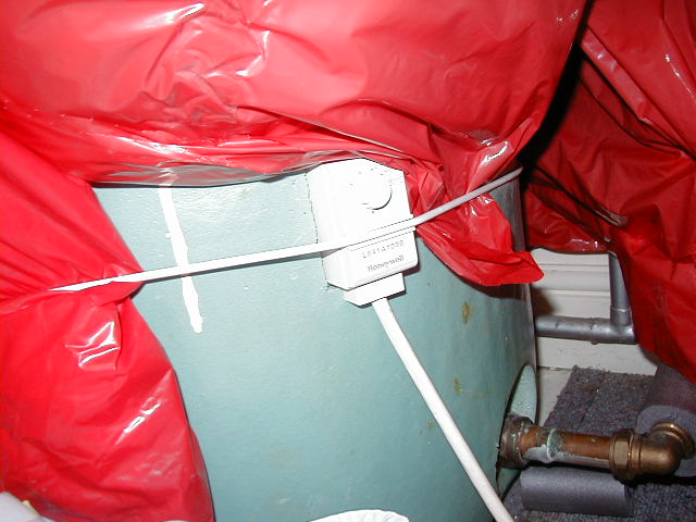

Honeywell L641A 1039 cylinder stat

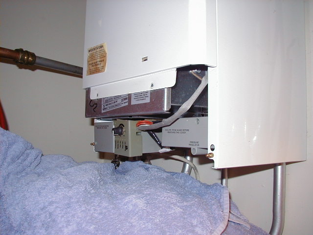

Baxi Solo 2 50 PF gas boiler

New house I tried the same but only get 1 days shower from the tank. Discovered the cylinder stat was set to 50, but increasing it to 60 (dificut as the stat is very old/stiff) made no difference. In fact if anything water is colder.

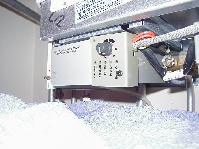

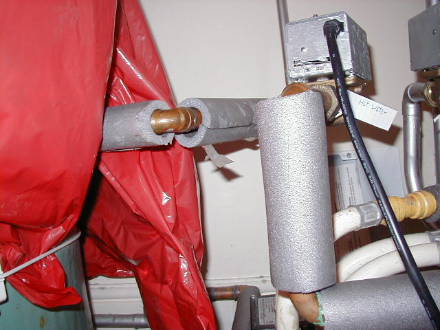

Testing the stat it seems to work and turn the boiler on/off as the stat is turned up/down (though there's a significant delay), but when turned down whle the boiler goes off the pump continues to run and I can still feel water running through the pipes.
Also just noticed (today) the boiler temp is set at the min (see photo). Is that normal? My last house had an oil boiler that had to be set at max to get the rads hot.

Q is my problem basically with the cylinder/stat/boiler, or with the Aquilisa?
Q might changing the cylinder stat help?
Q: should an hour be enough to heat the whole tank?
Q am I expecting too much for water to stay hot in the tank?
