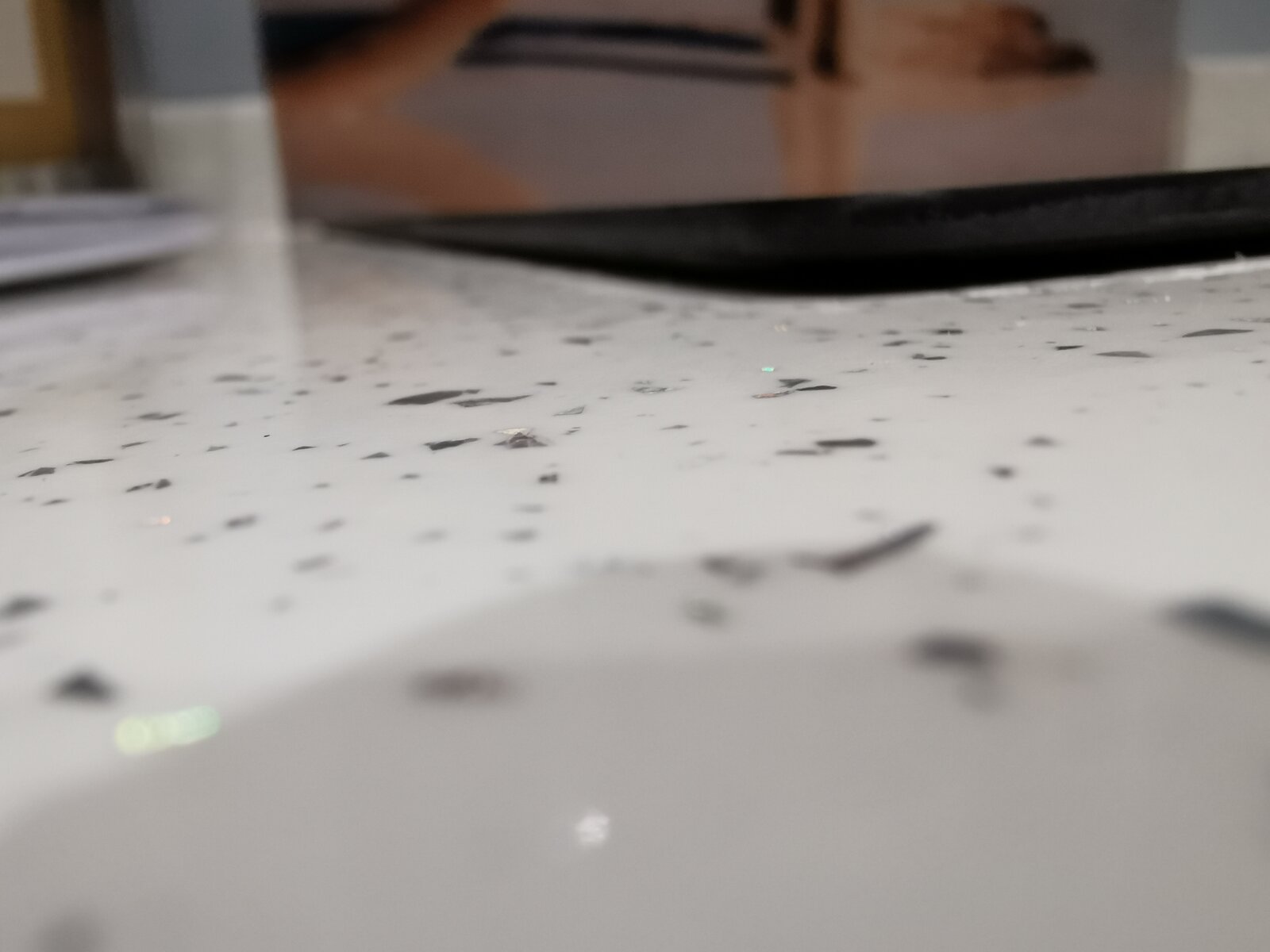

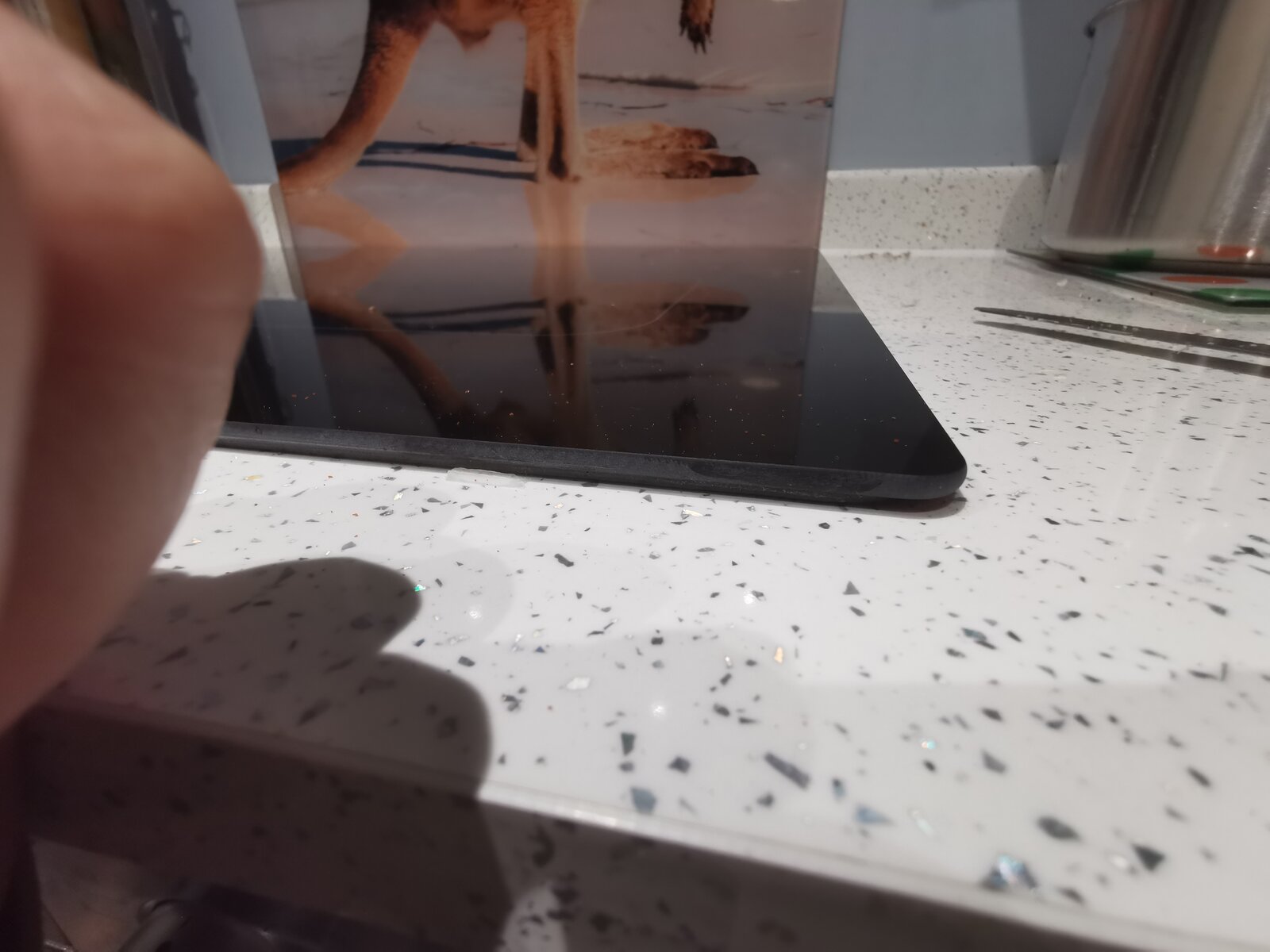

Hi, just had a new induction hob fitted.
im guessing this is going to build up with water/debris quite quickly round the sides which I could do without
Assuming I should get this sealed in? But welcome any opinions
I wouldn't bother. You will find that you can slide a J cloth under to clean any muck out.
What happens when he spills his orange juice right ext to the hob or whatever? Ugh! And then any liquids get down the gap and start expanding the inside of the worktop?
What brand hob?
What does the installation instructions say?
My Bosch induction hob, like the Neff ceramic it replaced, came with an attached sealing gasket around the edge. Not felt the need for anything else. It is on a granite worktop, though.
Wood/composite worktop cut edges should always be sealed with something (varnish?) to protect against liquid spills.
From the picture I assumed this was some sort of stone. If its laminated chipboard then the hole needs to be sealed.
It should have a rubber seal on the hob that will prevent any water getting through. The cut edge should be sealed.
To clean the muck out you can pop the hob out and give it all a good clean.
Cheers all, it was Currys that fitted it and took the old one and everything else away with them, it's not granite it's a wooden top so I'll get it sealed after all. Appreciate the replies
