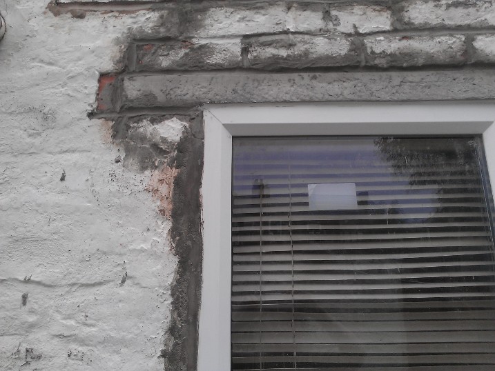

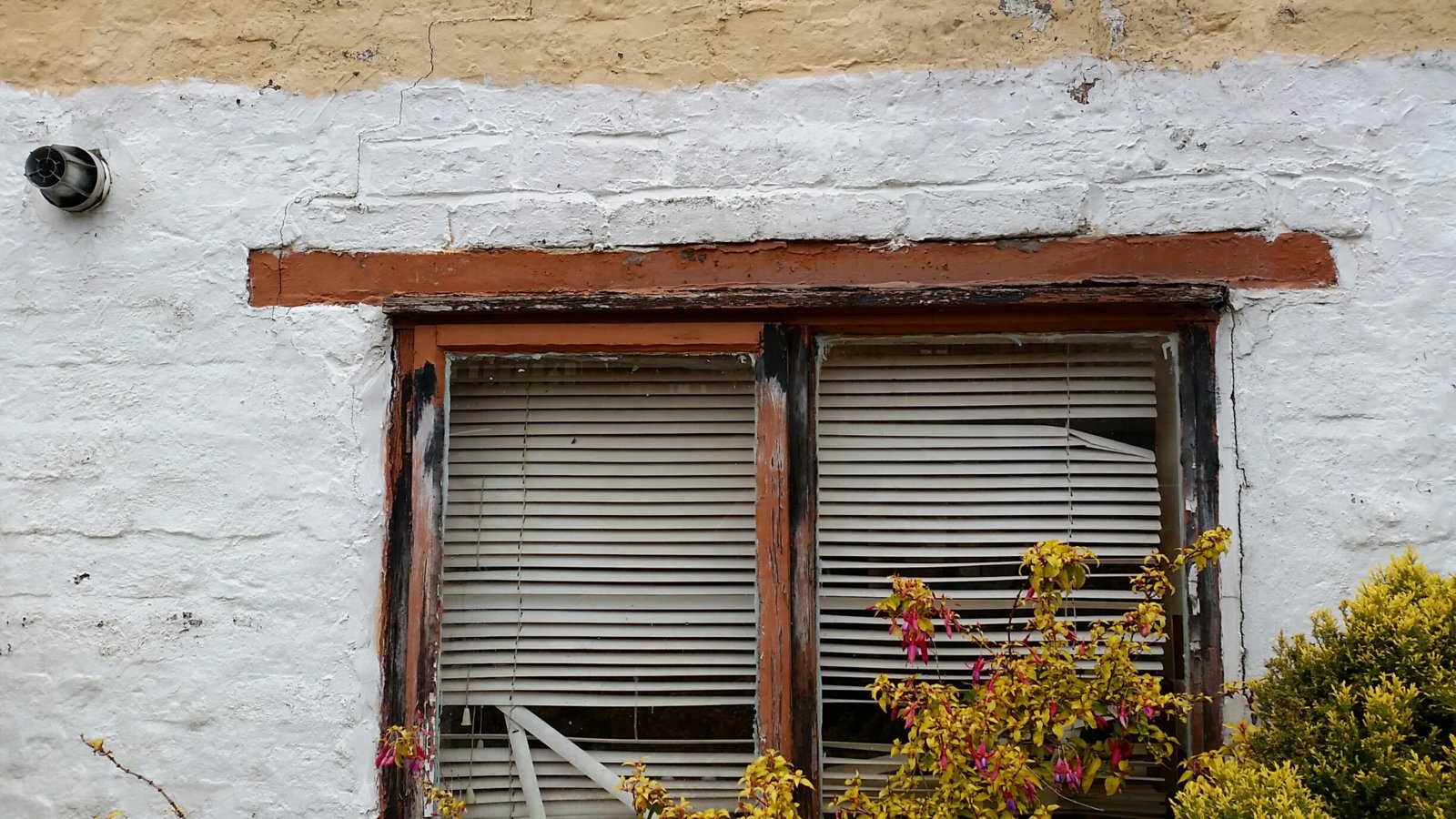

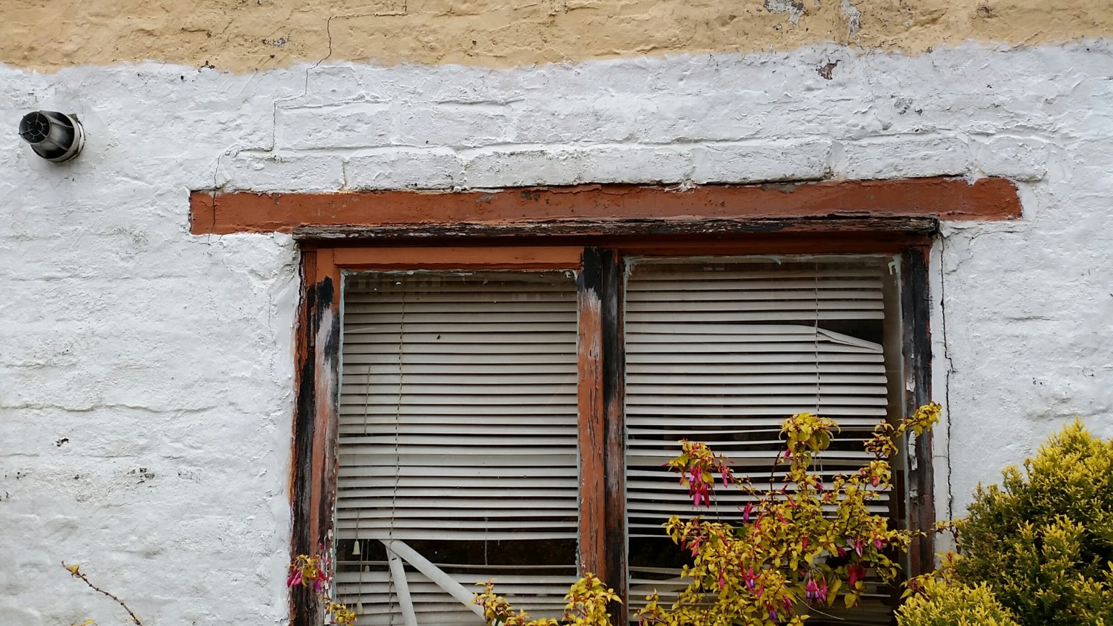

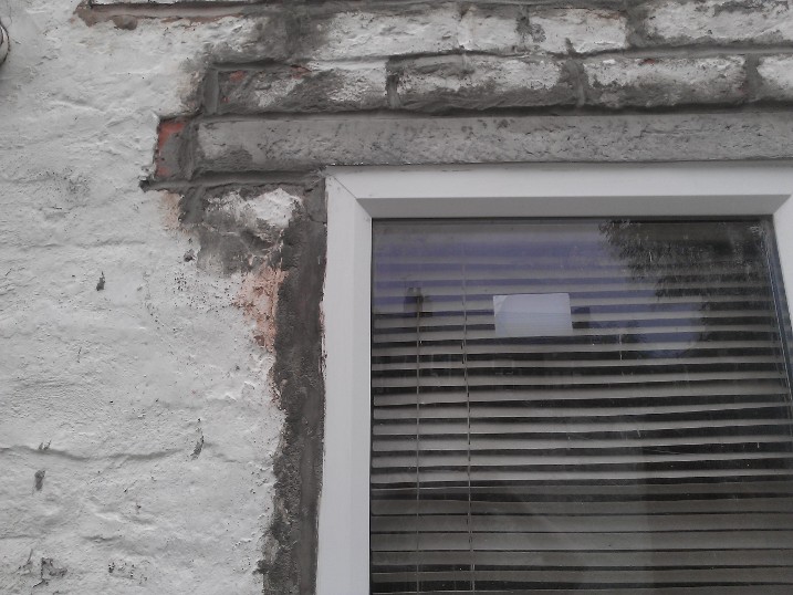

I have posted here before and if anyone needs to, you can read my older threads. Anyway, I had a new lintel fitted last week and was not happy with the quality of the work. The builders cut too much off the new lintel and had to put a small piece of the old lintel (the orange bit at the lefthand side)back at the end of the lintel space, which they mortered to the new lintel. (I only noticed this after they had gone.) The morter is where the original crack in the wall came down to. (See images of before and after.) I called building control this morning as I am concerned about the safety of the wall and they said I should have applied for planning permission for the lintel. Neither the builders nor the structural engineer had told me this and I didn't know. I have now applied-the council said to do it and that they could send someone out if needed to have the new lintel opened up to check if it is ok. I called the engineer and he said that I am 'starting to get people's backs up,' when all I am doing is trying to ensure that the work is ok and also now to be sure I am not breaking the law re. the planning permission. I have never seen a lintel with a bit of another lintel at the end before and wonder if this is unusual.

The lintel looks OK. The job looks crap though

Re. the new lintel. So you don't think that it is a cause for concern that it is pointed to the bit left of the old lintel at the place where the crack went down to?

The lintel is fine, the bit you think is the old lintel is the first brick beyond the lintel. Get it rendered and forget about it.
I think you've confused planning permission, building regs, repair work and new openings. To me it looks like the issue was always just crumbling brickwork under the left hand side of the original lintel. I would have replaced the half brick (or broken full brick) with a new full brick to tie it back into the wall but as said it's not going to fall down.
