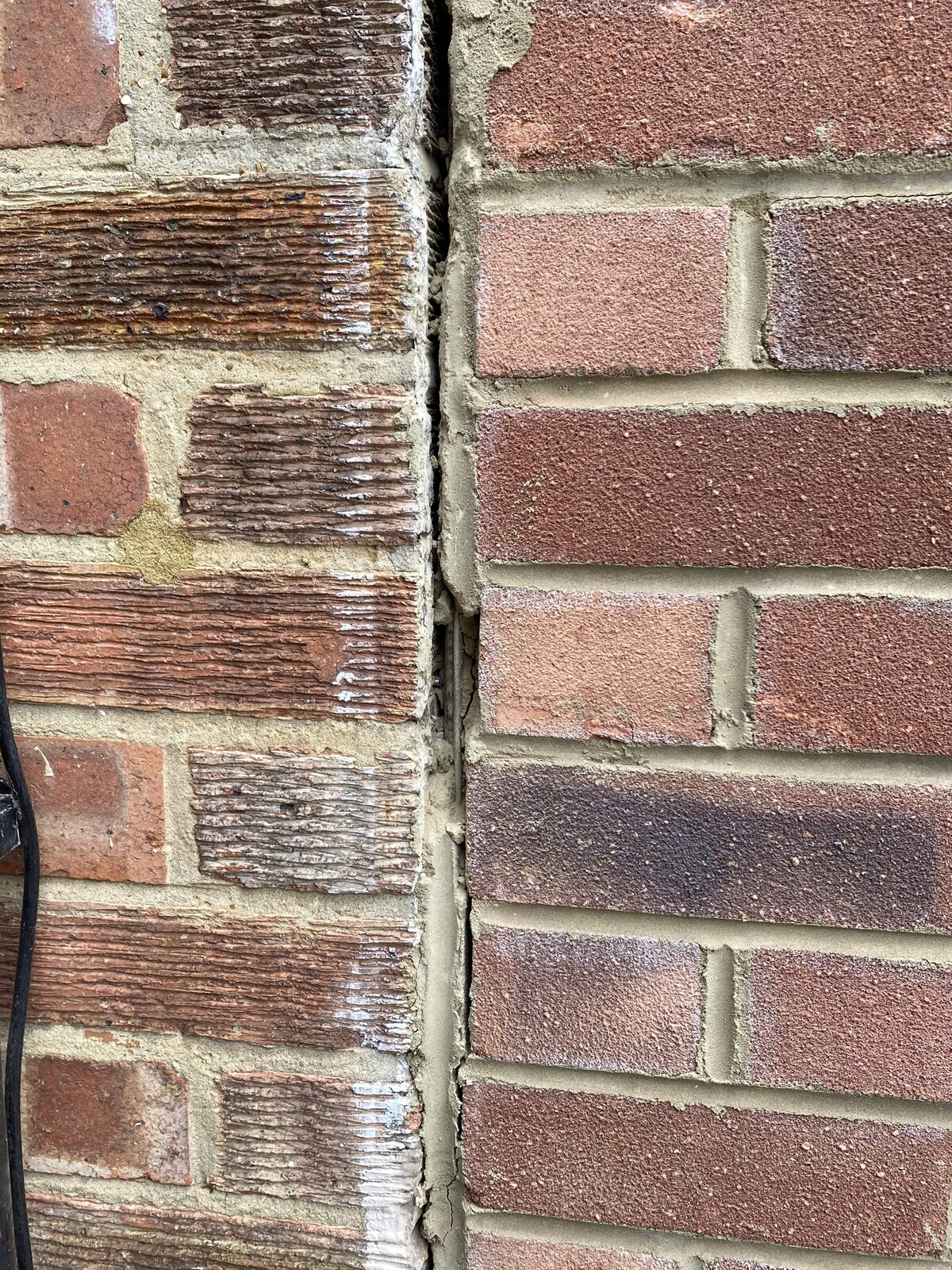

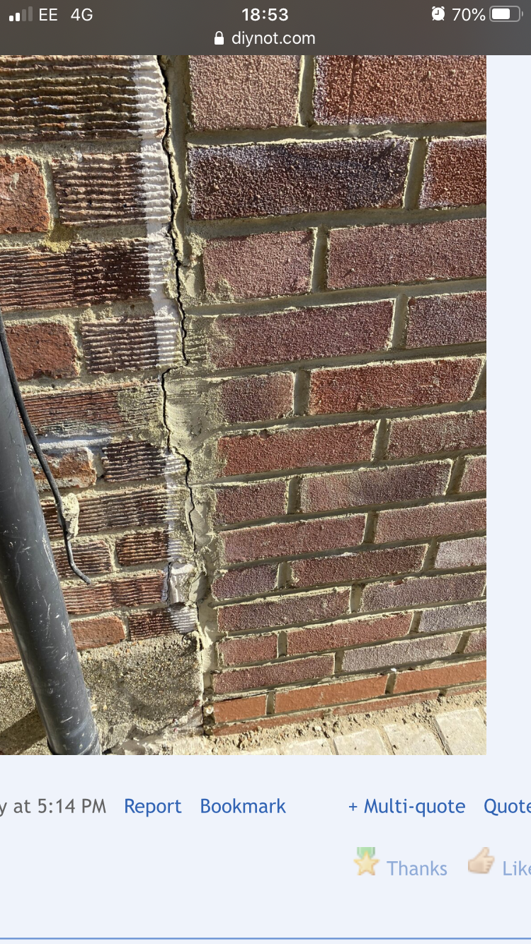

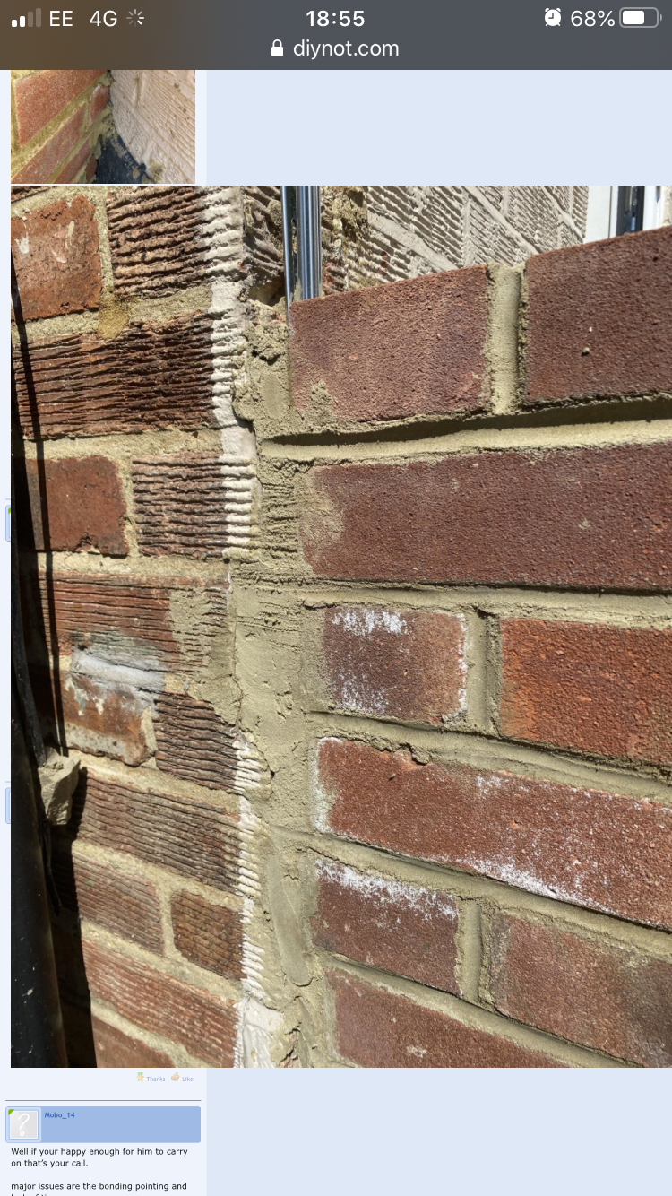

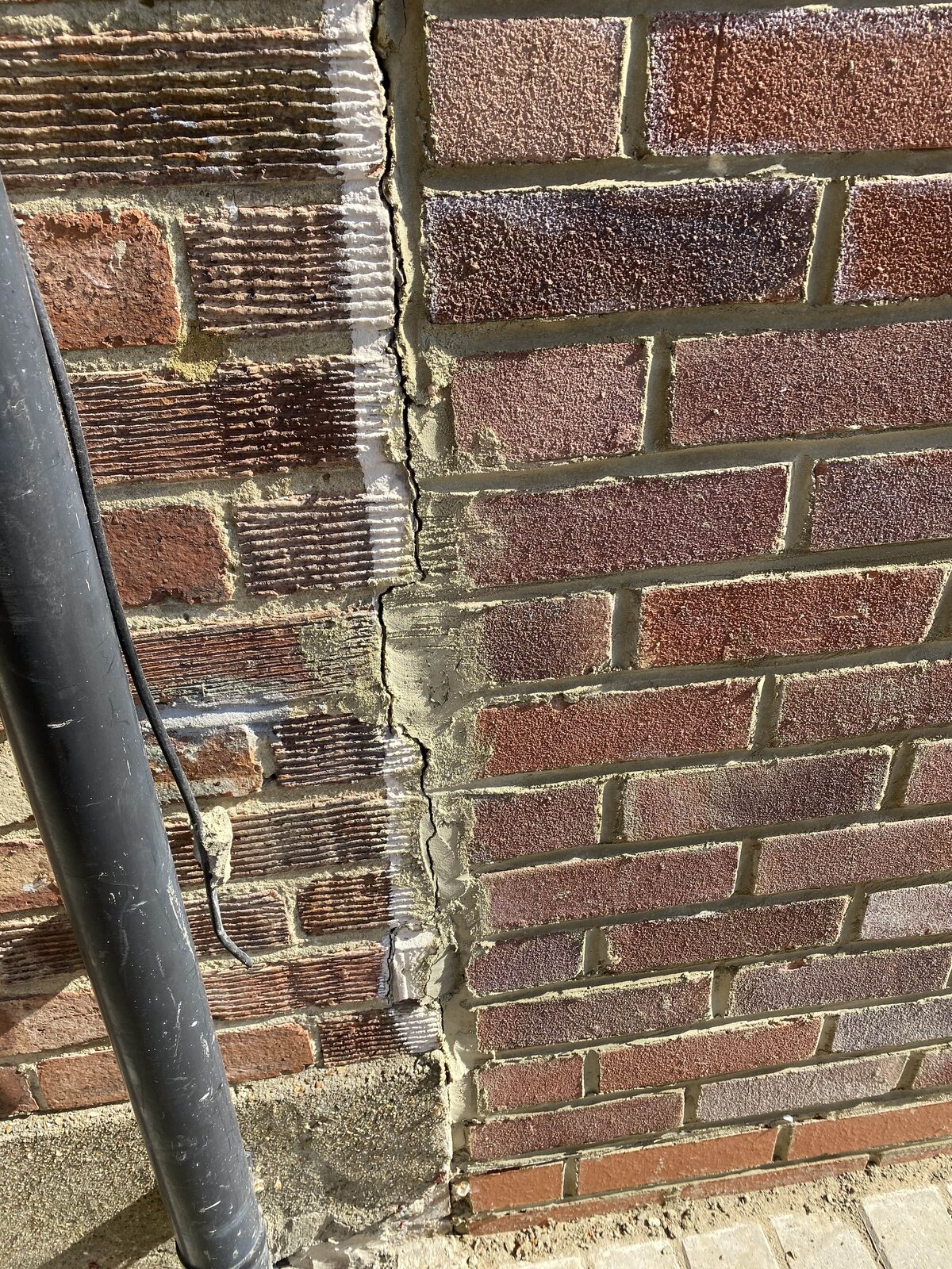

Hello,
So after a nightmare earlier porch build (single brickwork skin, full brick with a square window on one side, joined to the window on the other side - bay window), I had it taken all down and a started anew.
Foundations, (around 450mm or so at least), and brick work is done up. Roof has been put on as well.
Inside has been sand/cement plastered, two layers. However this was all done, around 2-3 weeks ago, and I've noticed the other day, a big gap between the porch and the house wall has started to happen.

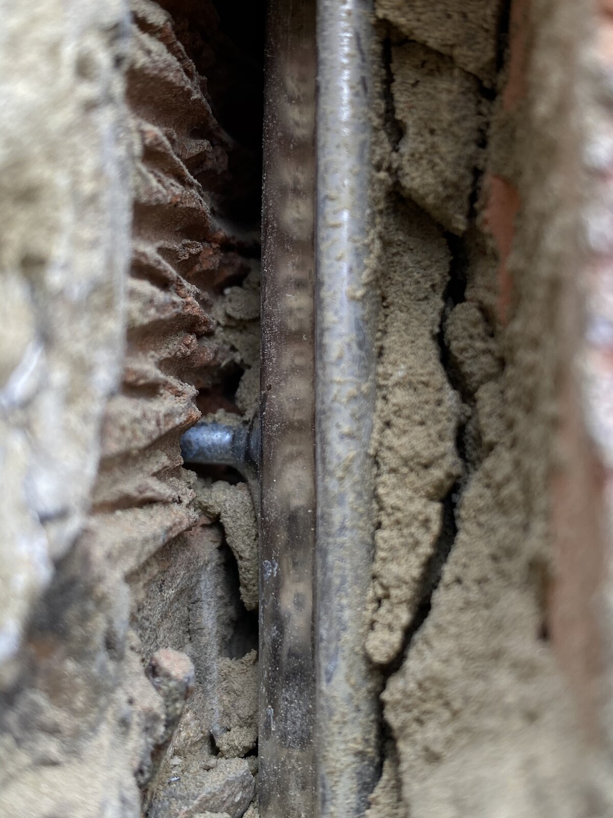

I raked out some of the mortar, and can see it looks like the wall starter is coming away from the wall... I'm guessing this isn't normal, but is this fixable without obviously taking down the whole thing? I don't think the foundations are the problem, but I'm not a bricklayer, or know much about the bricks - Is this maybe even normal and needs to be filled with a more flexible joint?

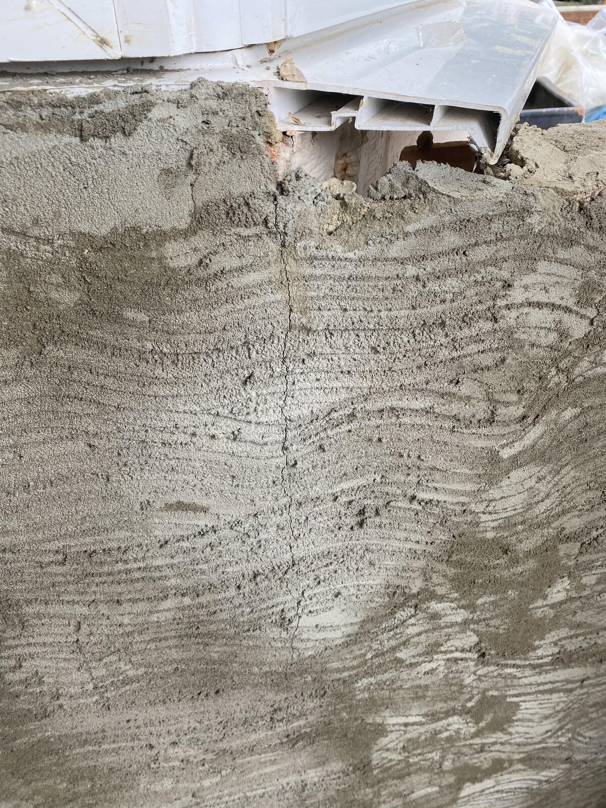

The same thing is happening on the other side, where the wall is less than a 1M high, and no wall starter was used there. Small crack appearing in the plaster inside.

Oh dear!
Looking at the brickwork I can deduce the quality of the unseen work.
Have they put enough fundations or did they build on grass? (seen it done once)
How did they fix the wall starters?
They're supposed to be bolted to the wall with large 10mm bolts, similar to the ones used on satellite dishes.
It doesn't matter that one of the walls is 1 metre, it still needs wall starters.
The foundations were decently deep (I think... anyway, I'm not sure how much they're supposed to be), unfortunately I'm not sure how deep, but they did dig maybe 300-500 and fill in with maybe 200mm concrete. The engineering bricks at the bottom are 2 courses deep into the concrete poured into the middle.
The wall starters were attached using the screws provided https://www.screwfix.com/p/sabrefix-wall-starter-kit-stainless-steel/56037 (5 x Stainless Steel Coach Screws, Washers & Plugs) not sure how big they are.
200mm concrete is not enough.
That's why it's collapsing.
You can't rely on wall starters to support a wall, they're there as belt and brace.
All the porches (i mean, mini extension) i built have been cavity double skin, i walked away from landlord insisting on saving a few bob knowing the risk of dampness.
Fundations of 500mm subjected to stable ground (hogging here in most of london) filled to ground level.
Then 2 courses of engineering bricks (or more if house level higher).
So i'm afraid, it's back to the drawing board for you and back to be a tea boy for your builder.
The problem was that you employed buffoons not builders so the porch had no chance - and that can be seen from just a small part of one image, nevermind looking at anything else.
You need to review your selection process.
Don’t think you’ve had it all taken down either.
One of those is from your post about a month back.
no point coming asking for advice then not listening to it :eek:
