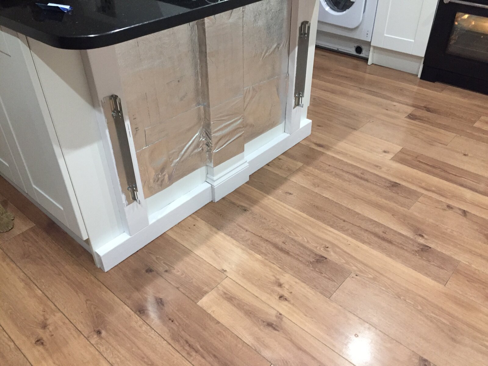

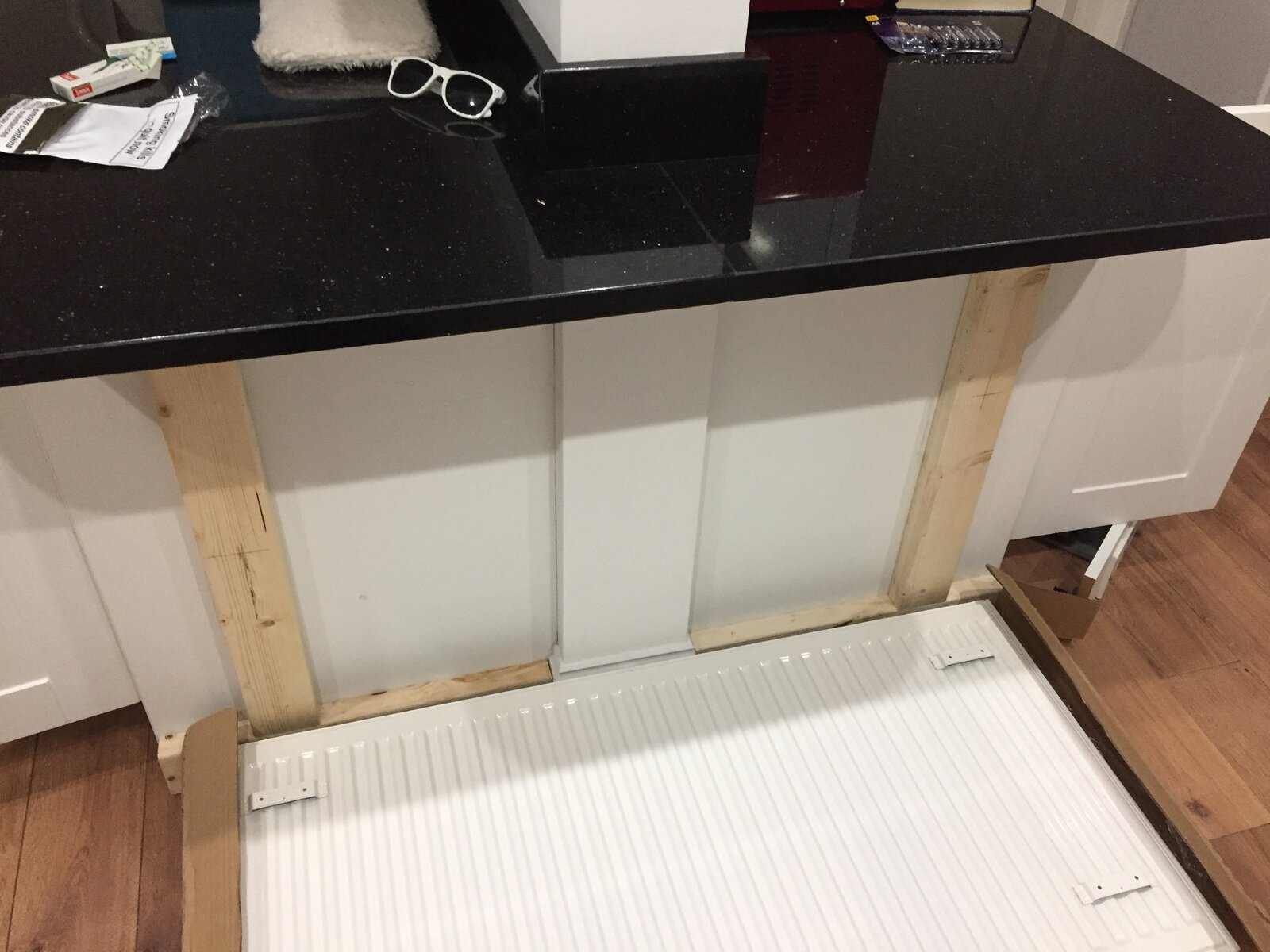

I will be screwing some battens of wood to the side of kitchen cabinets and hang the radiator on that under a quartz (I think) worktop, i’ll be using some radiator reflective foil under the worktop to be sure as there is a joint right above it
That wont work very well for heating the kitchen as you will block the convection
I was thinking that but sadly no where else for it to go on that side of the kitchen but i’m sure it’ll be better than the plinth heater
The worktop isn’t huge and with the battens it’ll be more flush with the front rather than closer to the cupboards

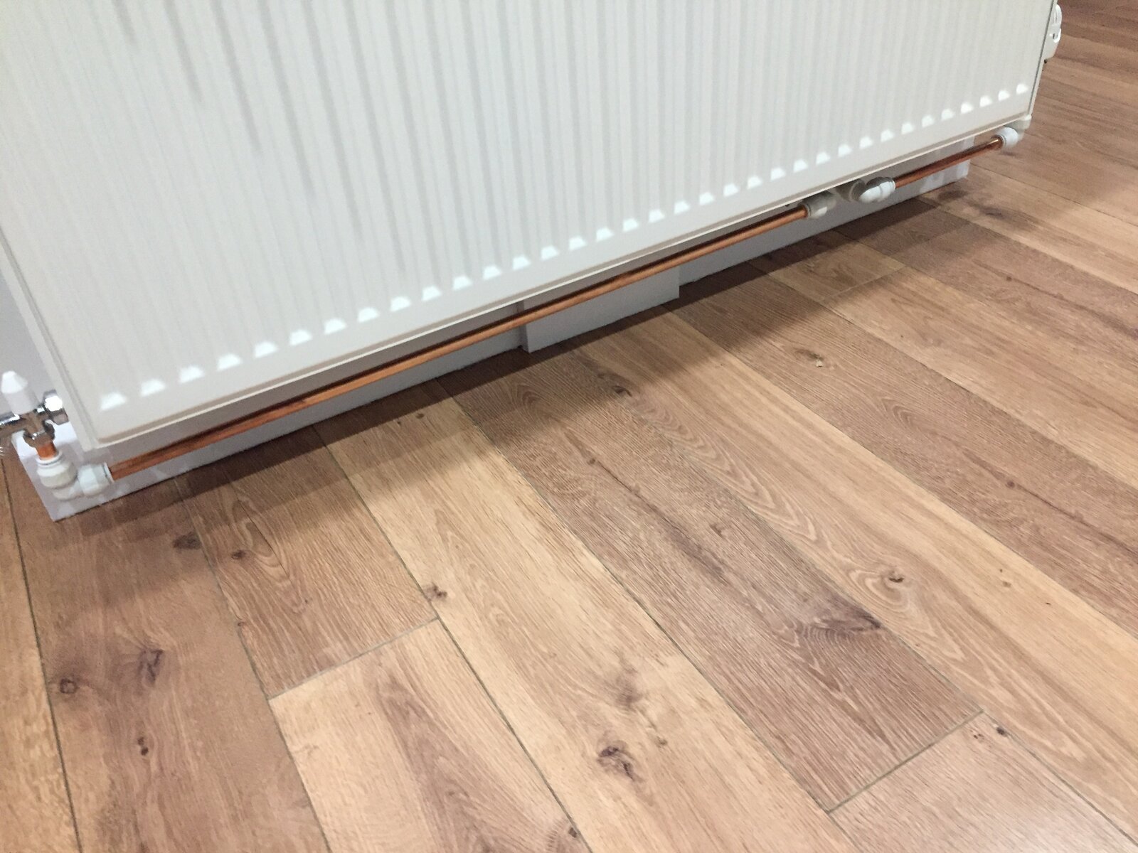

The speedfit elbows etc will be fine. Just make sure there's enough pipe for them to fit to (25mm min) and no dents or lumps of old solder on them
Got another question, as this is a downstairs radiator is it advisable for me to put a drain off valve on? All my other downstairs radiators do bar one for some reason.
The radiator i’ll be buying comes with a free lock shield and TRV, but it’s not a drain off, so for the sake of a fiver should I put one in?
If your heating is plumbed as drops (main pipework in the ceiling) then a drain cock can be v useful for shifting airlocks so yeah go for it, won't hurt

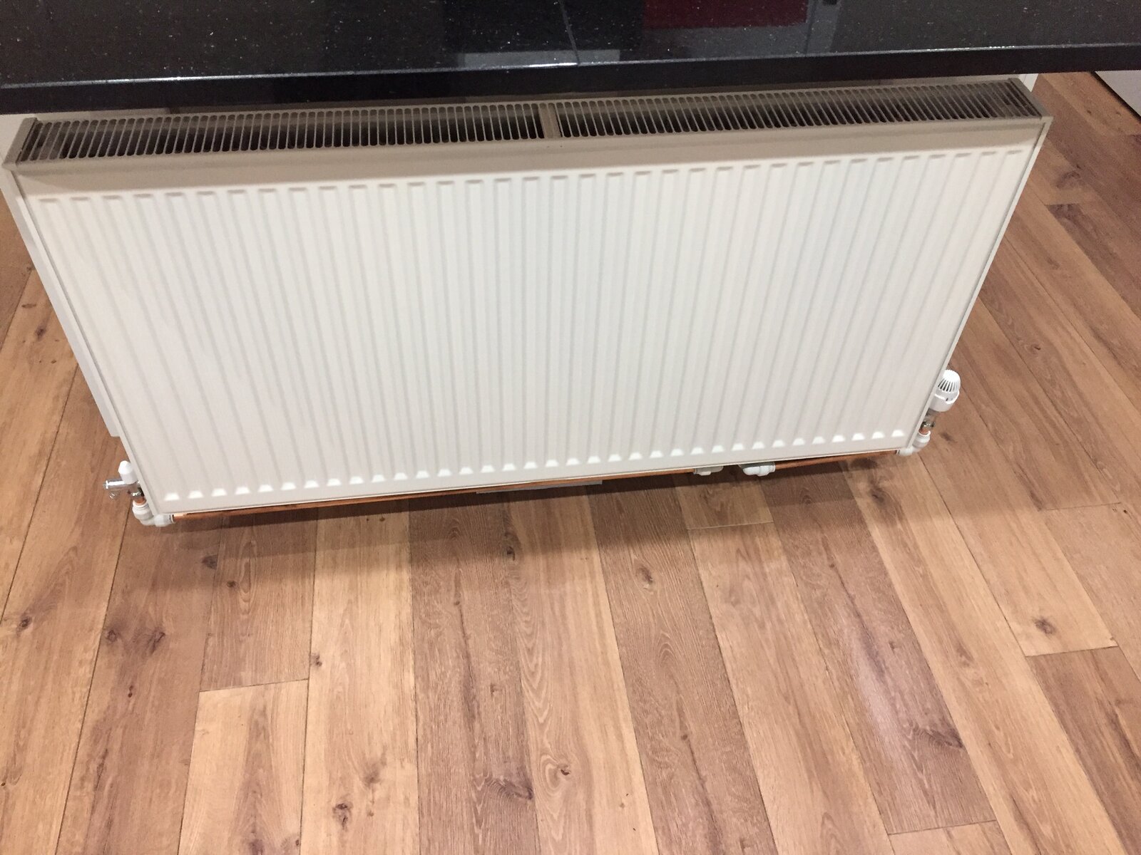

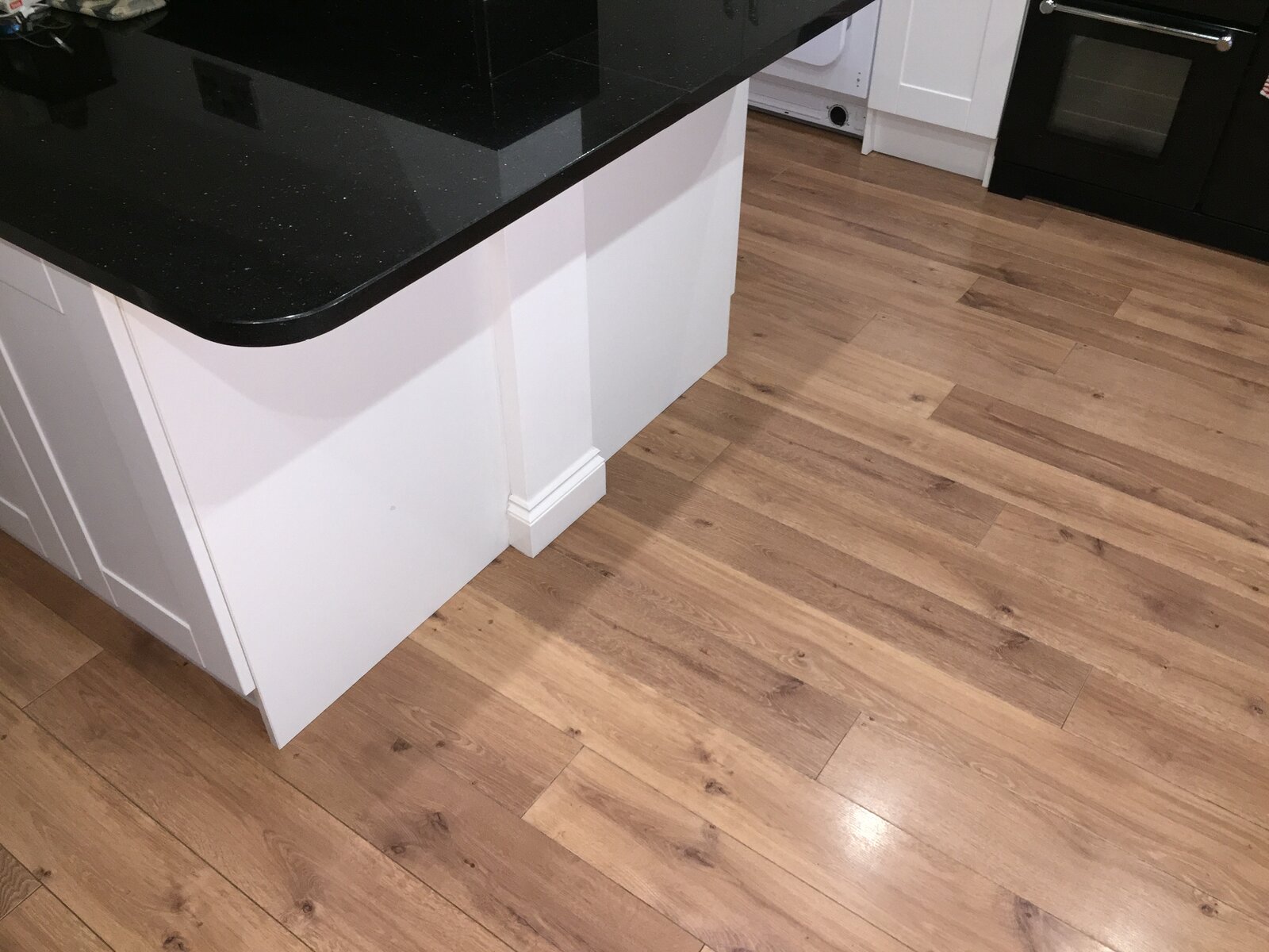

If anyone is interested or ever see’s this, yes it is possible to hang a radiator on an end panel, or at least good on ours.
Thanks for everyone’s help, only problem is i’m sure it’s too hot now but as i’ve been moaning for 3/4 years of how cold the kitchen is I refuse to turn the TRV down

Thats not too shoddy, hope the valves aren't sticking out past the units, guaranteed you or someone will trip overthem if they are.
Try turning the lockshield down a bit...
I was worried about the valves as I didn’t count them in on my original measurements but it’s near perfect, TRV end is fine but the lock shield end sticks out a few mm as I wanted a drain off.
