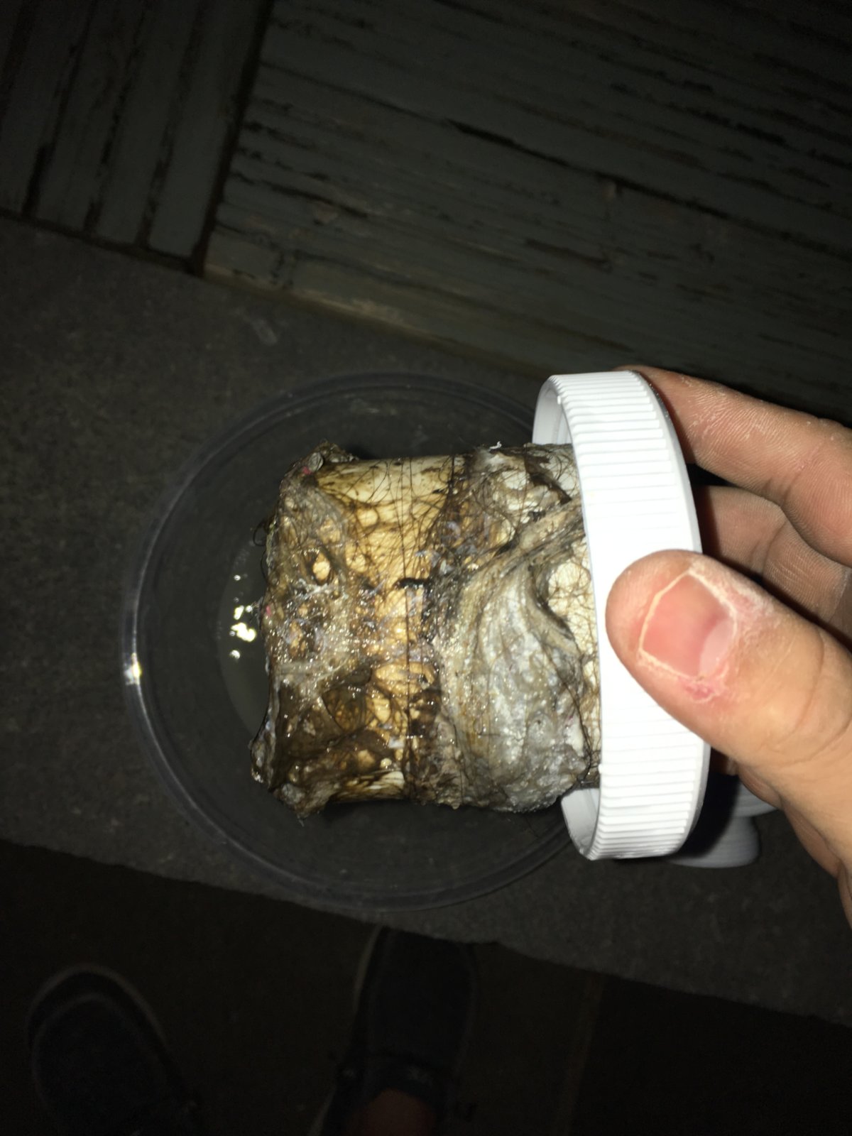

Here’s my old trap, I think I’ve found our why it was stupidly slow to drain.
Unfortunately my music taste requires me to have long hair (2ft+) so will invest in a better hair trap haha
