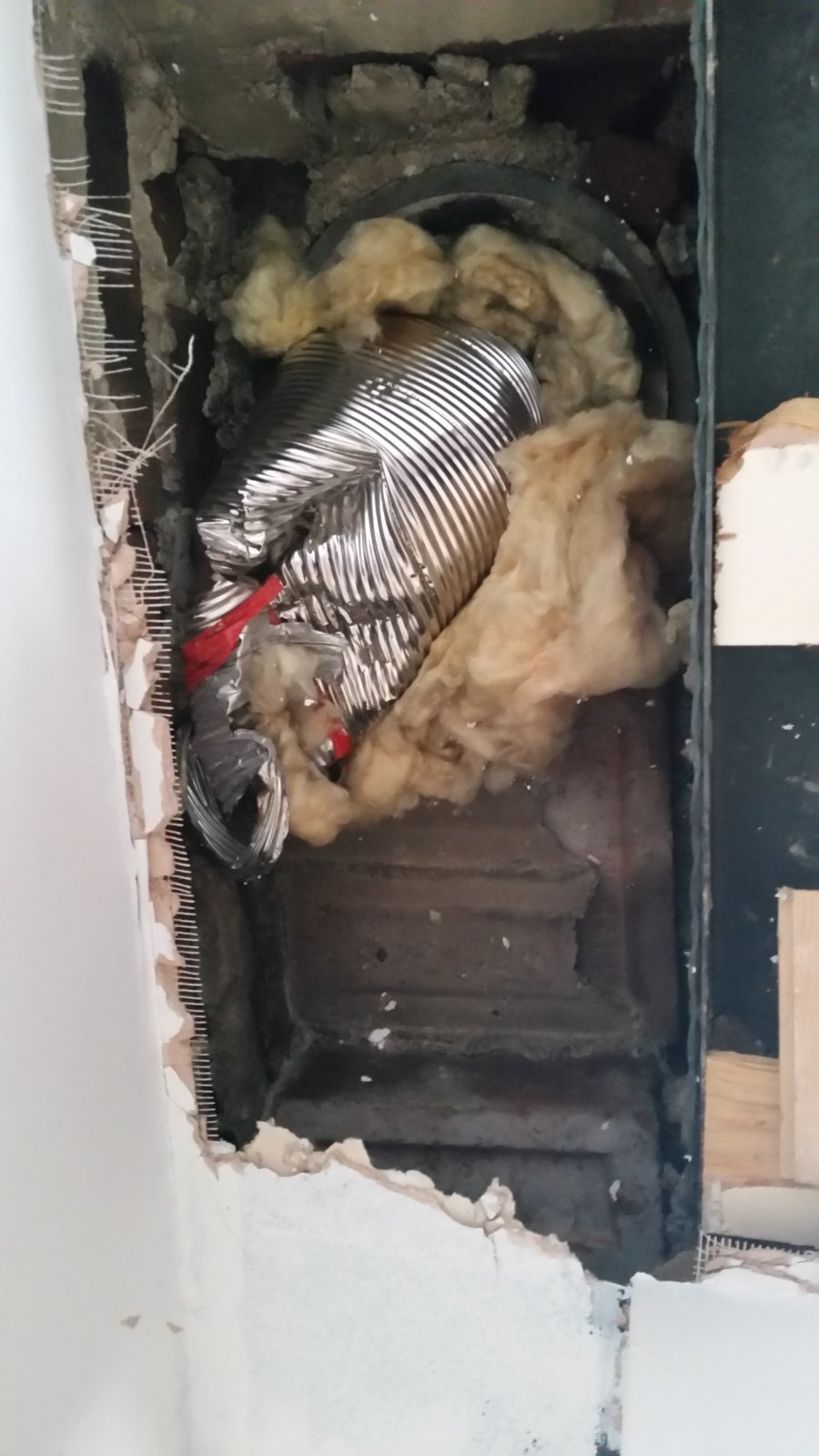

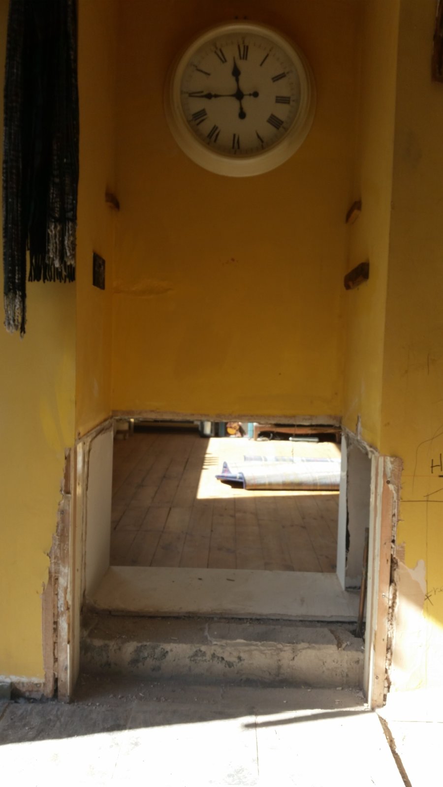

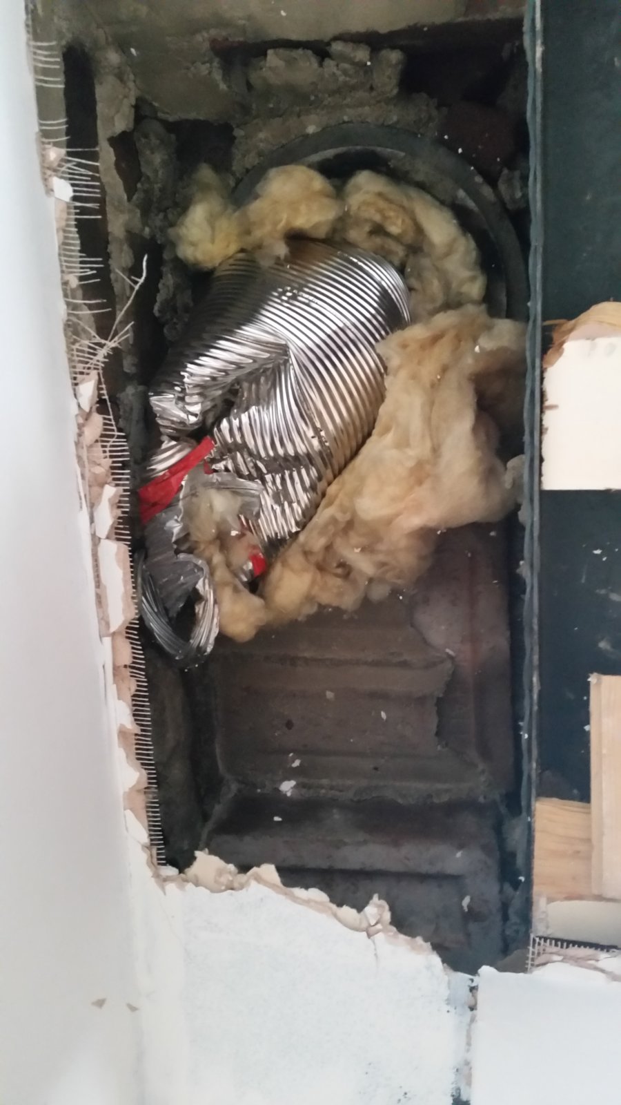

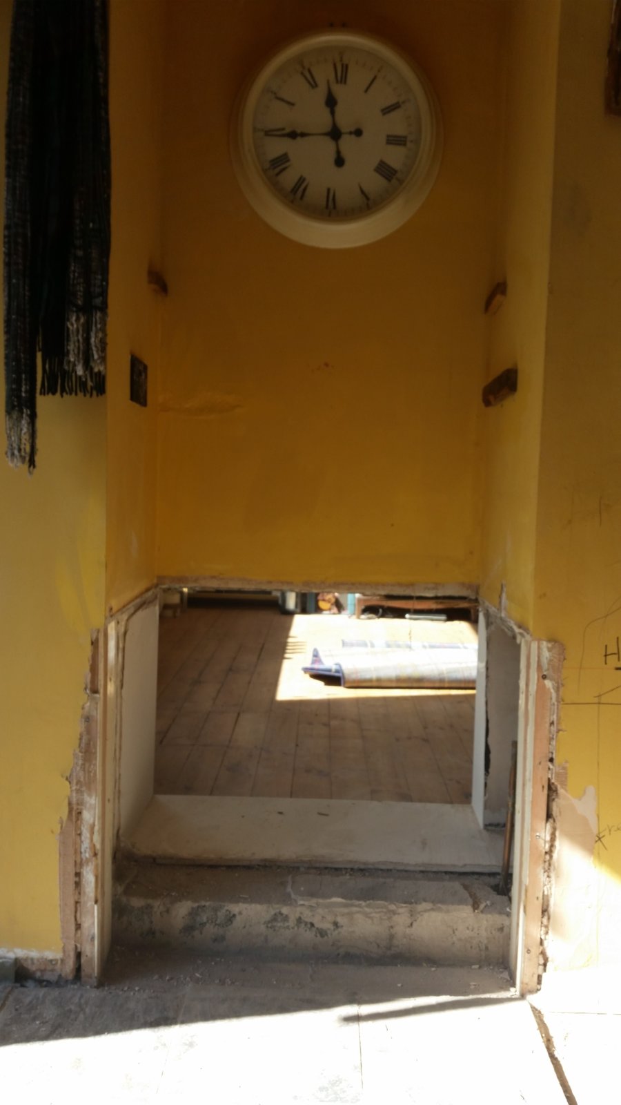

Here's knock thru for double sided a meter right is chimney can put flue in chimney customers too low so chimney needs cutting further up to allow bend and flow. Maybe better straight up with twin ?
