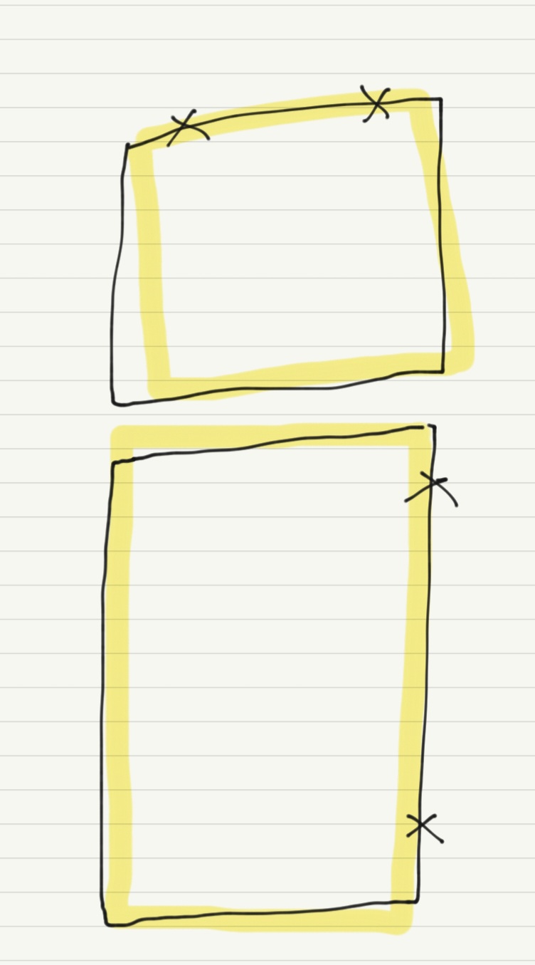

Yep that the sag we were all concerned about when not fitting jacking poles, the warp only shows up on the side windows as they're the ones being pulled out of shape, in terms of the side opener then the frame is being pulled down out of shape but the opener or sash is a seperate element so remains square hence it shows up, my crude diagram shows whats happening, the thin black line is the outer frame, the yellow denotes the side opener and top opener, the X denotes the hinges i.e side hung and top hung and is important when trying to understand why both openers are going in different directions, it is infact only the outer frame that is being pulled out of square, the openers remain square as they are seperate and only joined together by the hinges, effectively the frame is now a parellelogram and the opener within it remains a rectangle hence it shows up

Thank you so much for your reply! However the replacement frames were only fitted today! Before the fitted the frames I inspected them, and they all seemed square. Just as they fitted the frame, thats when its become out of square
Looks like this is the upstairs bay? Did they put jacking kits in upstairs? It's possible that it still needs jacking up and there's too much stress on the new frame ( pretty sure this is what Crank is saying too ). Either the frame has too much weight on it or it's too big and has been wedged in causing the bow

This is exactly what I was trying to demonstrate, the frame might be square when it's in the van but when you fit it into an opening that isn't square that's when you distort the frame

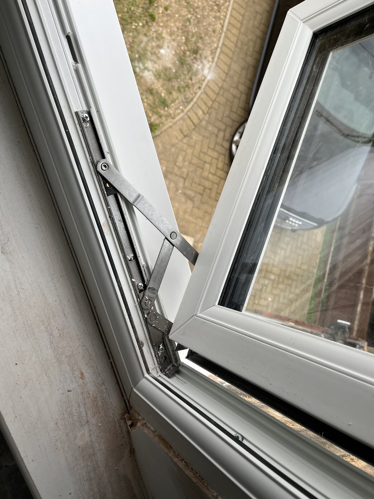

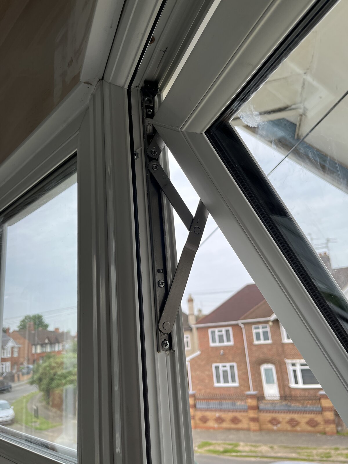

I put a laser line on the frame today. The right had side is bowed.
I have attached a couple of pictures
Casements all close and open fine.

From the first photos, it looks to me like the red packer at the top right should be about twice as thick.
If you loosen the fixing yourself it would be very awkward to as the company back after you have changed it, plus the expanding foam might be holding it in place.
That fact that the casements all close and open fine could be described a 'within tolerance' by some people depending on how high their standards are.
