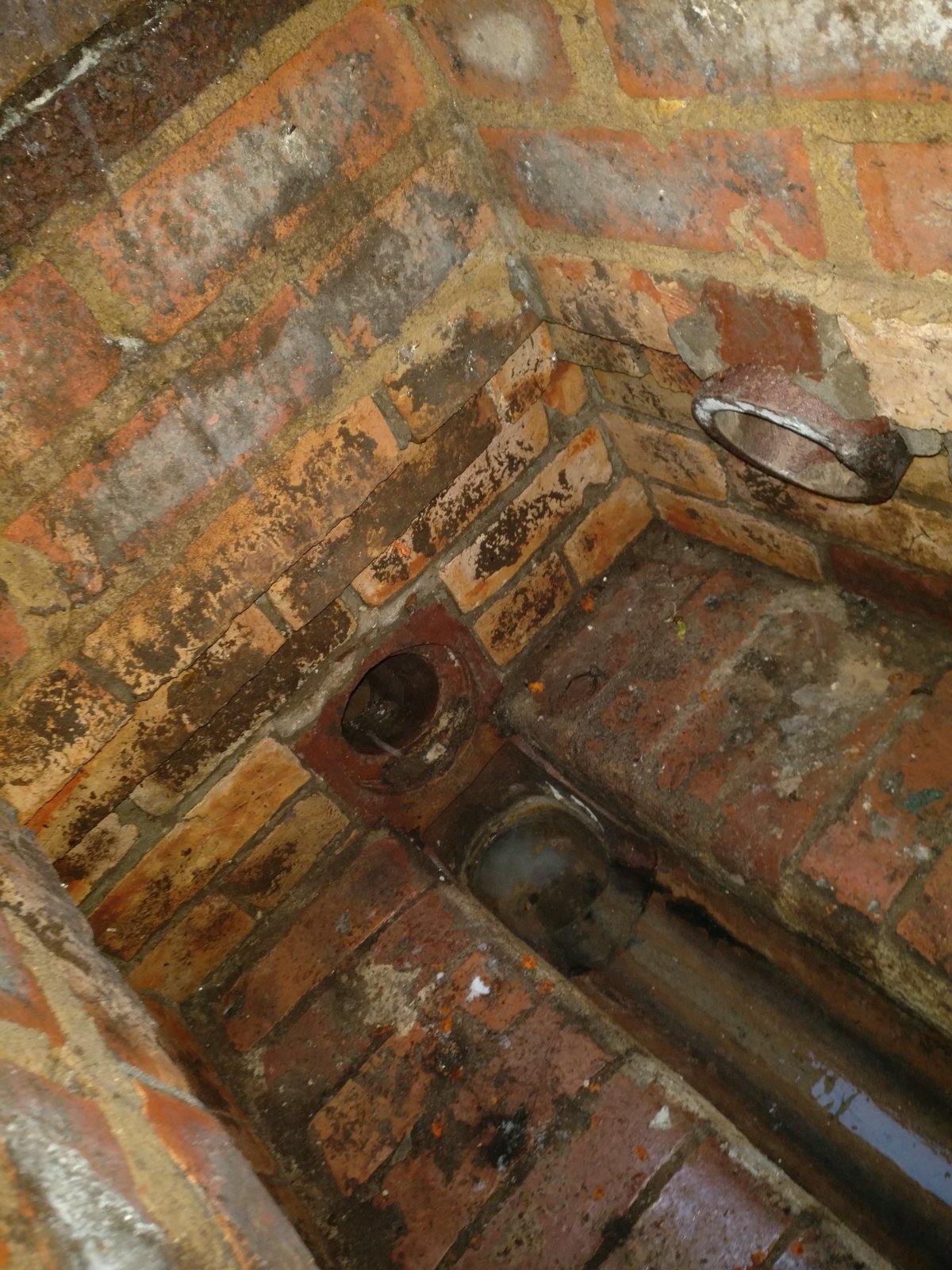

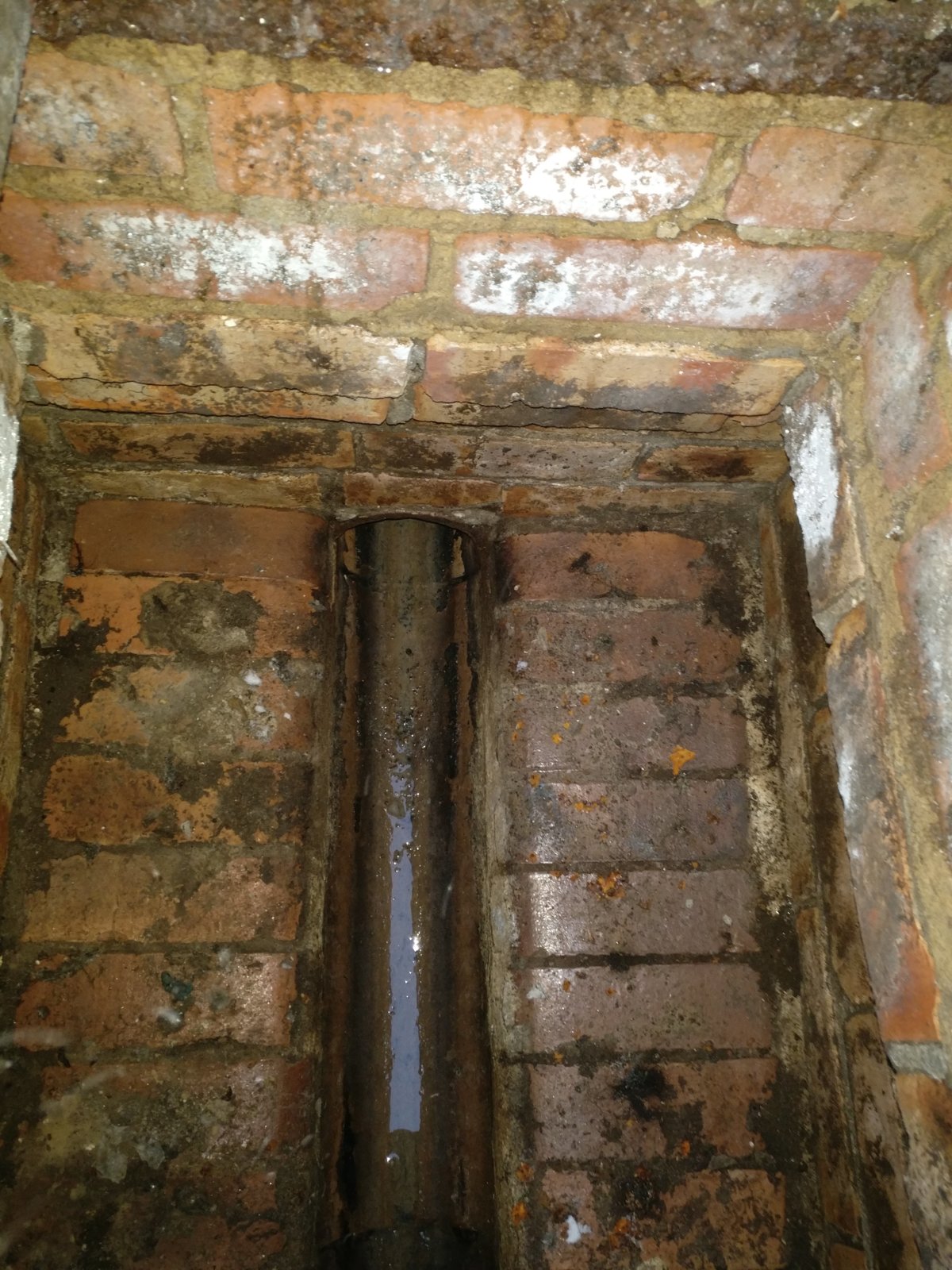

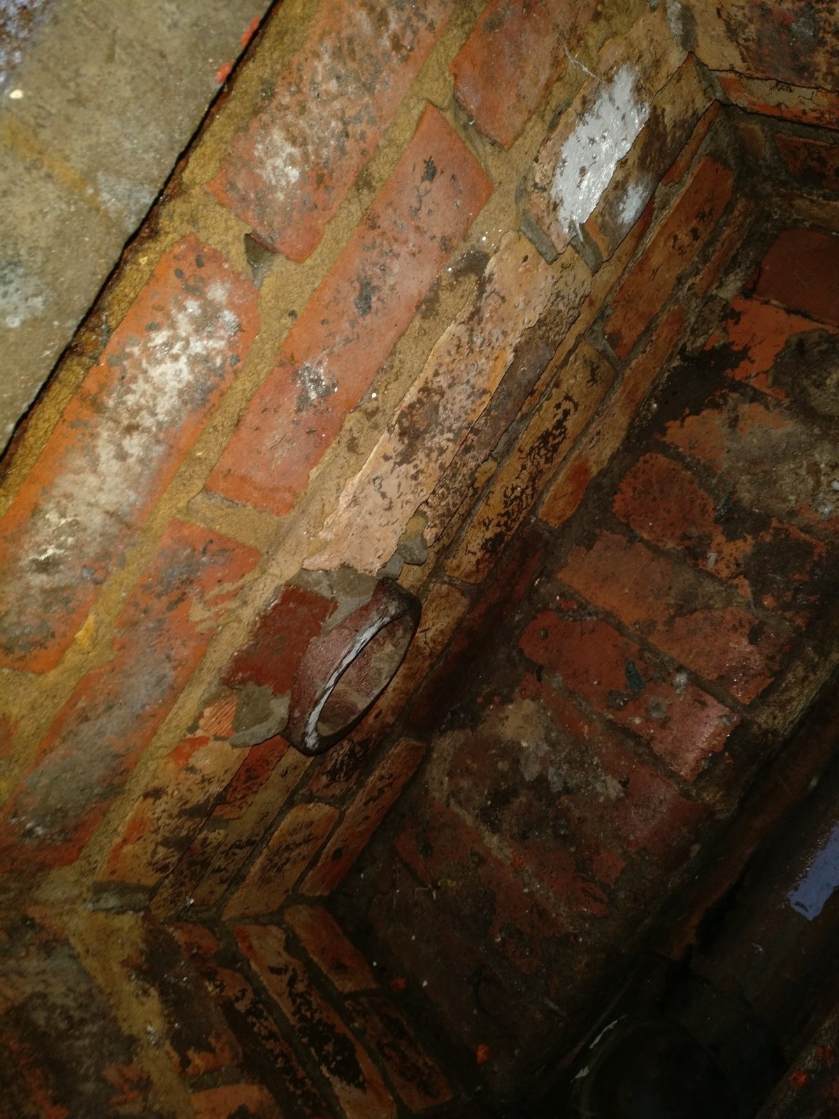

So it's 800mm from surface to bottom of channel in inspection chamber. Took some more photos. Pipe leading in near the top at the side is on the right hand side standing with my back to the house so you must be right about it going to a vent Newboy? Drop pipe and pipe just above it at the end are at downstream end of inspection chamber furthest away from house. If I were to run diagonally under garden from the corner of the house to the inspection chamber how would I tie in? Would I just dig to outside wall of chamber then knock out brick, insert pipe then cement in/around it?

You could leave the existing channel in and sit you new pipe ontop of it at a 45degrees angle. Your turds would drop into the channel and away through the trap.
The wall of the manhole should be 2 bricks thick so it will be awkward to break into but doable.
No - the new lateral needs to sweep into the main channel. Given the (good) construction of the existing chamber and the need to break into the channel close to the trap I'd leave it well alone - it's not really a DIY job.
Plenty of depth so not an issue. If you're going to DIY it then come through the house wall into a tee with an access cap on the top connection, drop into a long radius/rest bend, to the corner of the house, 45°, locate the main channel between the house and install a pre-made 450 mm chamber with riser rings to suit. Lay at 1/40 from the base of the rest bend to the new IC.

Great, comprehensive advice Newboy and thanks for input too Ian, pretty confident of everything up to last connection into existing pipe which I may still get a ground worker I know to sort for me or at least assist. Thanks!
