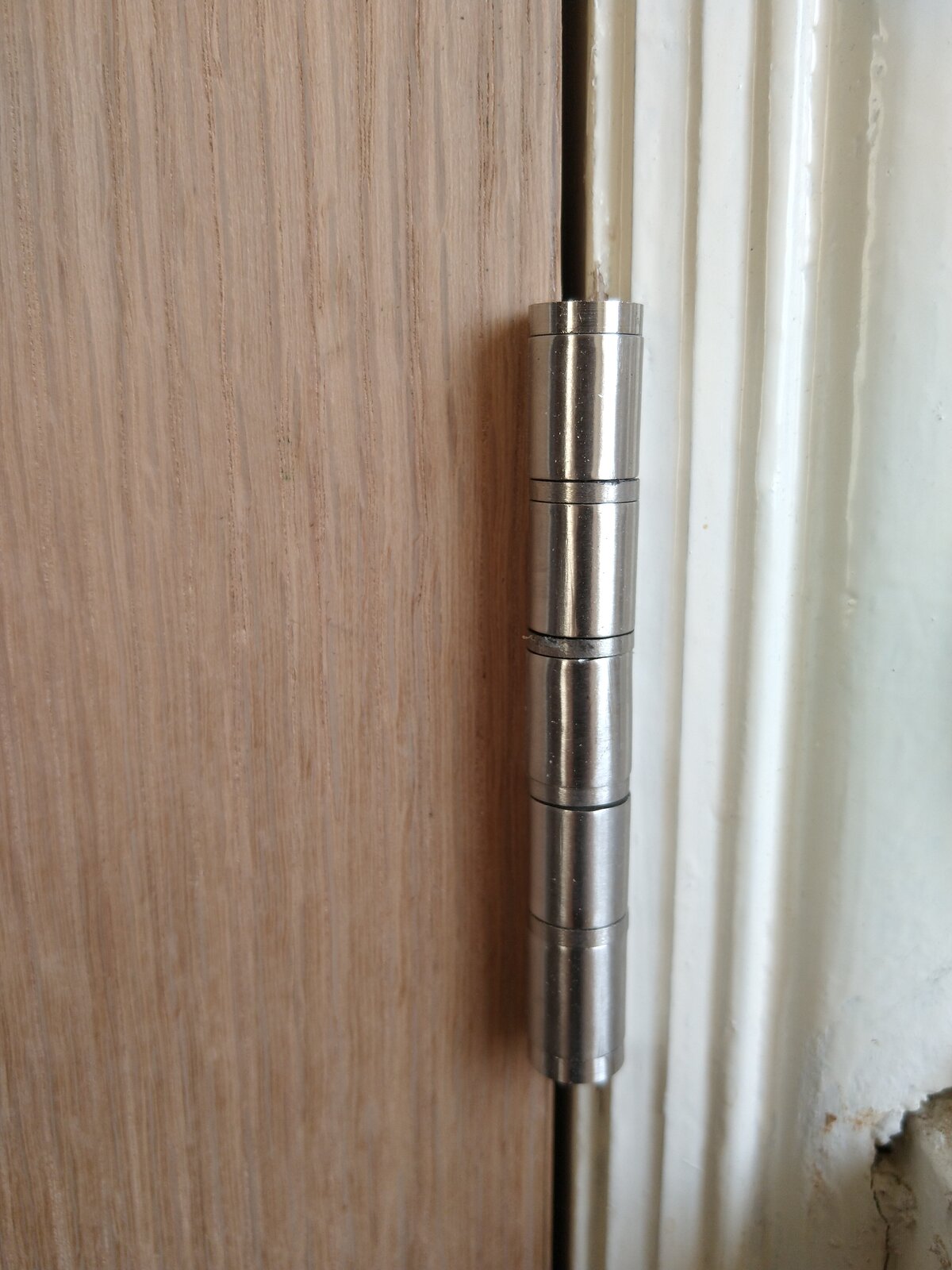

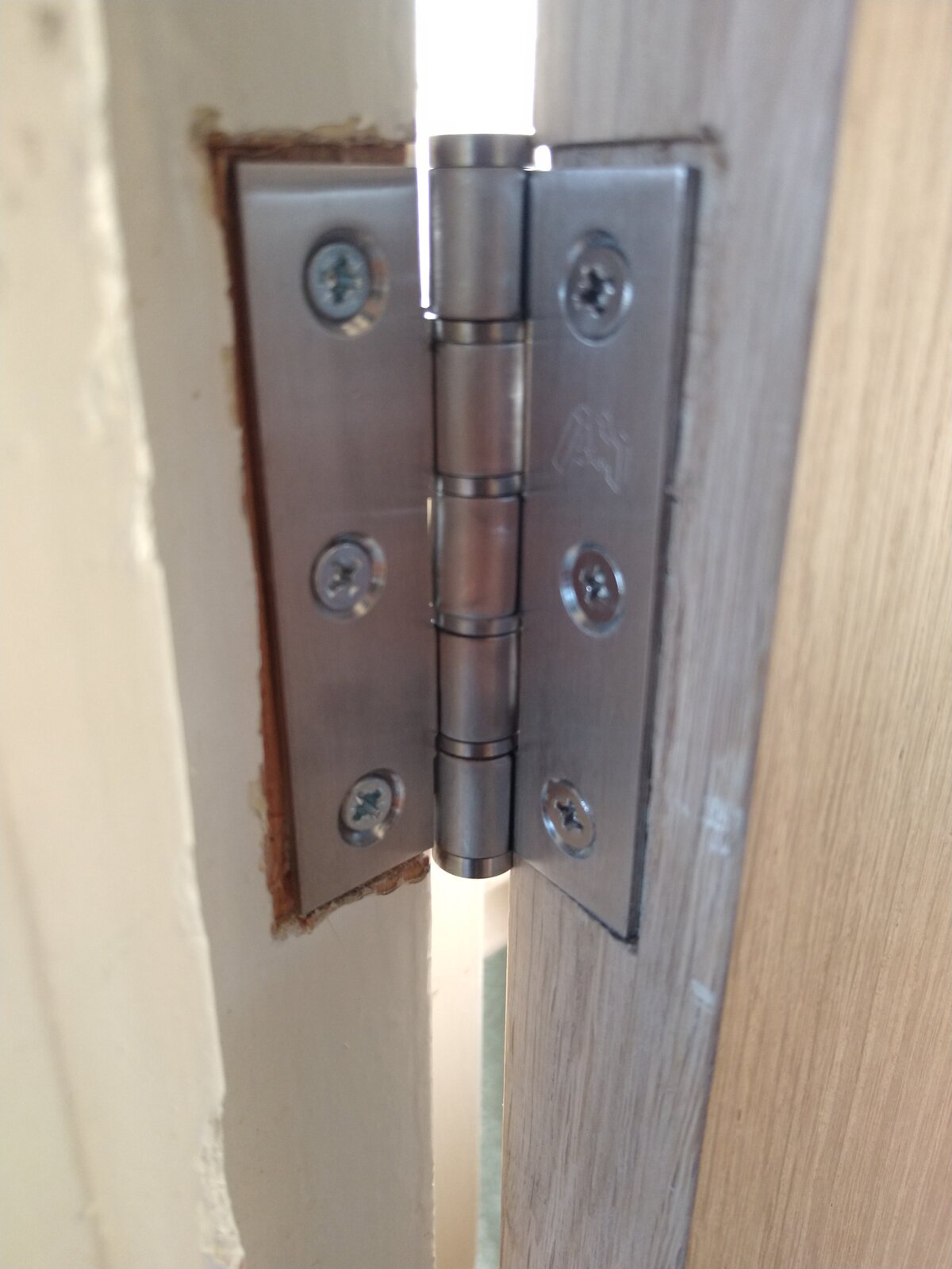

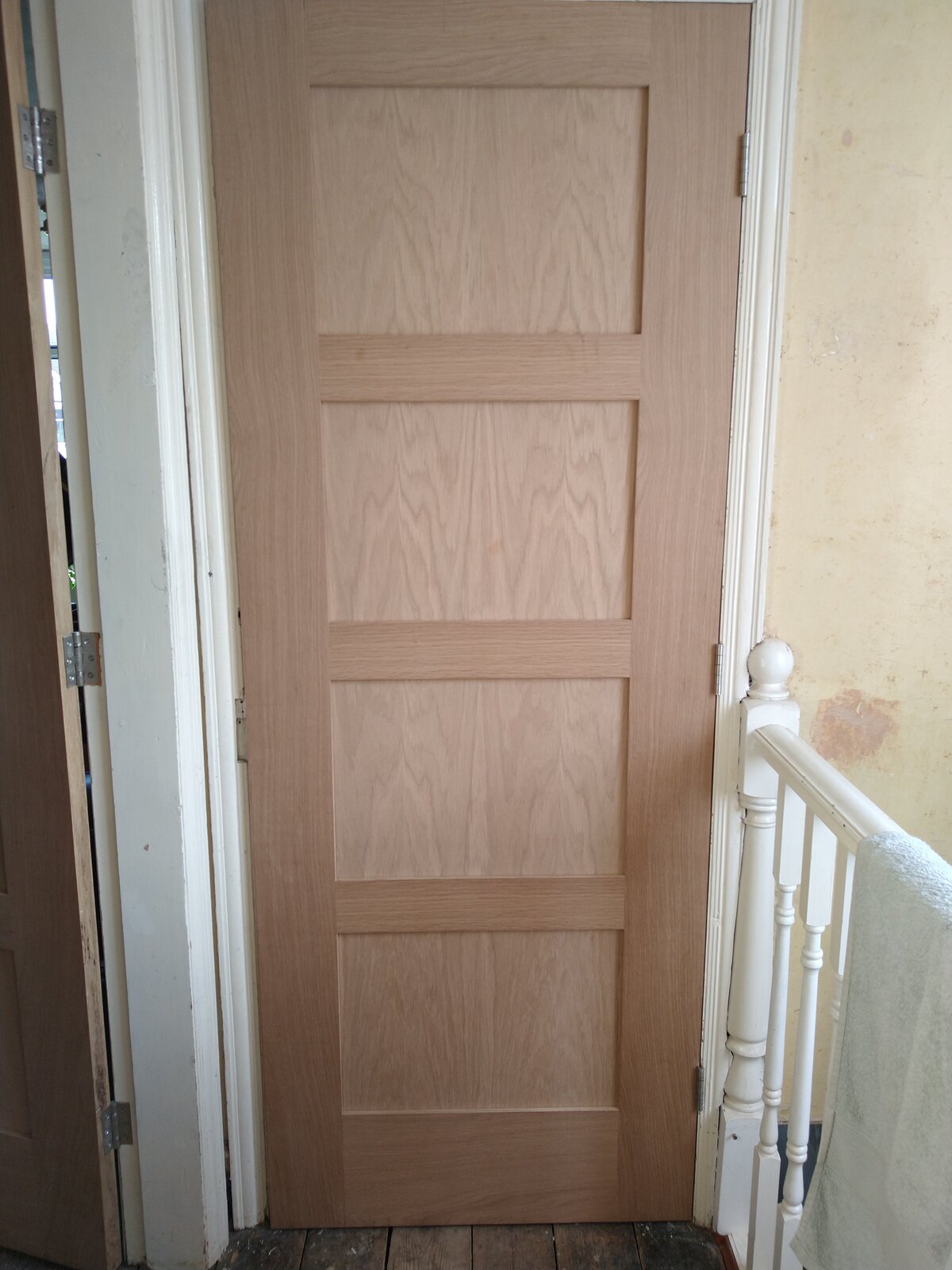

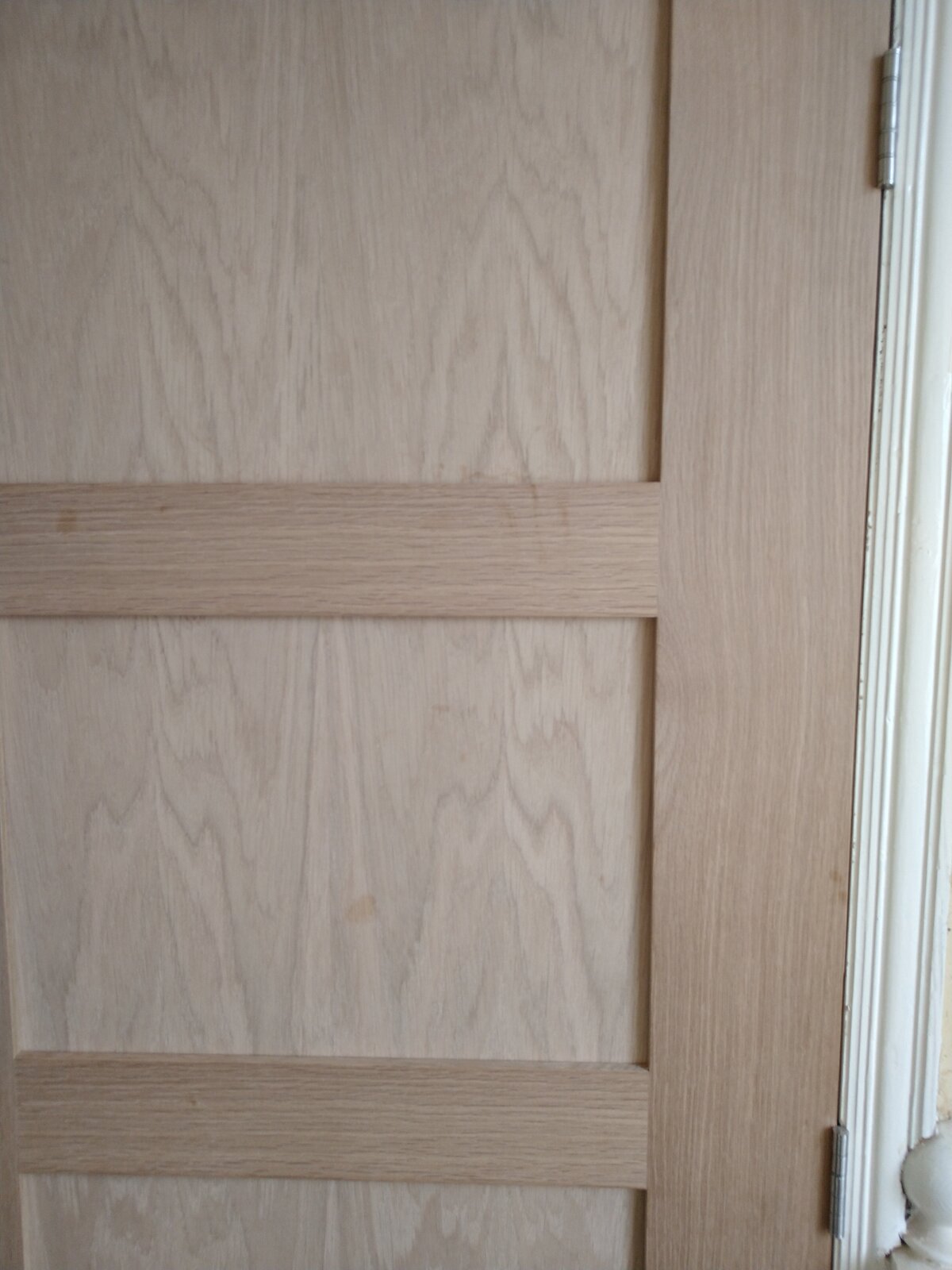

Hi,
I've just hung 4 new internal doors. 2 of them seem a little difficult to close just the very last bit...I mean they close fine 97% of the way then that last 3% they get a little tough. If I close them all the way they spring back the 3% so they sit slightly ajar.
I can't see anywhere they are binding and there's a nice gap all the way round. I'm wondering if its something to do with the hinges placement but can't think what!
Can anyone suggest what I've done wrong?
many thanks

Any chance of a pic of the door open and shut , and of the hinges open and shut?
It could be something as simple as the screws for the hinges are slightly high and catching the other side of the hinge, something as you know you can't see when the door is shut

As you haven't put a bevel on I'm gonna go out on a limb and say the hinges are too close together , certainly the one in your pic isn't flush with the door edge

I mean when they fold together when you close the doors the two sides of the hinge come together and touch , its why you bevel the door edge to take out any inaccuracies in the right angle of the door lining on the hinge side so they the two leaves of the hinge or screws won't touch
With the door fully closed you might be able to look up and down the hinges to see if the two leaves touch

first check is to make sure the hinge leaves are fully in the casing and door side. They should by level with surrounding timber certainly at the pin side. If the hinge is binding or screw heads are causing binding you may deepen the hinge recess slightly at the side away from the pin.

So after removing the door half a dozen times it turns out sircerebus666 was right..oops sorry :giggle: There was a very slight bevel on just 6cm of door near the bottom hinge. Only spotted after shining a torch round the door when closed.
Appreciate the help, lesson learnt, turns out the first answer is almost always right!
