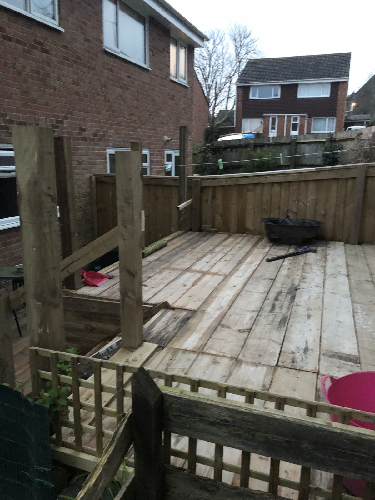

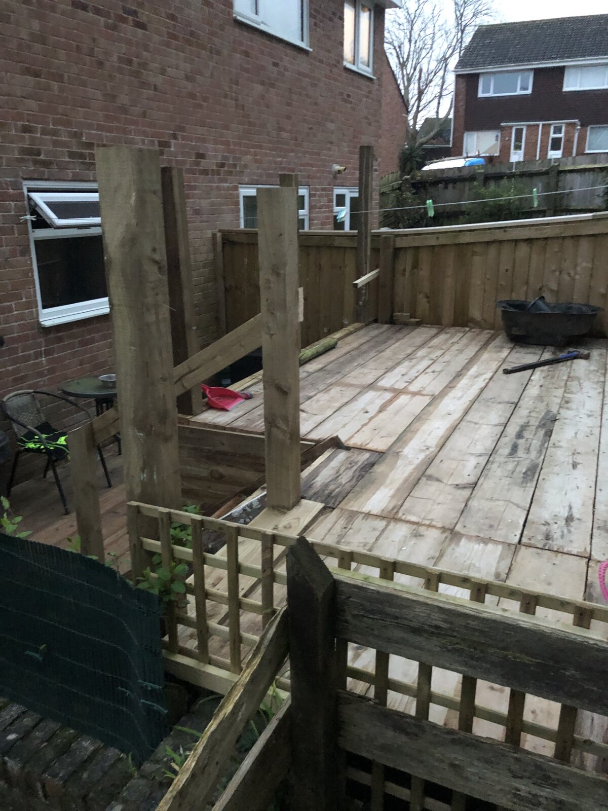

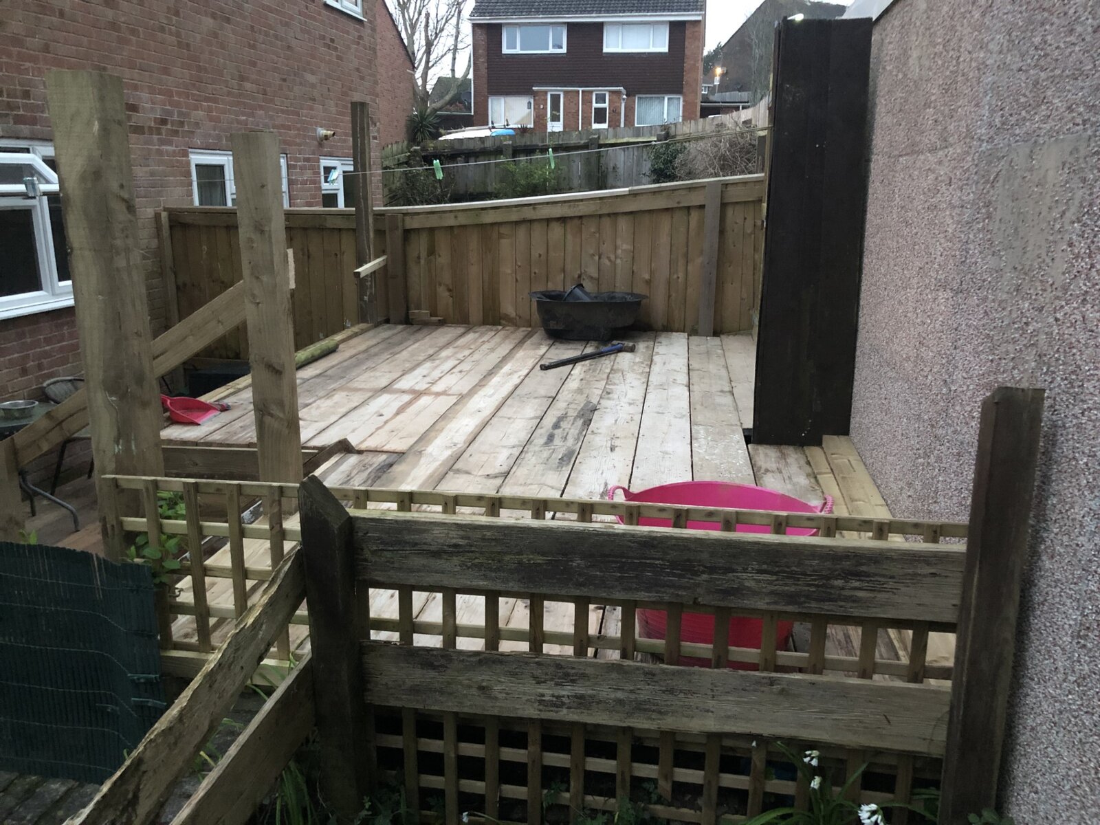

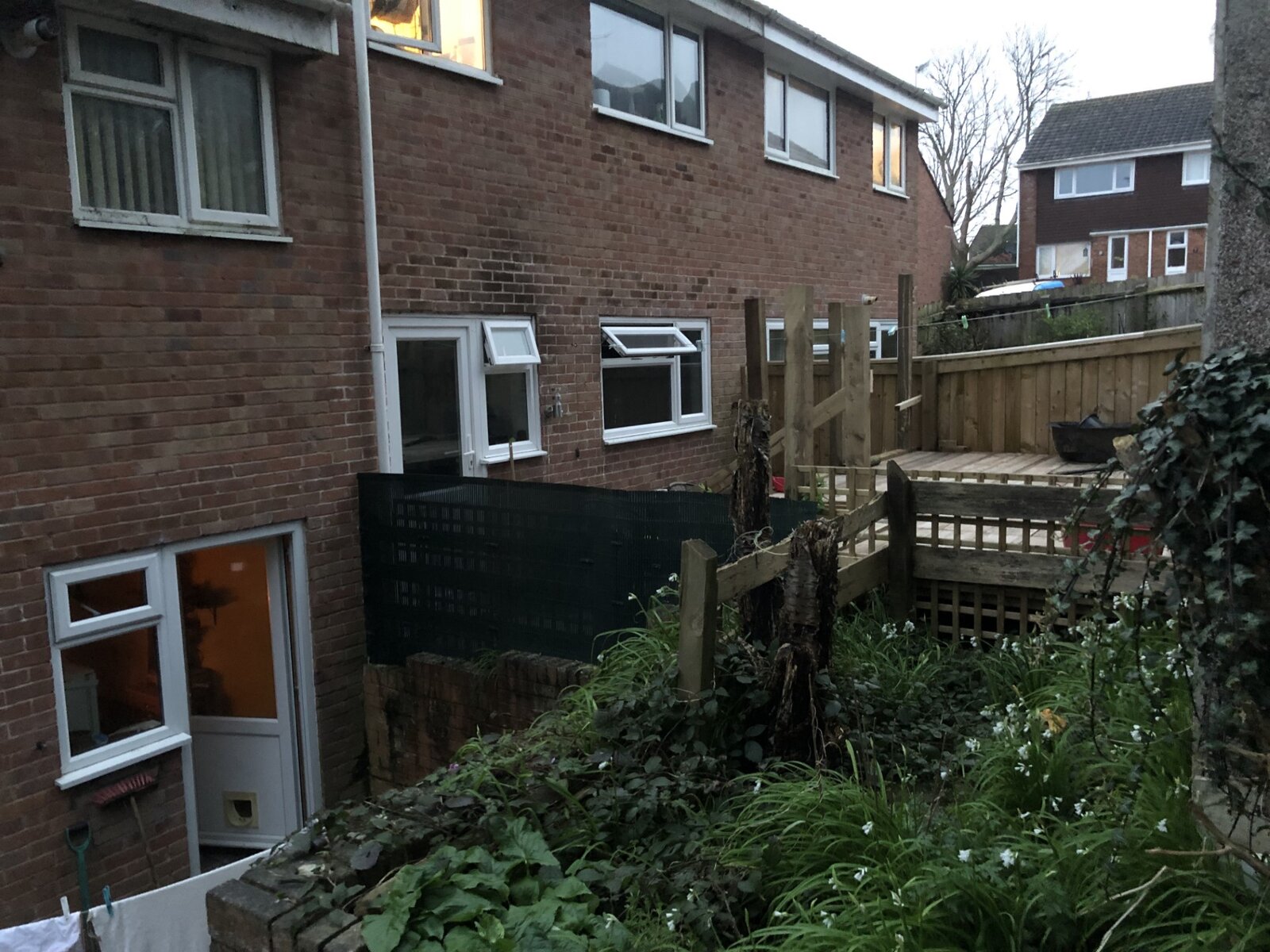

Hello DIY'ers and fellow victims of DIY'ers. My neighbours have built this decking area in the last two weeks . It appears to be higher than allowed. I am in the flat to the left of the photo. I've reported it to the council...still waiting to hear back.
Can anyone please tell me if this contravenes planning law?
at a guess, about 3 feet at least - it's level with the top of the table on the patio - or even higher
Thank you. I was just about to edit my post. It's actually about 6 feet high at the top part. It appears to be over 50% of the garden too
You're not answering the question, to be permitted, that is not requiring planning permission, it can be no higher than 300mm above the highest bit of ground anywhere beneath it? The 50% rule also includes area from any front garden too.

can we try a different tack here to get an answer
iff you go up your garden to the furthest away from the house point and drop a tape down there side on the back edge off the decking to the top off the fence discreetly do the same your side and the difference should give you a rough idea off actual difference
iff near to and just above 300mm you need more accurate measurements and take more note off deviation in height side to side as well as back to front?
ok looking again at the photos your house/flat seems to be stepped down about 3ft so my idea above is not applicable
