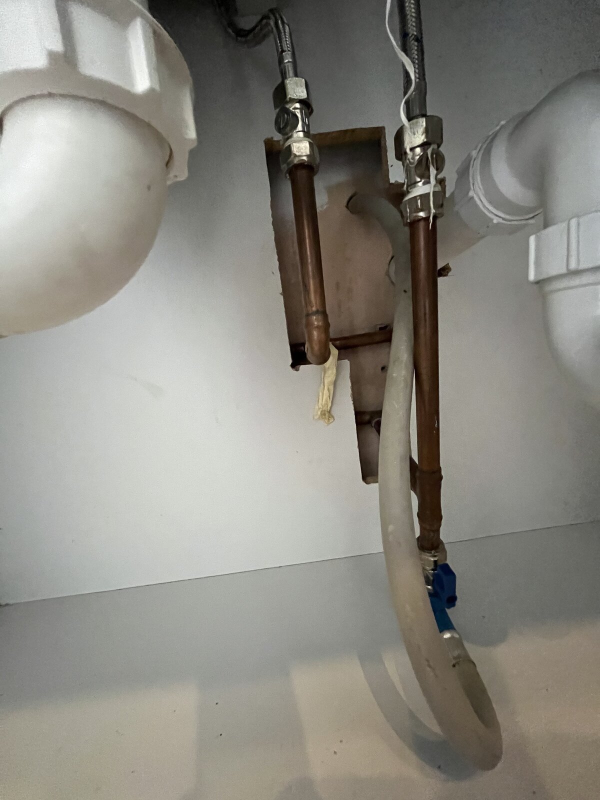

Afternoon all,
I’ve recently completed on a house, and currently have no cold water coming out of the mixer tap downstairs. The stopcock was shut so I've opened it and the boiler and hot water are functioning properly, and we have cold water upstairs in the bathroom.
I've checked the separate valve on the mixer tap in the image trying both the on and off positions, but it hasn't resolved the problem. I'm completely puzzled as to why there's no cold water downstairs.

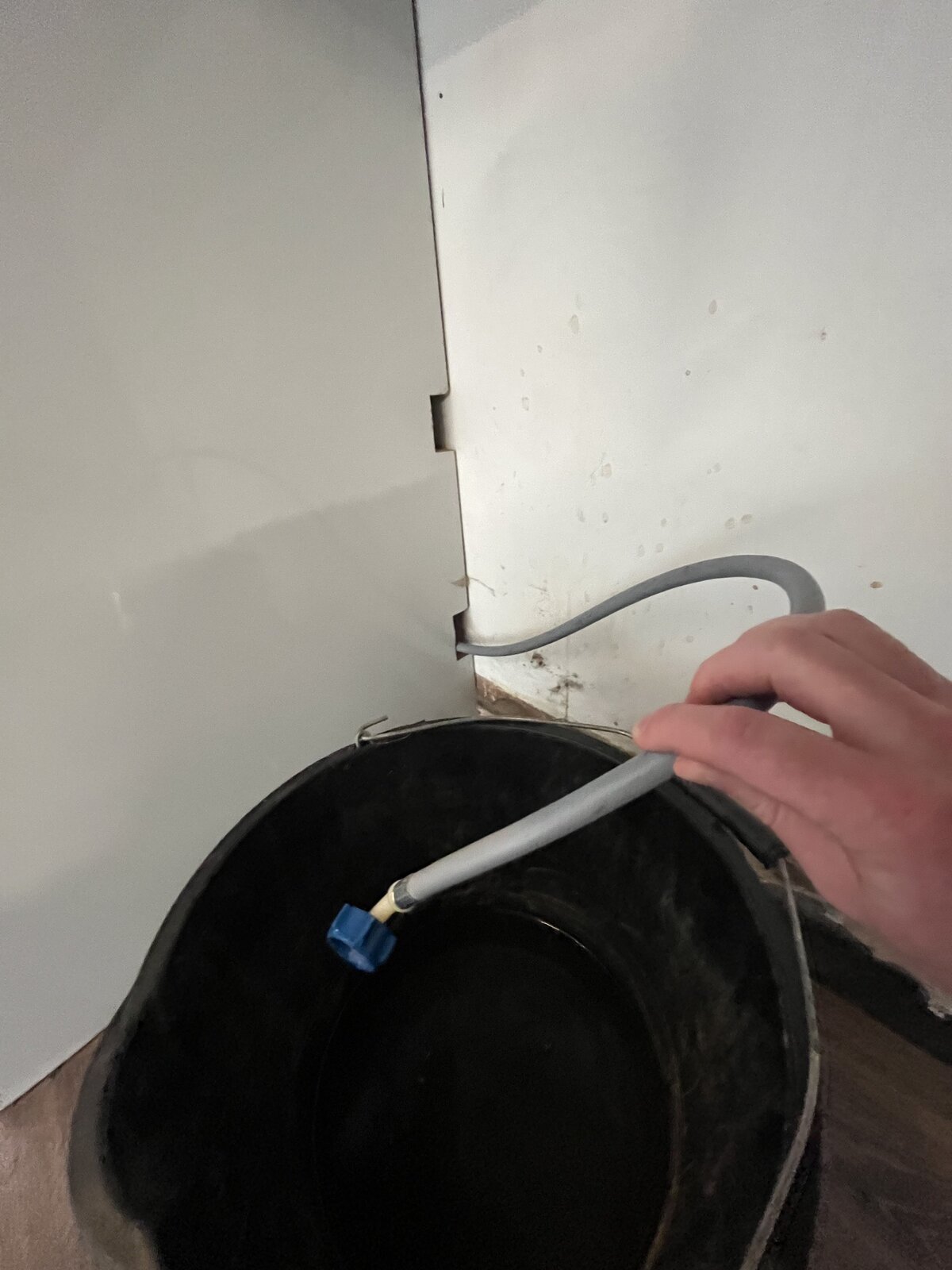

Also to describe the images it looks like the grey piping leads outside to the cold water tap, then the other grey piping that is in the bucket (washing machine I'd assume) is connected to something we can't see but when running the tap seems to be coming out with water (lukewarm).
If anyone has experienced a similar issue or has any suggestions on what might be causing this that would be great.

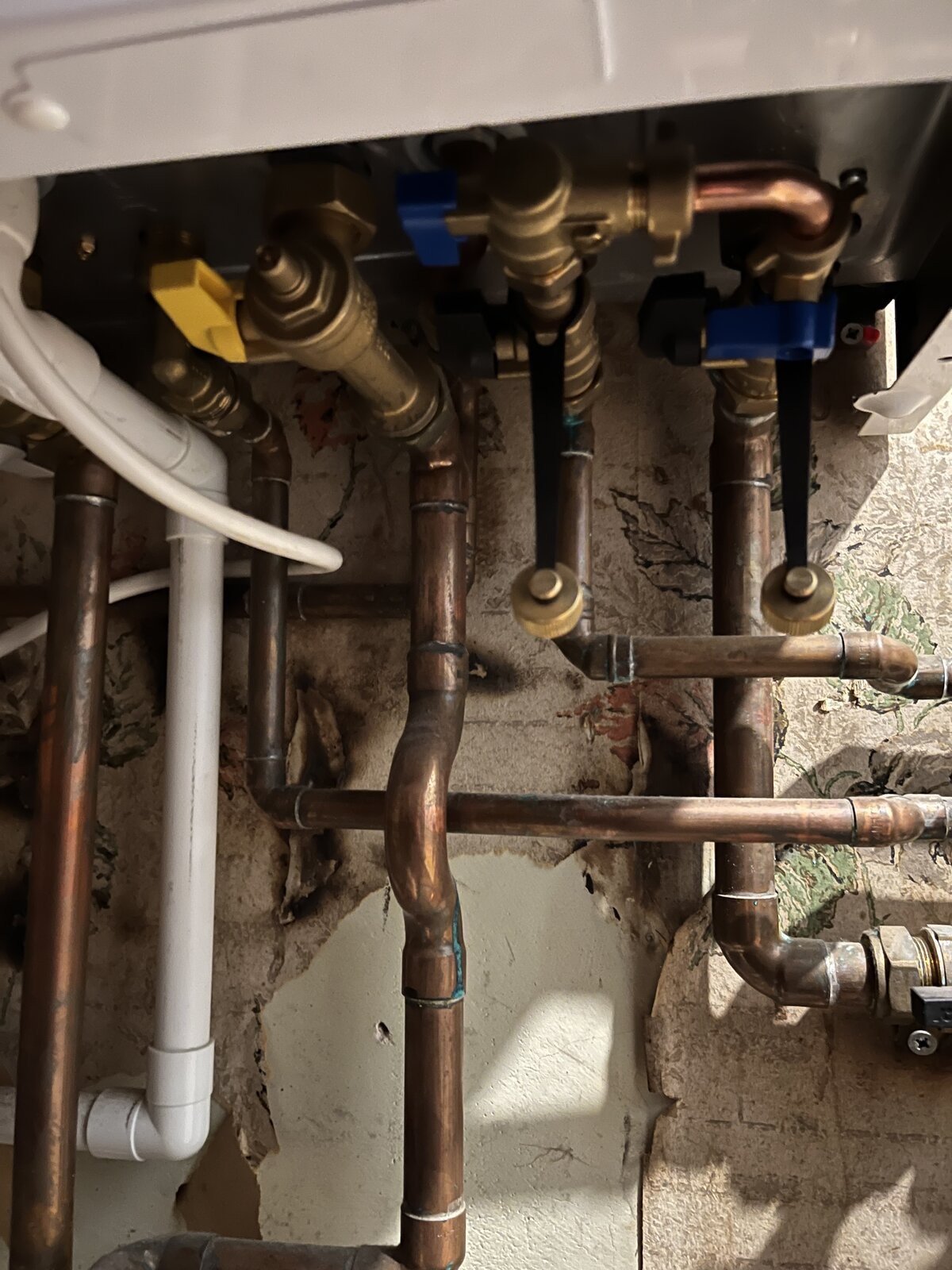

So it’s a Potterton Assure Combi. The only other thing I can see is the blue valve and piping under the boiler which seems to match the instructions

Ok, you have a combi and it's obviously getting mains cold water supplied to it, as you get hot water. You mentioned there is an outside tap ,on the other side of the wall in your pic ,does water flow from it ?
Any isolation valve/ stopcock that supplies the kitchen tap is more likely to be nearer to it ,rather than around the boiler.

Also don’t know if it helps but when I run the mixer tap not on it’s complete coldest, water starts coming out into the bucket. But as the picture shows I can’t see where that plastic piping is connected too, but I would have thought that should just be cold water coming out.
Is there a plinth below the cabinet that holds the sink ,that you could remove to check behind. It's odd that you can't see or access the washing machines hoses connection to the supply pipework ,and would suggest to me that the previous owner has isolated the cold supply to enable their machine to be removed.
I obviously don't know the layout in your property but I am convinced their is an internal isolation valve ,and probably close to the sink.

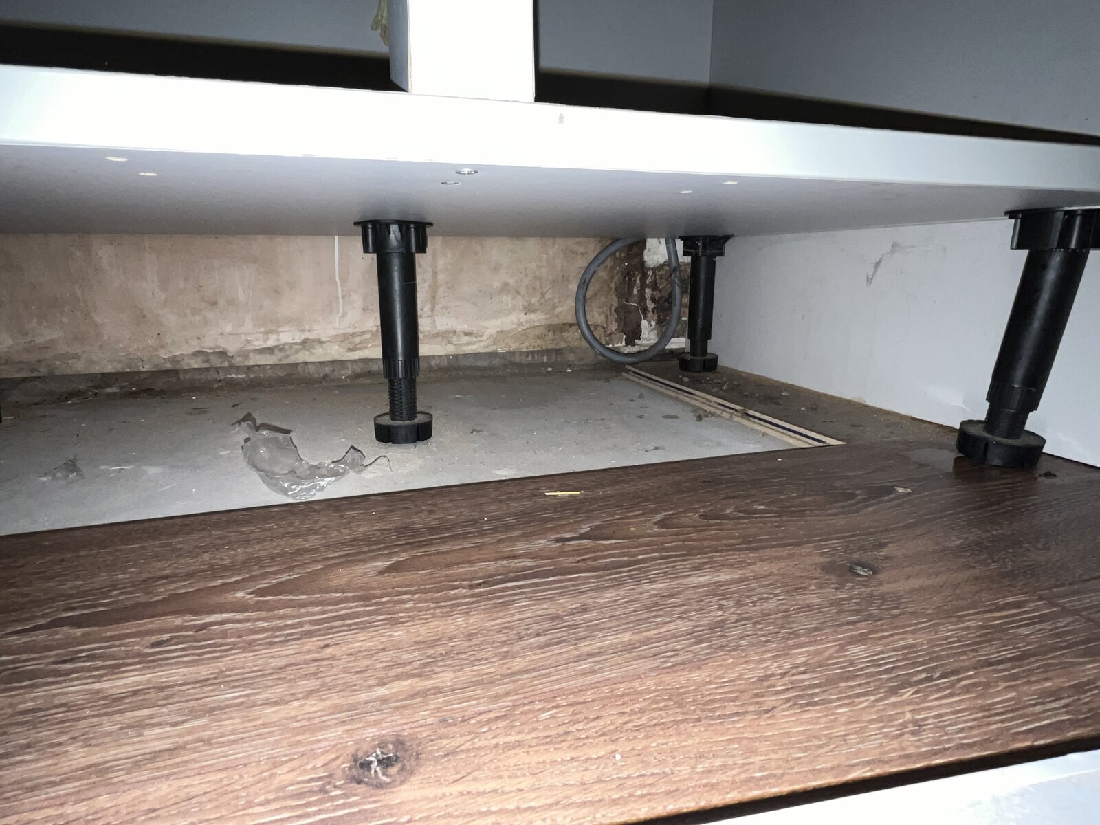

Managed to pop the plinth off
No joy of anything underneath. And it’s odd to me then that it would be behind the back of the cupboard (where you can’t access) as surely he would have had to cut more out to be able to isolate if there is another isolation valve.

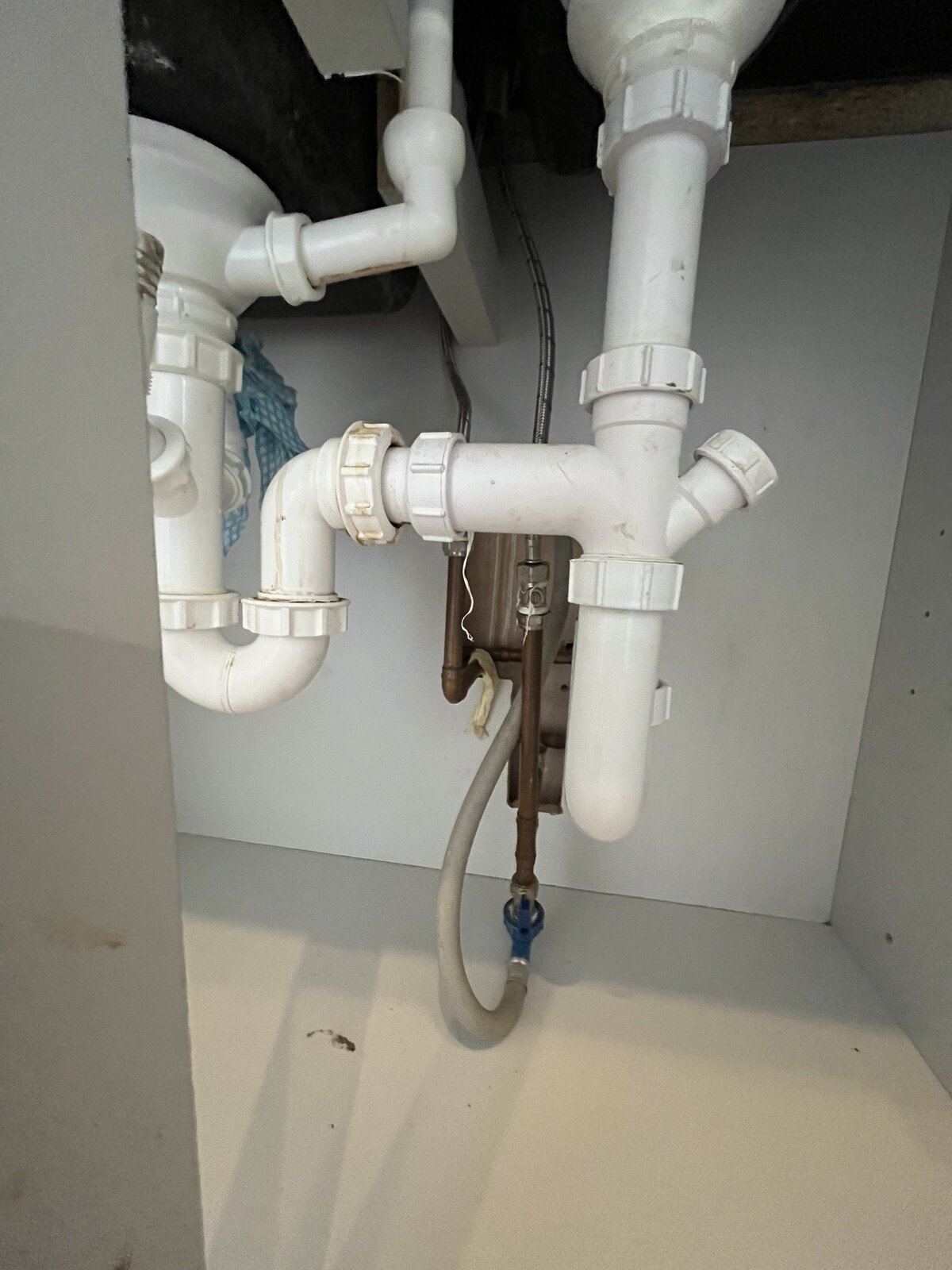

It seems that the only access is the hole in the back of the cabinet in your original pic of under the sink.
Can you get your camera in there to take picks ,left,right,up an down ?
